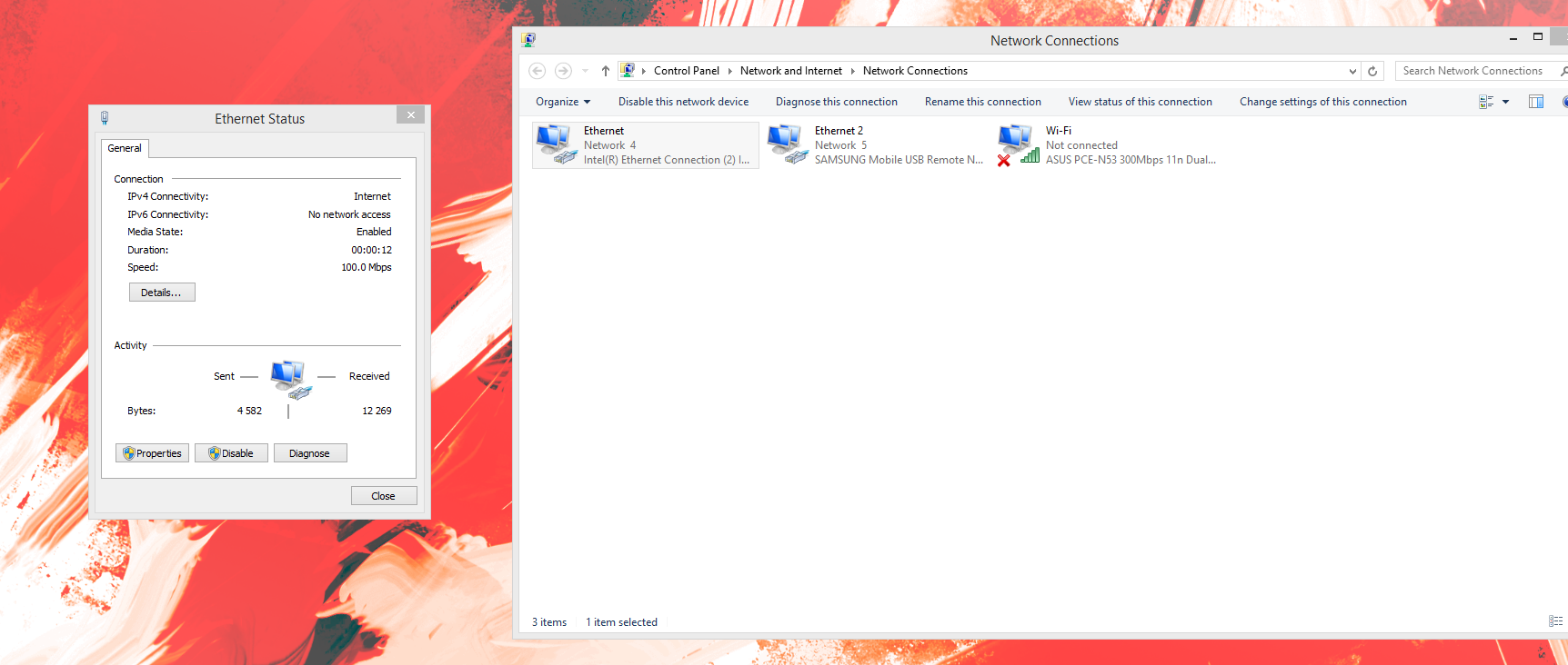

What speeds are the ports on the router? The laptop and desktop?

Go check what it says here:
https://linustechtips.com/topic/542304-cat5e-speed-help/#findComment-7177253
~SNIP~
Yea it says 100.0 Mbps on both Desktop and Laptop. But why is the transfer rate just 5 MB/s? It even goes down to 3 MB/s:(

https://linustechtips.com/topic/542304-cat5e-speed-help/#findComment-7177265
Yea it should be like 12MB/s
Something is wrong.
