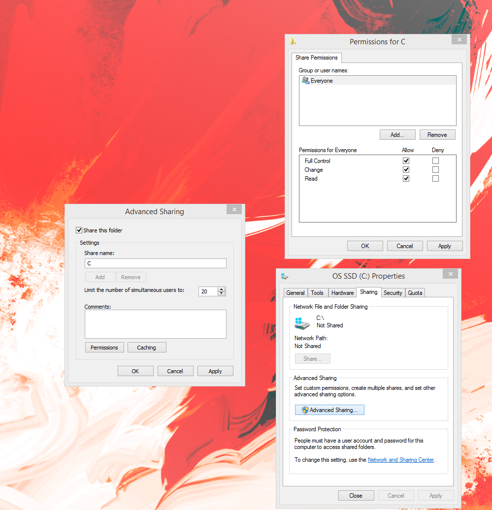

Do you have it like this?
https://linustechtips.com/topic/542288-need-help-lan-connection/#findComment-7177093

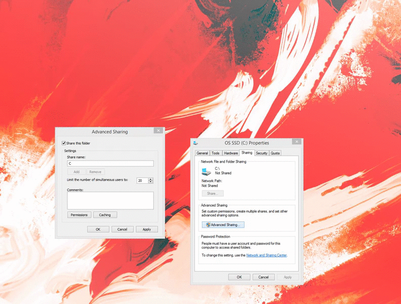

Yea exactly like that except the limit users are set to just 2.
CPU: Ryzen 7 5800X | MOBO: Gigabyte B550 Vision D | RAM: Crucial Ballistix RGB 32GB 3600MHz | GPU: Gigabyte RTX 3070 Vision D | PSU: Seasonic Focus+ Gold 750W
https://linustechtips.com/topic/542288-need-help-lan-connection/#findComment-7177109
1 minute ago, koji said:
They are on same workgroup. Basically they are already communicating. If I open warcraft on my PC and laptop, they can play together with LAN.
Here's what I get when I try to access C: or D:
In the above image by @Samppa221. Have you went into the Permissions button and set the everyone group to "full control" ? (this is far from best practice but it will work as long as you turn it off after you are done).

https://linustechtips.com/topic/542288-need-help-lan-connection/#findComment-7177110
Yes it's set to full control? Why is there a security risk if I leave it like that? Sorry kinda newbie.
