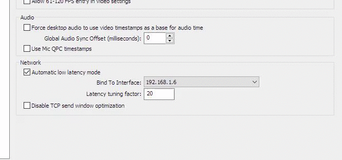

You could buy a 2nd nic and connect it to another connection and in obs's setting set it to use the 2nd nic: 737fcd052144495e3feac926bb32d2bc.gif

Look what this guy told met o do  -
There's two ways to do this:
  1. Two LANs - This seems like what you're thinking of doing. The only way to move traffic on one LAN versus another would be with static routes on your computer. I don't recommend doing this.
  2. Policy based routing - The TP Link TL-R480T+ that you're looking at will support this. How I would do it is with the Policy Routing section of the Load Balance menu. Set All traffic with a destination port of 1935 (RTMP port for Twitch - assuming that's what you're streaming on) to go out WAN2, and all traffic to go out WAN1.
Your latency is probably going high because your streaming is maxing out your upload. If your ISP offers any packages with higher upload it may save you from this complexity. Or you could lower your OBS bitrate.
https://linustechtips.com/topic/467002-load-balance-router/#findComment-6265828
