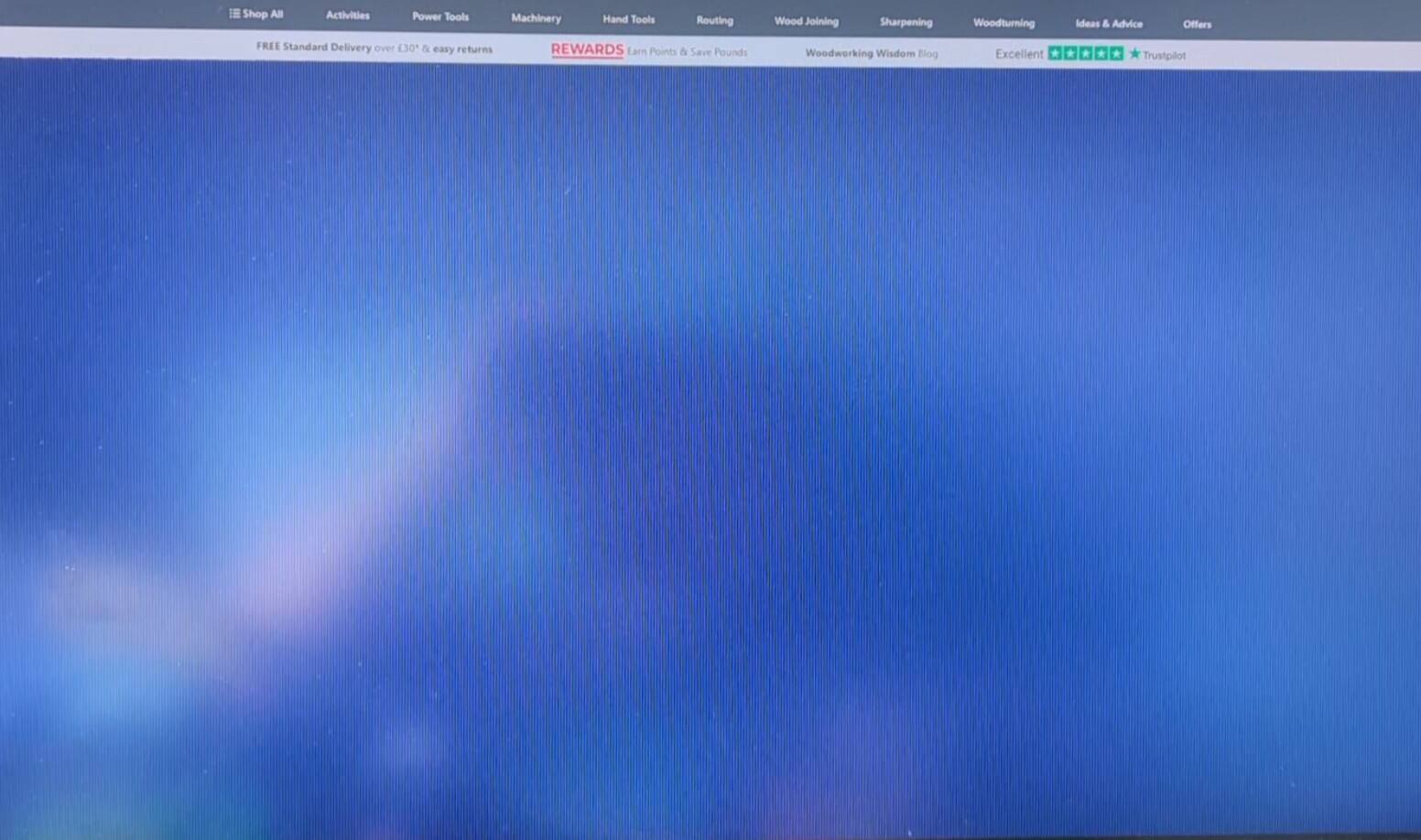

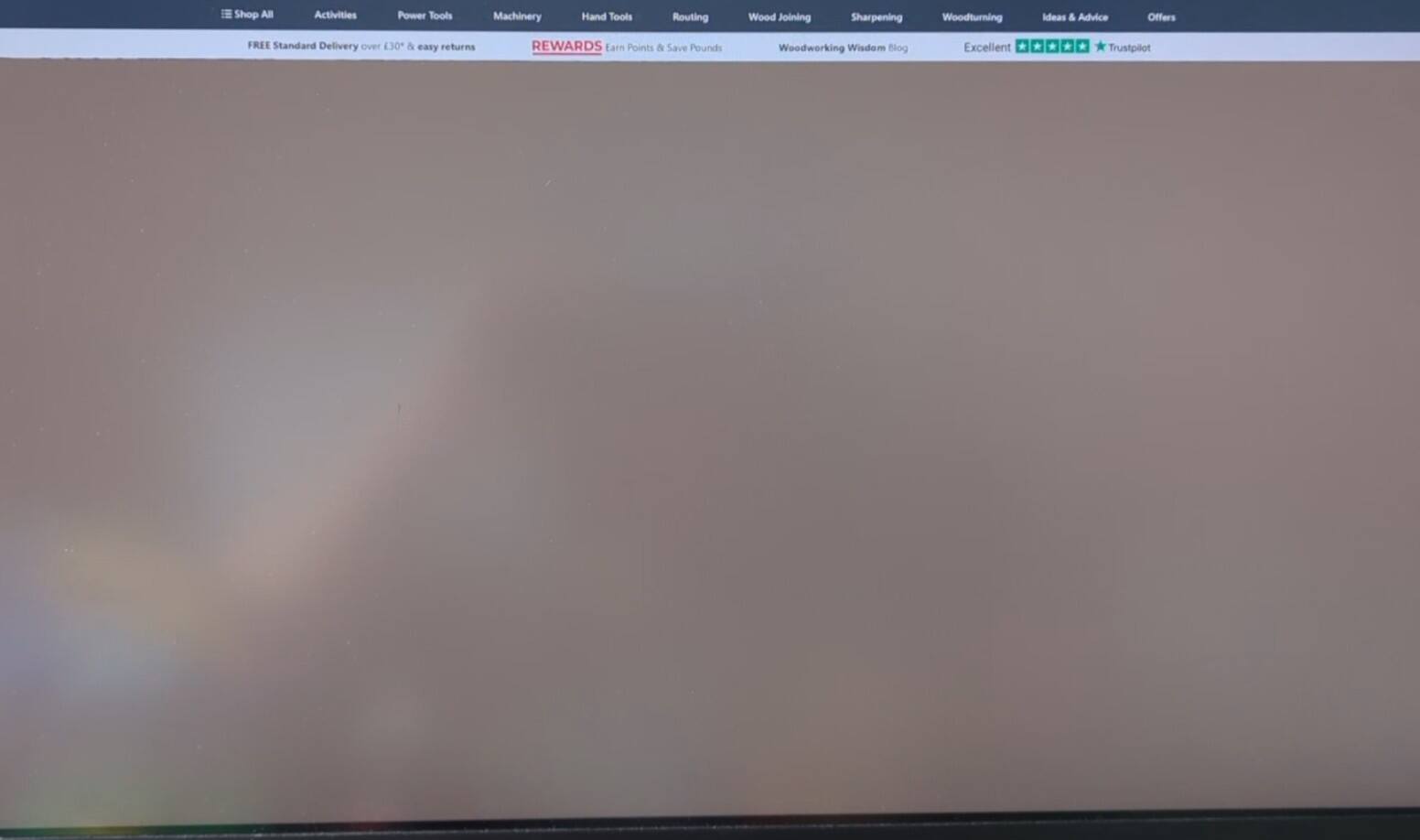

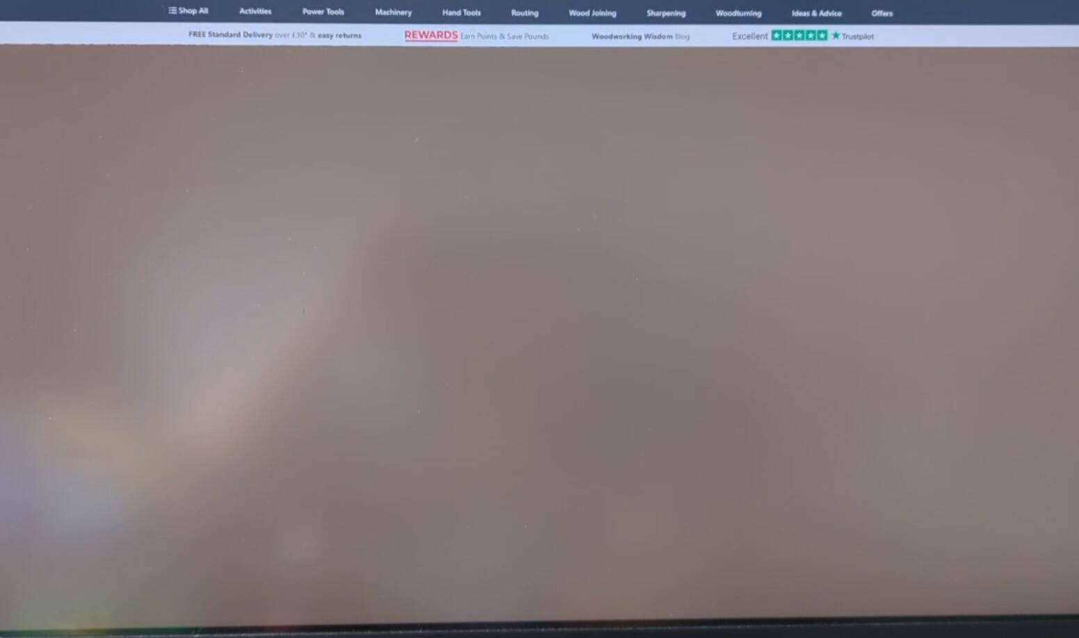

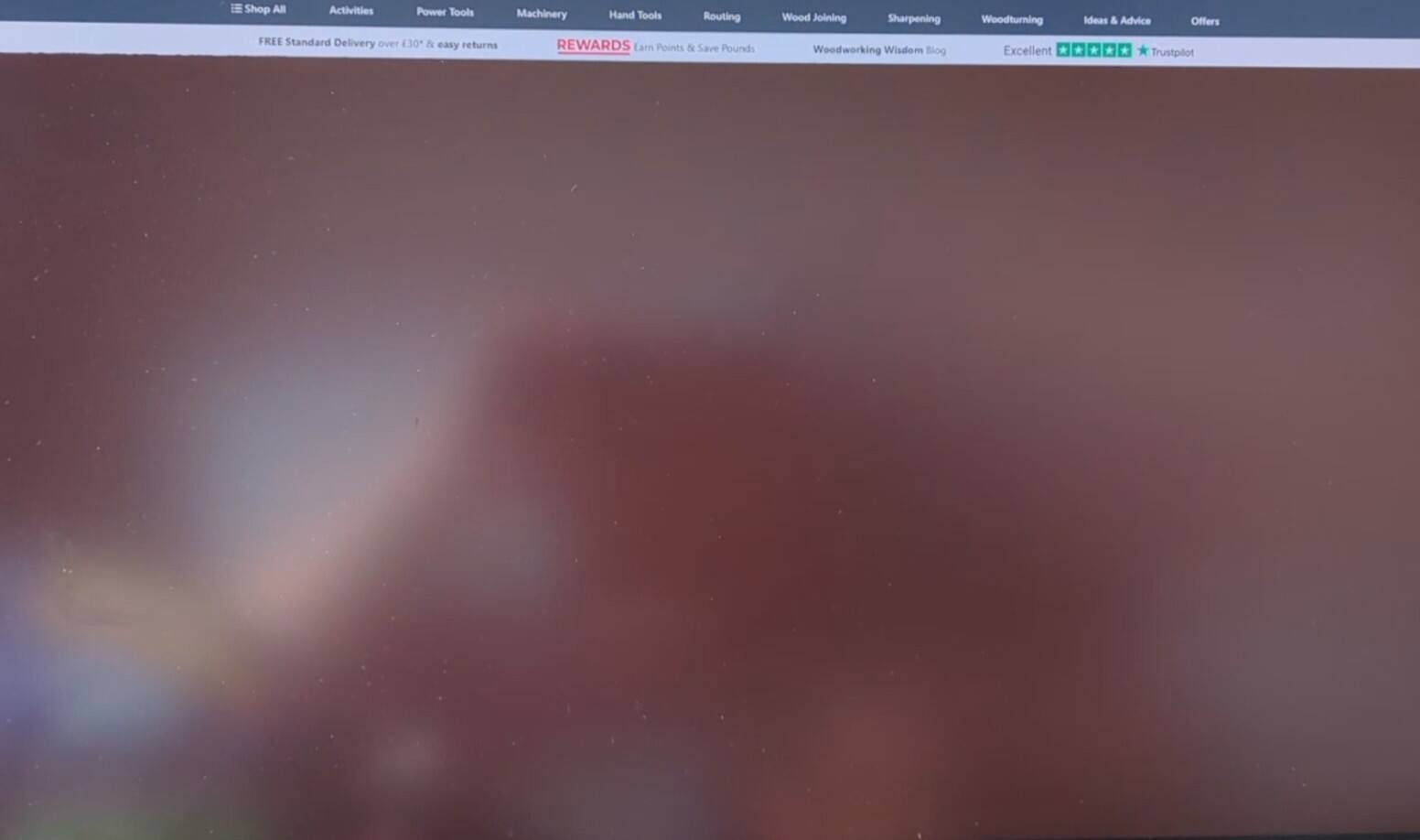

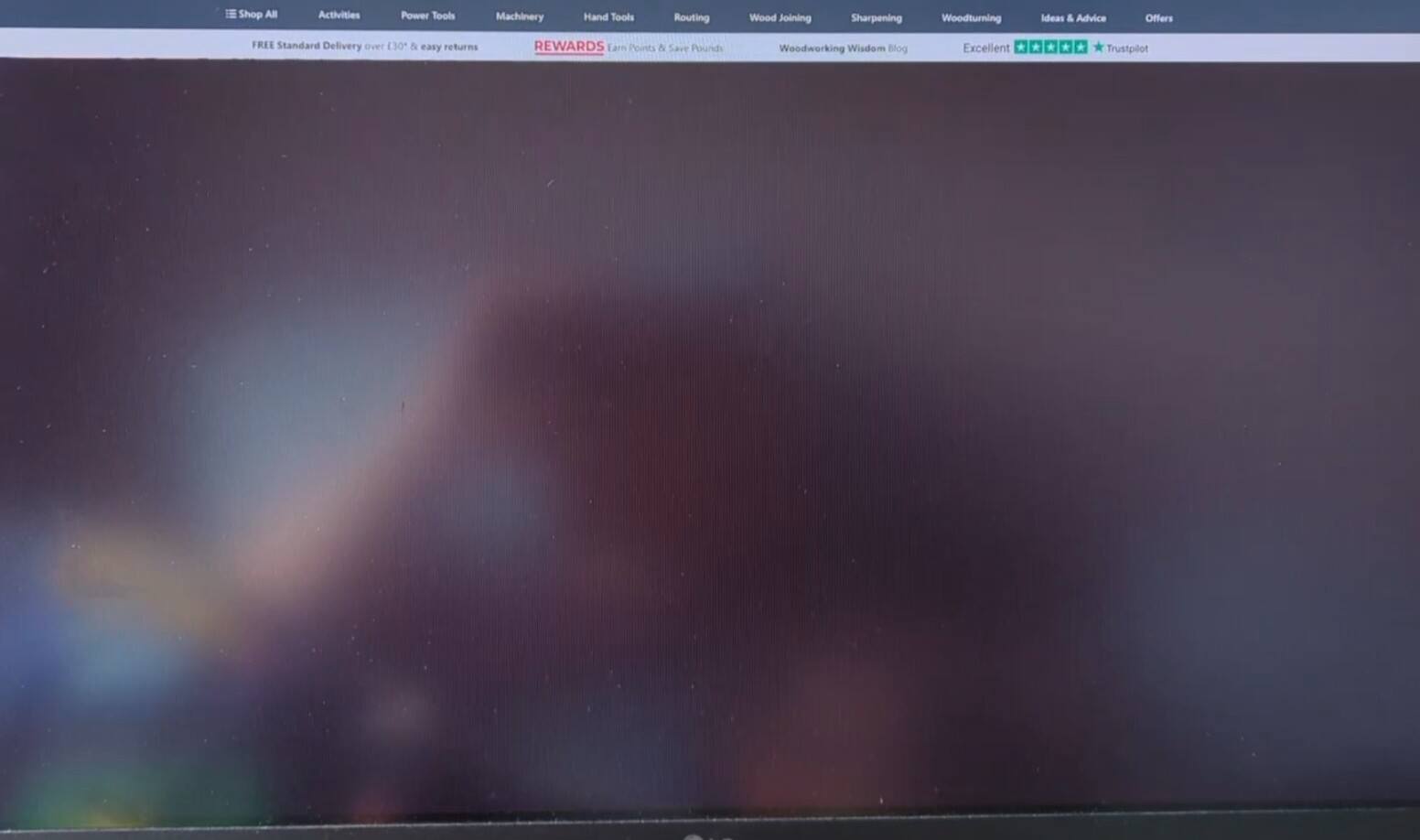

I have a PowerColor Red Devil 9070xt, recently I have been having a lot of driver crashes and stalls and today whilst only browsing the bottom 2/3s of my screen went solid colours and started cycling. The top portion that I could see worked fine.
I have tried using DDU and reinstalling the drivers due to the crashes.
What I am wondering does this look like a GPU issue and does it look serious enough that I should look at sending the card back/RMAing it?
