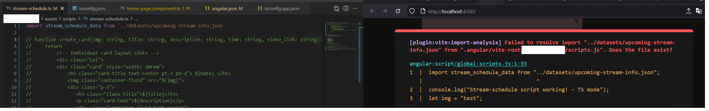

I need help in importing this JSON file to the Typescript file so I can work on it.
No matter what I do it keeps saying that the file does not exist and so on, I've even tried moving the JSON file so that it's in the same file as the TS file, double checked the name everything and it still won't work. From what I've seen, I can access the JSON file by the component.ts file with the same path etc, but if I try to import the JSON file into this smaller TS script, it just says that the file does not exist, even though it does.
Yes, I do have resolveJsonModule set to true, and esModuleInterop set to true as well.
Any help appreciated.
Relative path issue. If react path are anything like php. The path for imports is relative to the parent script location, not from the child scripts location.
May be better to configure path aliases rather than rely relative paths? Makes paths to components alot clearer.
https://blog.logrocket.com/using-path-aliases-cleaner-react-typescript-imports/

Thanks, I'll look into this
My thing is using Angular, so hope this thing works out, will let you know if it does.
