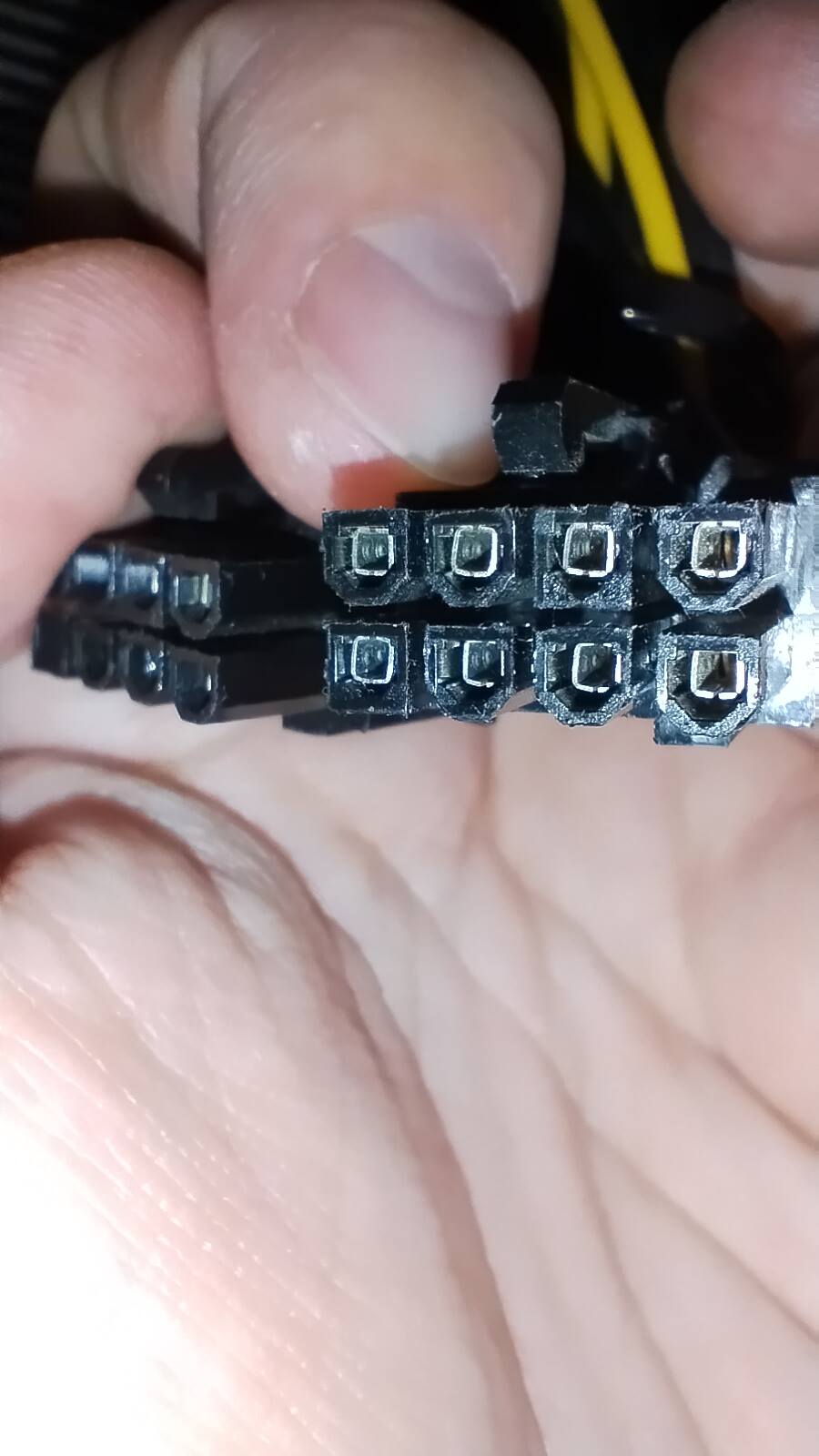

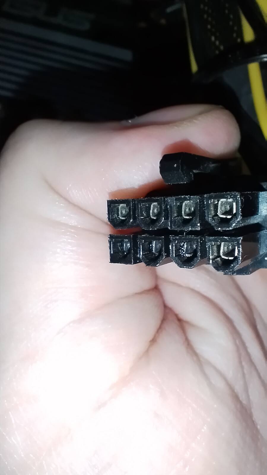

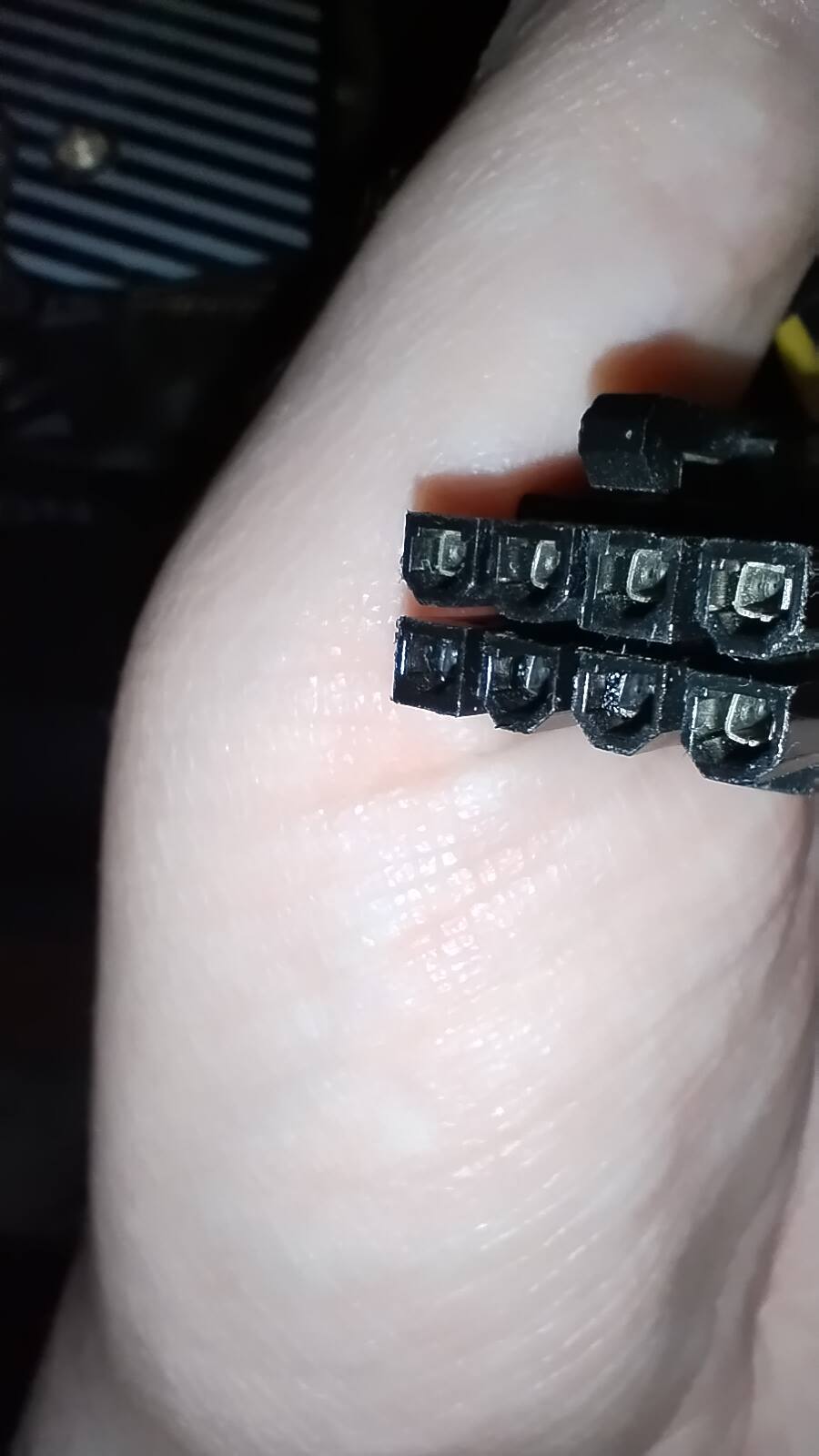

I think it might be simpler than that. I had this problem again and went through the actions described in the original post, but this time the PC couldn't start/POST, the motherboard kept giving the gpu error. I looked in the PCIe power connectors on the PSU side. The connector that connected to the 8-pin plug (this gpu has a 6+8 pcie power ports) seemed to have some melting. I thought it was just shiny plastic but the more I looked the more it looked like just melted plastic creeping on the terminals inside. Nothing seemed to actually get on the contacts, but it was already concerning. Plugging in the other plug on the same pcie power cable made the PC boot successfully. I also tested if the "melted" plug was causing this by switching back to it, and it was, the PC wouldn't boot with it connected. I've attached some photos I took of the connectors.
Haven't checked the GPU side connector, and also I don't know what exactly would cause this. It's either power draw imbalance or bad contact. In the first case there's probably nothing I can do about it, and in the second I should probably thoroughly check the gpu side connector as well (which I will do after posting this).
upd: checked the gpu side, the pins corresponding to the melted pins on the PSU side connector are visibly dulled, other pins are shiny. These correspond to the +12v lines. Hopefully just changing the used PSU side connector will make the issue go away.

https://linustechtips.com/topic/1610243-gpu-losing-connection-suddenly-on-linux/
The logs are showing that the GPU is suddenly losing connection to the BUS. I hate to say it, but this is either a dying GPU or bad power delivery. If it was the PSU you'd likely be seeing other power related issues though. I'm sorry, but I think your GPU is failing if you've already tried re seating connections.
Well, a dying GPU would be... Sad. My PSU is Zalman ZM700-LX, don't know if it was brand new back in 2016 back when I started using it. Kept it through 2 CPU and GPU upgrades. Could it be that it is failing to deliver the needed power to the GPU? Is there a better way to determine which component causes the issue?
You can try running a benchmarking tool like Furmark to see if it can quickly induce the supposed GPU issue you're having. If it does, and you have another PC you can test the card on, see if it does it on a PC you know doesn't have issues. If it happens again with a different PC, then yes, unfortunately your GPU is dying. If not, then I would blame the PSU or motherboard for power delivery or power management.
