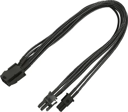

First idea : did you power that extender cable (I guess it is a Y with a few 6+2 connectors on one end) using one new psu cable for each 6+2 connector ?

Yes the connector that I have is Triple 8-Pin Power connector
And you used one new psu cable for each 6+2 connector ? (use the curved arrow to answer, otherwise I won't notice you answered)

Hmm I am not really understanding what you mean . I have all 3 modular power supply connectors running to the Triple 8-Pin Power From the 1200W Psu the reason I am still using the 1200 is because I thought it was the Psu at first. So I will have to switch it back.

Usually those psu cables come with each two 6+2pin power connectors. You're supposed to use only one of those two 6+2pin connectors (Although this might be a myth nowadays).

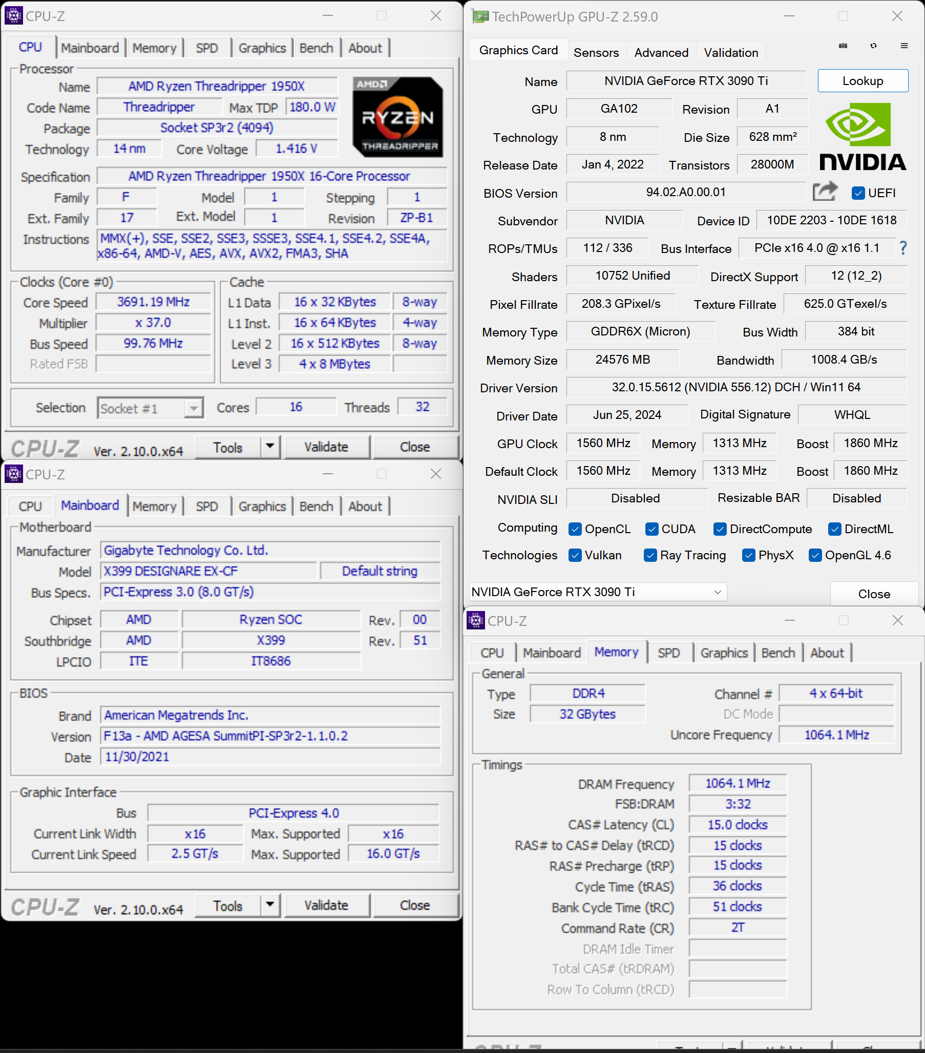

Motherboard Bios is up to date I am not sure about the Gpu Bios but I do have all the latest drivers and I have not tied it in another pc I think that will be my next step.
https://linustechtips.com/topic/1576228-black-screen/#findComment-16463097

36 minutes ago, 191x7 said:
I Disabled the MultiPlane Overlay MPO like you said ran Battlefield again and Black screen again I linked the Gpu log again I will try the other steps in the morning getting late here on the east coast lol almost 3 am Thanks for all the new help and things to try
GPU-Z Sensor Log 3.txt
https://linustechtips.com/topic/1576228-black-screen/#findComment-16463121
