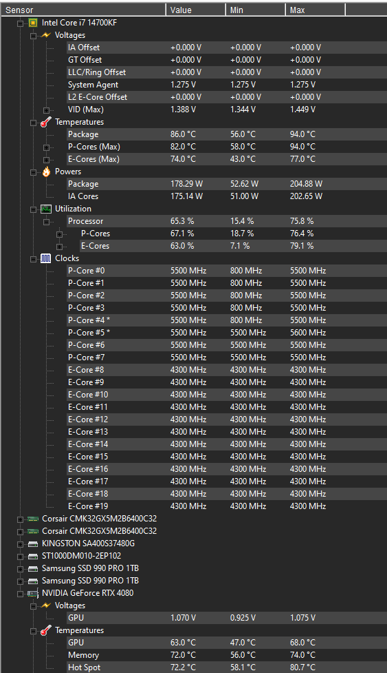

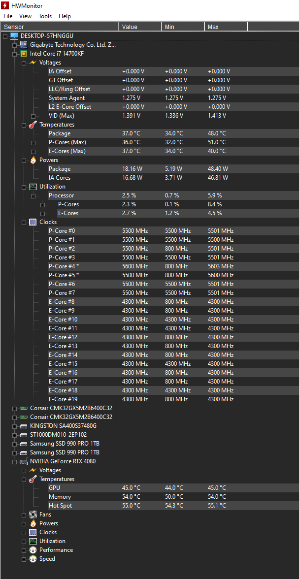

Approximately five months ago, I assembled my PC with an I7 14700kf-series processor. Recently, I've observed the CPU temperature reaching concerning levels under load.
While playing Battlefield 2042, the maximum temperature can climb as high as 100 degrees Celsius. It's quite surprising considering the hefty Noctua NH-D15 cooler I have installed.
Before diving into replacing the thermal paste, are there any other potential causes I should investigate? I've attached an image illustrating the temperature readings before and after stress testing.
Sorry I didn't notice I didn't attach the pictures
This is the computer:
Intel Core i7 14700KF / 1700 Tray
Noctua NH-D15 chromax.black CPU Cooler
Gigabyte Z790 AORUS ELITE AX
Corsair DDR5 32G (2x16G) 6400 CL32 Vengeance Black
Corsair 4000D Airflow TG Case
RTX 4080 Asus pro art
Idelmod.png.bd91f9e4e3d1ea7673c4ed7a7e768014.pngWhileplaying.png.d77e08e16160de699a812cdf393c0f32.png
The rest of the parts in the computers are perfectly fine, tomorrow I will open the computer and check that everything is fine in terms of thermal paste and maybe I really forget the plastic by mistake.
if everthing is fine i will consider buying a water coller
got any recomendation ?
