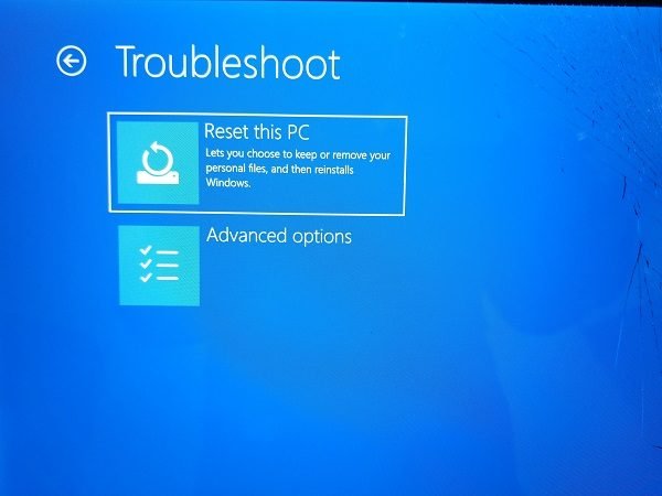

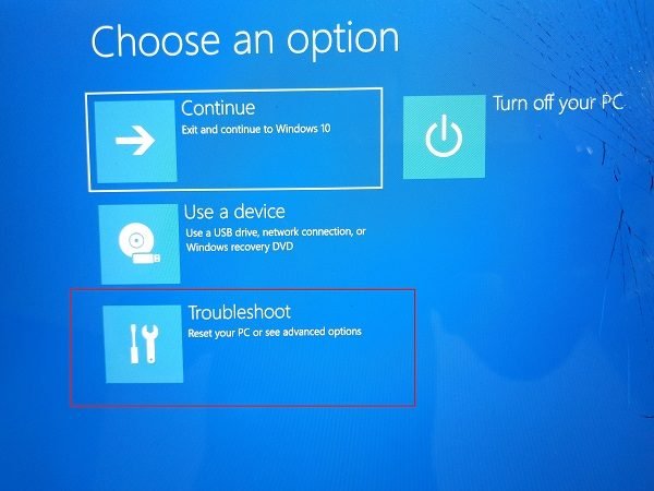

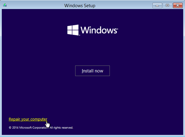

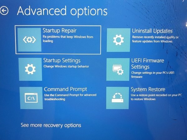

Just now, Latvian Video said:
Boot from the USB, you should be able to click repair this computer
 repair your computer windows setup
Go to Advanced options
ngcb154
Select troubleshoot
ngcb154
Click advanced options, then click startup repair
ngcb154
It won't boot anything, including a flashdrive.
