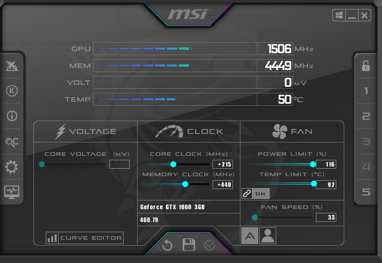

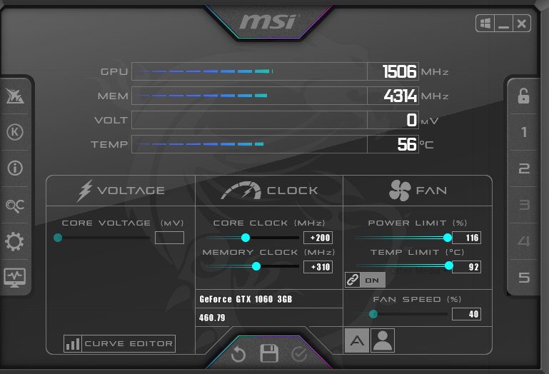

Im using the furbench or whatever it is but  if i go above that core clock the app crashes so im overclocking the memory now untill it crashes. What should I do. Do I stop overclocking the memory or what. Im new to overclocking
With my experiences overclocking cards with GDDR5 like your 1060, +310 is a middle of the road OC. You won't be able to get a ton more out of it, but I would try to push it a little harder, but if you can't get any higher easily, don't bother.

So I should push mem untill it crashes then little the clock a little
I would just push the memory. That core clock looks about right for one of those card. You can always try pushing it, but I wouldn't expect much if anything to come from it.

Like I said thats all the core can do. If I push more it crashes. Do I push mem first then core or what
I usually push core then I push memory. It would be a difference of 2 FPS most of the time. Unless you are going to restart your overclock, don't push the core after you do memory, as you won't be able to get any higher numbers.

Alright after pushing memory the core let me add another 15.
