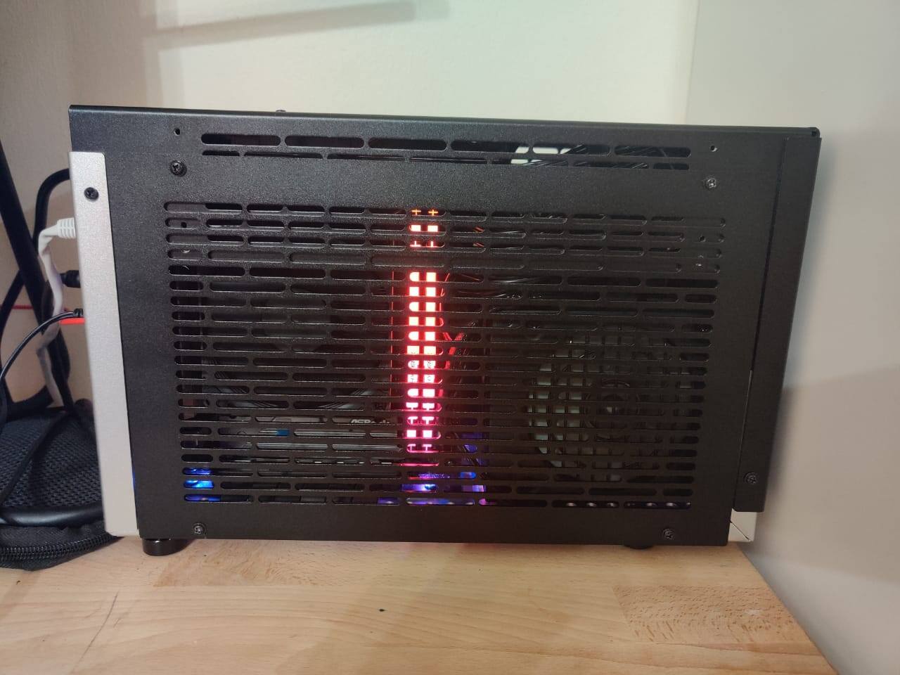

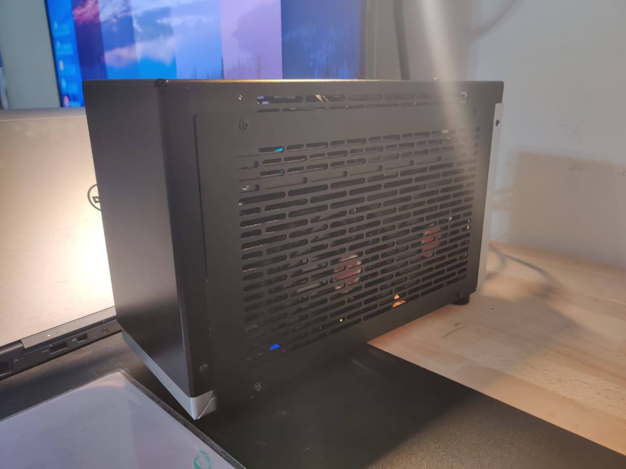

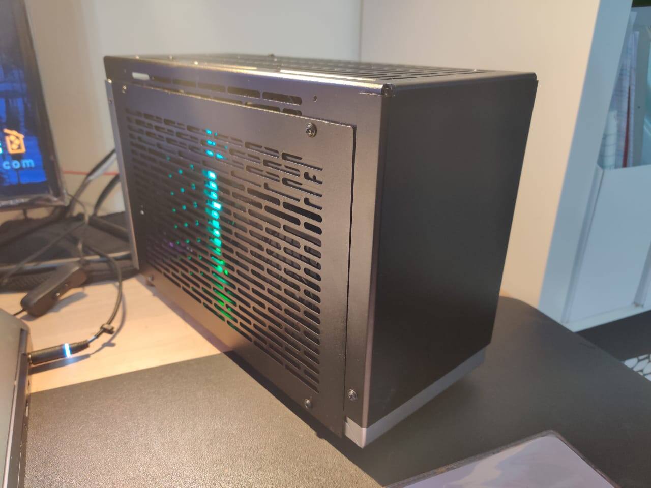

27 minutes ago, Stygian Zenith said:
@jchakramakal may i ask what case you are using?
Its a custom build case. Attached some pics. You can see, its height adjustable and in the inside I can adjust the plate were mobo is installed based on GPU thickness/CPU cooler height.
