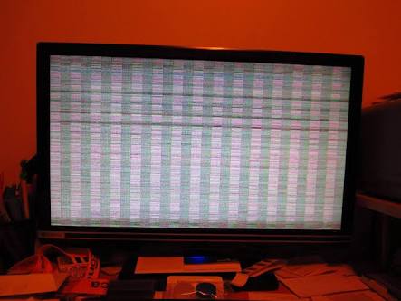

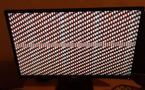

The thing happening is like when you shock a monitor with static but in my situation the monitor is not turning off/back, its just a milisecond flicker/shutter.
Even tho you %99 of the time you barely realize what happened  but i remember seeing similar shaped figures a few times like in those pictures which doesnt belong to me;

I would try an alternate motherboard and ram it looks kinda like what happens if the ram is pulled out when it’s running so it might be a loose slot on the board. Try and find a temporary motherboard to test and try out your ram sticks one by one
