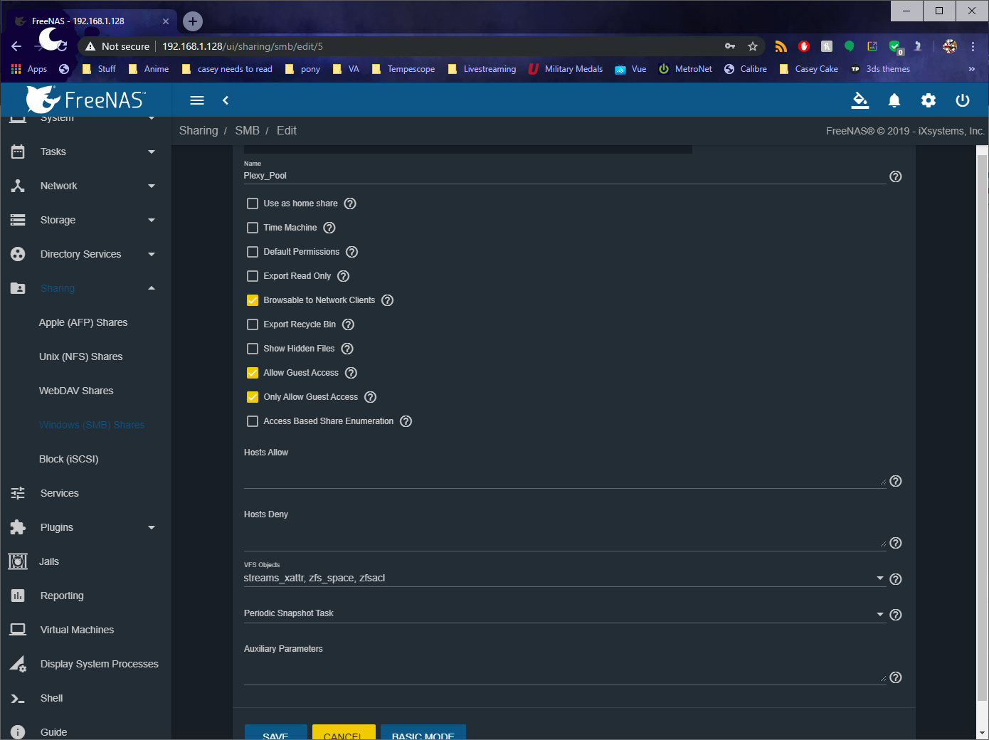

You might want to disable the " Only Allow guest Access " option. Not quite sure what FreeNAS means with guest though. Is that the same as Anonymous?
Because normally you would connect as Anonymous to a SMB (SAMBA) share when not using any authentication. Can you ping the NAS from your PC on hostname?
Ping -a should return the hostname of the server.
ping -a 192.1681.1.128
Edit: Try connection to file share by using Winkey + R and then type \\192.168.1.128\<Sharename> it will open up or a login window asking for credentials show up. Then you are halfway there.
