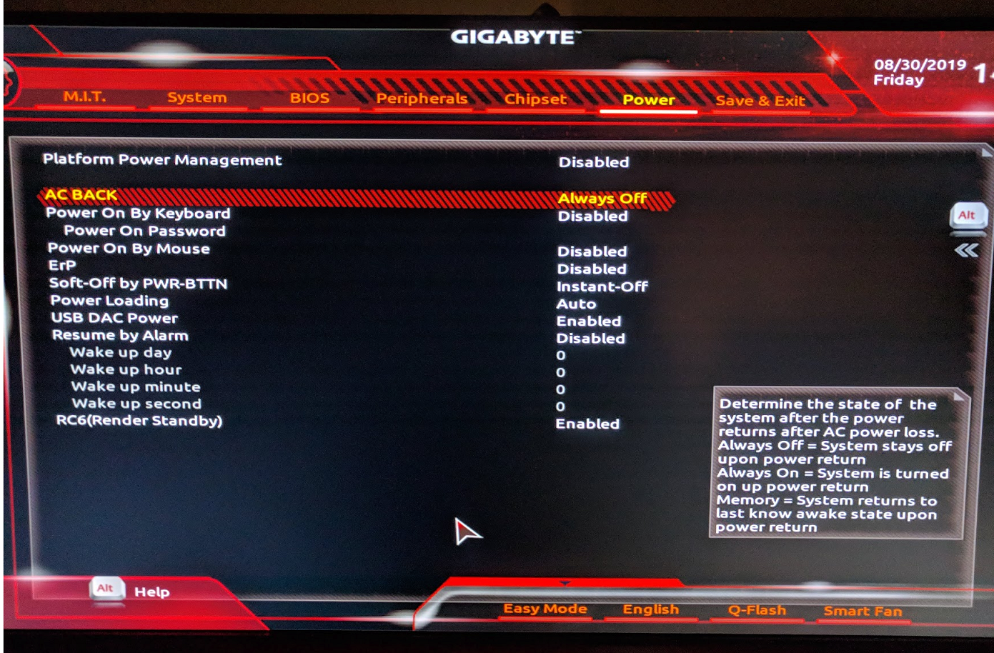

Well I found that the option ''AC back'' is the closest thing you described. But it was set to off. Could it be that this another Gigabyte bios flaw? I had problems in the past with the bios and will probably not buy another gigabyte motherboard again.
"AC back" sounds like the right thing, but if it's already set to off...
Tomorrow I'm going to find a Gigabyte board to fire up and confirm that's the setting.  But it sure sounds like it.  It was in the power tab, right?
I'm using a Gigabyte board. AC BACK is indeed the setting you are looking for.
