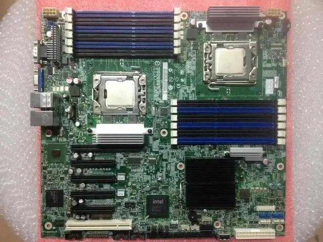

That is a triple channel setup for each CPU, just know that you will be losing a significant amount of memory bandwidth.
Also, you can get the clips out without damaging them if you are careful.
How? Memory clips are far away enough to not block PCIe cards.
The motherboard is an SSI EEB(eatx) form factor board with 2 lga1366 sockets. It has 12 ram slots in an orientation perpendicular to the modern ram slots.

1 minute ago, KarathKasun said:
That looks like one of the "fill this first" slots.  You would be better off with a riser/PCIe extension.
Can't, the case i've got doesn't support any pci-e risers or extensions, unfortunately. Really annoying actually because i've got a few lying around.
There are kits to modify the case for vertical card mounts.
It would be easiest if I could just clip the ram clip off, i'm only installing four dimms and am very likely not going to upgrade the ram.
I just wanna know if the clip will sort of shatter in any way or if it'll be a clean cut(probably should've put that in the first question)
Wait...I thought they were irremovable...I tried looking for a guide for that but I couldn't find one. How do remove them if you don't mind me asking?
Depends on the board.  A small jewelers screwdriver will usually let you poke and pry enough to dislodge them.  Usually they just clip in.
