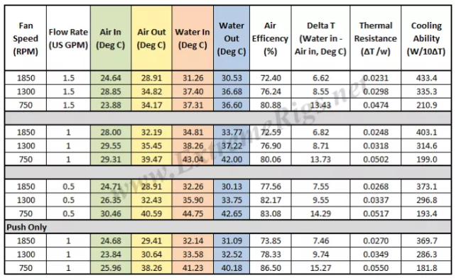

Here is a very detailed overview of the radiator and its performance:
https://www.xtremerigs.net/2015/02/10/alphacool-nexxxos-xt45-360mm-radiator-review/4/
The important part:
So even in a push only configuration at a 1 gallon per minute flow rate it could technically handle your system (at synthetic load) around 1800 RPM, which is a fairly high RPM. With a 1.5 GPM flow rate and push pull you could program a fan curve that keeps the fans relatively low at idle and under load with decent temperatures.
Page five of the linked review compares XT45 performance to other radiators and there are many below it and above it. Kind of a middle of the road radiator, not great, not terrible.
The important part:
OK,  Thank you for your work on that.
