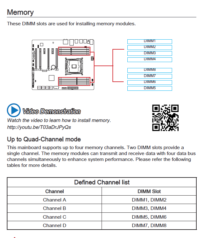

Right now my modules are in the configuration above, but it looks like i can still keep quad channel if I add 2 extra modules like the suggestion form my manual below. (I have X99S SLI PLUS)
So I should be fine if i chuck in some bigger capacity as long as they are rated for the same speed and timing?
How would I correctly configure a 4x4GB + 2x8GB setup? I'm not sure if I trust myself here, just gonna ask to be sure :)
