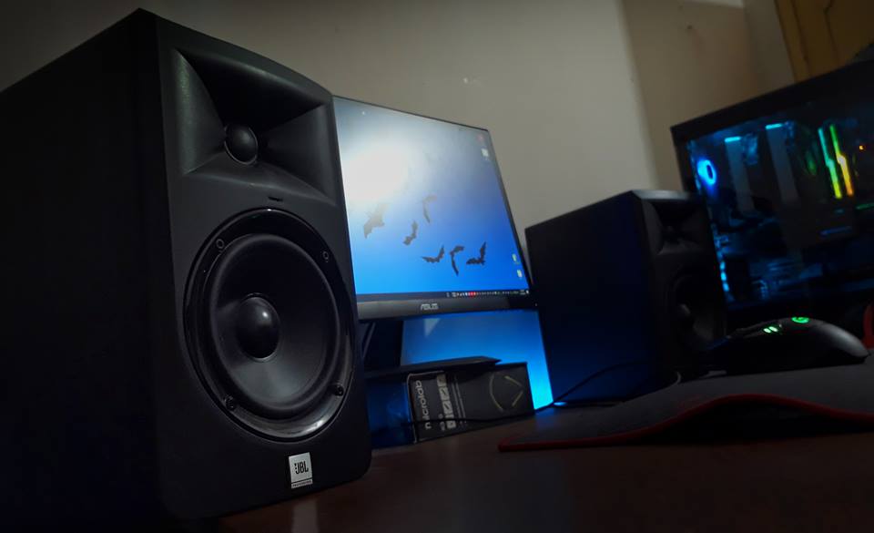

I'm currently using a pair of JBL LSR305 with my pc.
It's connected with the motherboard 3.5 mm output. The mobo is Asus ROG Strix z370f.
Is it enough to utilize the full potential of the speakers?
Will getting a dedicated external DAC or a Pre Amp improve the sound quality by much?
Also , i'm about to get an audio interface so that i can plug in my guitar to the pc for using with Guitar Rig 5.
As far as i know, audio interfaces also have built in DACs?are those better than the on board sound cards of motherboards?
I have a budget of about 100-150$ for that. which audio interface would be better in this range? M-audio/ Focusrite Solo/ Presonus are the only stuff available where i live.
P.S. i'm quite noob when comes to audio stuff,so any advice would be much appreciated.
