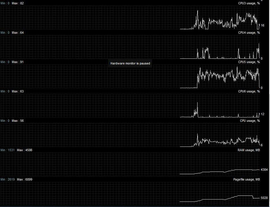

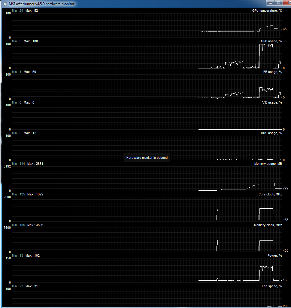

Also I ran the a performance test for Company of Heroes 2 and the FPS ratings were:
Min: 17
Max: 48
Avg: 29
And here is the MSi Afterburner results when running the test.

38 minutes ago, GunSlinginOtaku said:
AMD Fx6300 not Oc'd and stock fan
I would bet my money on that being the problem.
I would get a new CPU if i were you (Ryzen 3 or 5, whatever suits you),and if you really don't wonna change it out, then at least get a new cooler and overclock it as much as possible.
Thanks for the response!
I recently Oc'd my 6300 to 4.0 from 3.5 (Using AMD Overdrive... not the BEST way I know but it's what I can do with my current knowledge) and I seemed to have had a higher average FPS in games but still the stuttering.  I was thinking between upgrading to a 9590 which will set me back $160 (With an AIO Liquid Cooler) or just saving up to get a Ryzen like you suggested.  I feel as though getting a Ryzen would be a better long term investment anyway.
