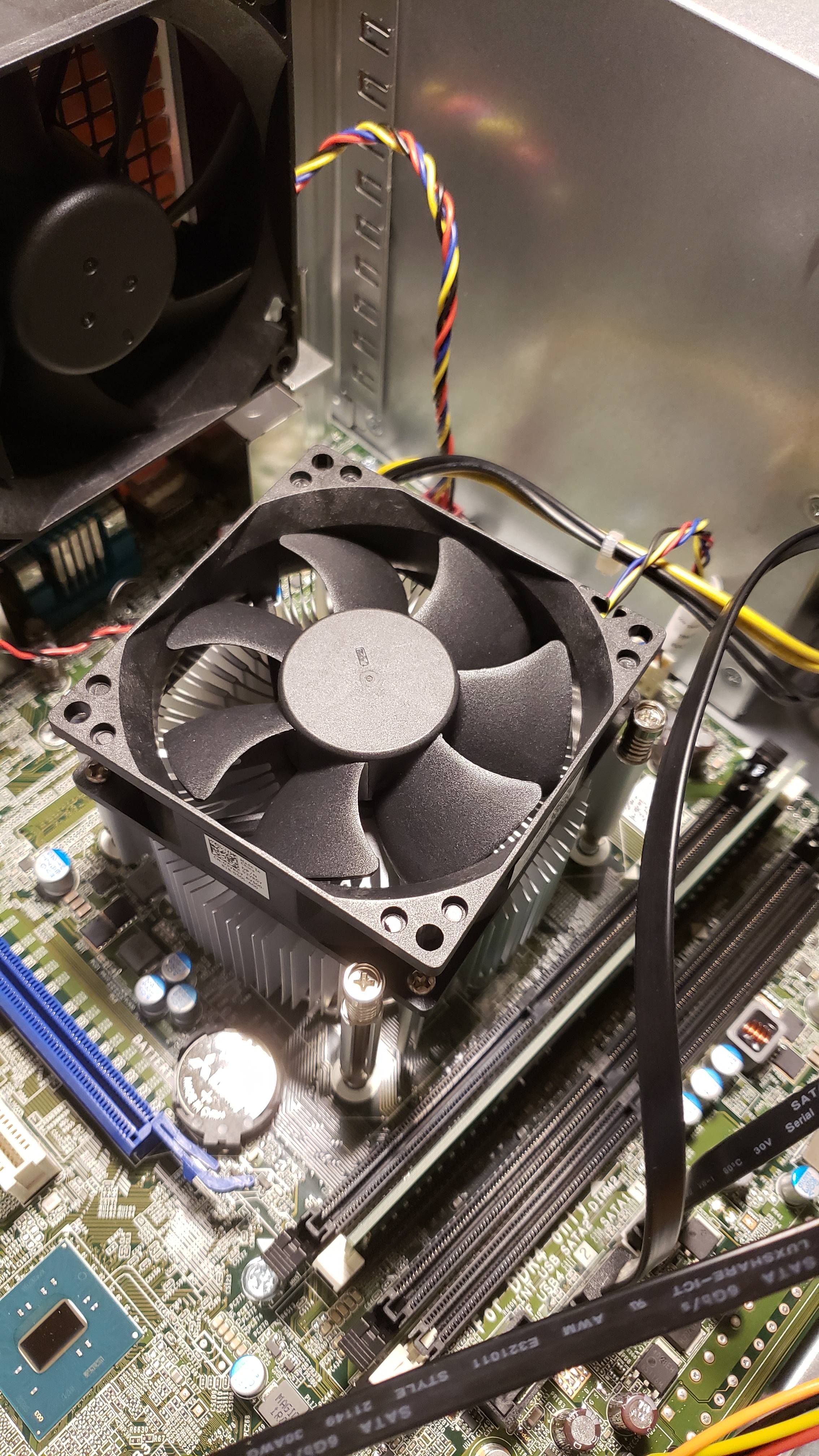

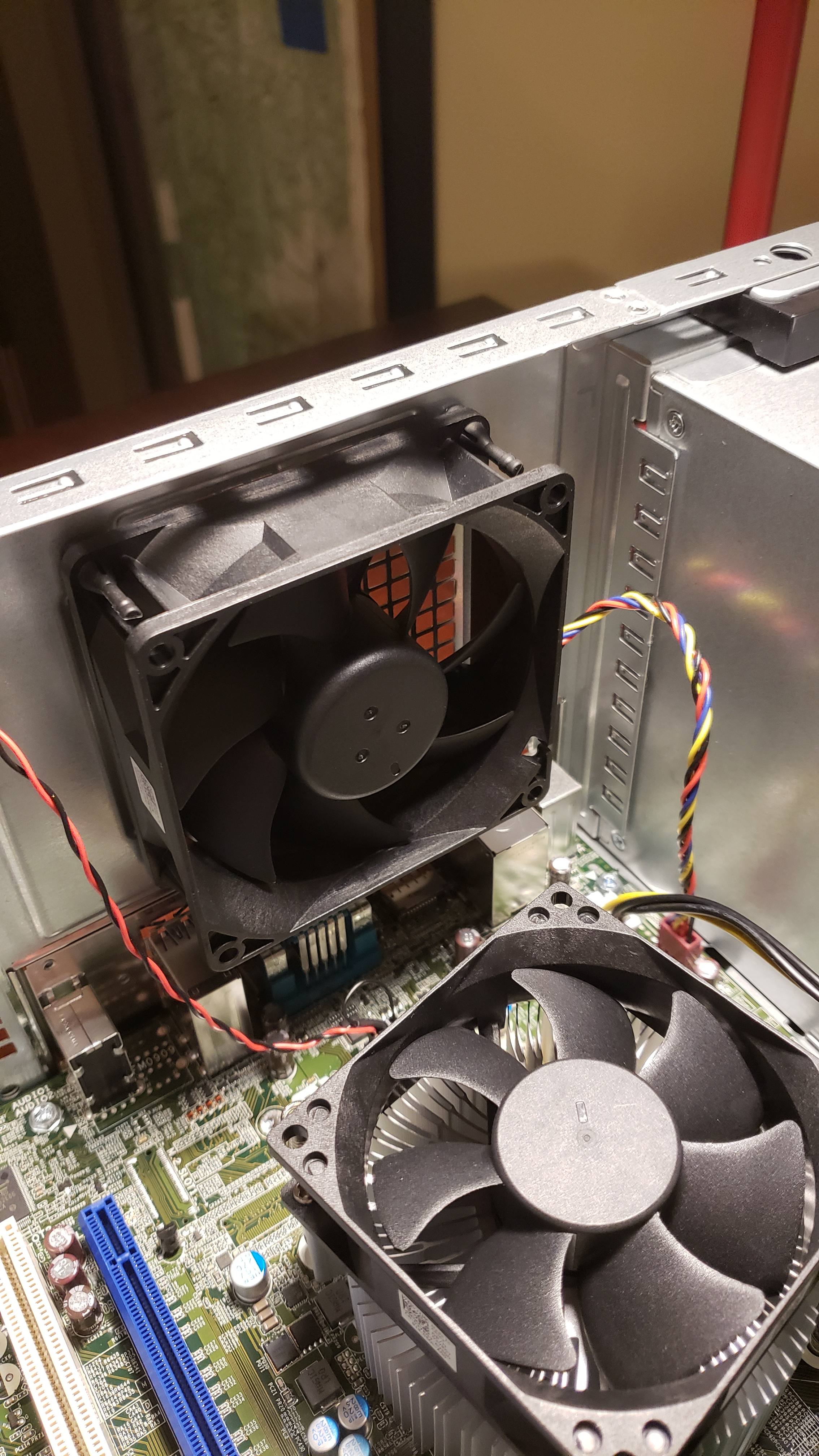

I'm looking for fans and a heat sink to replace the ones in my Dell Poweredge T30 Server. I'm using a Xeon E3 1225v5 CPU which is LGA1151 chipset. I know that I could just Google it, but I'm looking for suggestions for quieter options since the stock ones are really loud when they run.
Budget:
Fans: max $40 for a pair
Heat sink: max $50

11 minutes ago, Imbellis said:
Could you try to measure the height above the motherboard to help find a CPU cooler that'll fit?
Often prebuilds will have odd quirks that wouldn't exist in other cases.
Edit: In addition, do you know what size fans that are compatible with the case?

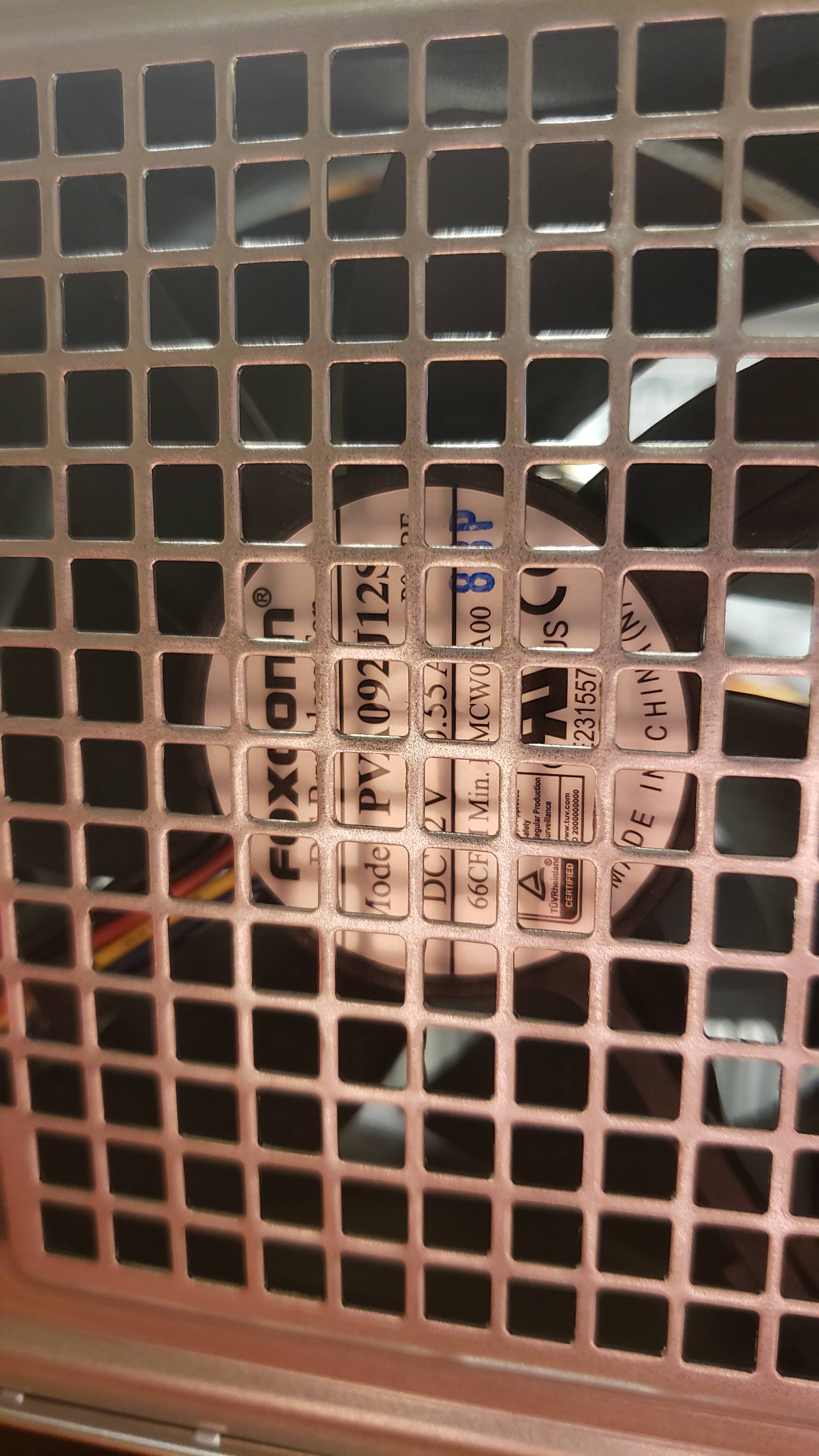

The stock fans are unmarked for size, but they appear to be around 90mm wide, 120mm diagonally. Not sure how fan measurements work for sizing
As for the cpu height availability, right around 130 mm to the case wall. There is absolutely nothing obstructing the way. Cpu cooler thread spacing is about 76mm between holes. And the first ram slot is just under 10mm from that right most hole
Hope the large amount of info is useful

Edit: Oof. I went ahead with this thinking that that was a 120mm fan slot near the back. It surely looks like one, but eh.
The link will still be of use, but you'll need to navigate to the 92mm tab.
I'd still recommend NoiseBlocker, Noctua, and bequiet! for your fans. Although some other companies have better statistics on their fans, they often lie - as there's little to no "regulation" in this market.

For CPU cooler, I'd recommend Noctua's U9S - It's at $57 - so above your initial price for a heatsink; however, it comes with two fans - removing the need for you to buy a second fan. You can also take a look at the Cryorig C7 (~$30); however, it has been known for manufacturing defects and not being the most quiet.
In total, The heatsink would cost you ~$60 and another fan around $15 - totaling up to $75 - under your $80 combined budget.

Ok. I think I'll go with the u9s. I also figured out that the fan is 92mm fan size by more precise measurement from end to end.
