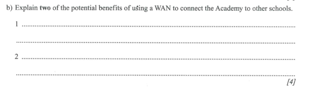

it might be easier if I show you what im looking at:
I do not know what it means by wan in this context24e00e096a1e4719f4cec3959d93bc33.png

WAN in that case is just referring to the connection of multiple locations together although it's pretty poorly written since technically that's the only way to connect "Academy" to other locations.
They probably mean "why would you want to connect "Academy" to other schools" in which case you have many different examples, sharing of resources (eg: files) between locations, communication and collaboration between students, video streaming, etc.

Ok thats what I thought. And they are basically connecting these academy's together through the internet?

In a context like this, "Wide Area Network" is being used as a general term for a network that is larger then the local one, but doesn't necessarily mean the internet (which is the widest possible network). People say that WAN means internet because when you are talking about a single simple router/gateway/etc that just has a WAN side and a LAN side, the WAN side is normally the ISP connection to the internet. When you start getting into more complex networks, WAN can have a more nuanced meaning.
For two schools connecting to each other, they will normally use dark fiber, MPLS, Metro-E, or other physical connections between them, or they may just decide to create a permanent tunnel (like a VPN connection) that uses their normal internet connections but provides a way for them to route traffic "directly" to each other. The combined network of the two shared through such a link can be considered a WAN, because people at both schools can access resources of both as if they were a single LAN (the reason why this wouldn't actually be a single LAN is that you would never do this at L2 but always at L3)
