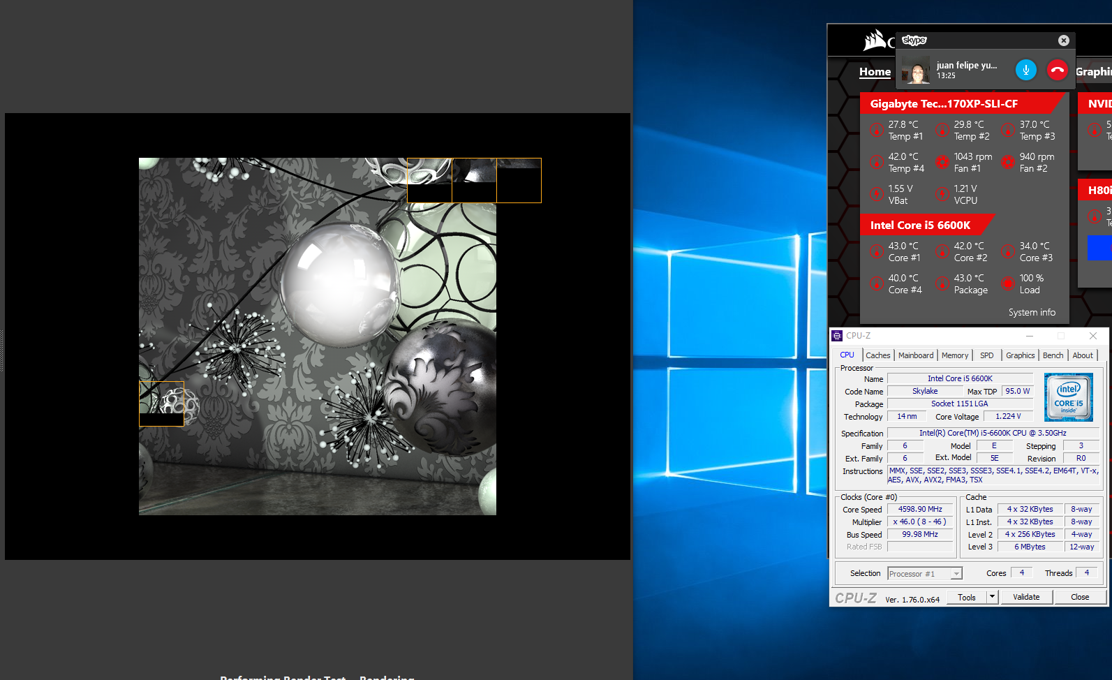

9 minutes ago, Chandres said:
Here is a quick image of about 30 minutes of load and doing a cinebench
Have you tried other software like OCCT?
