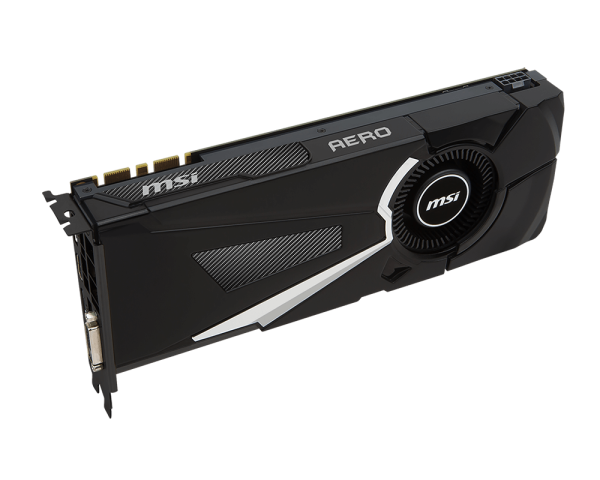

If you dont want the FE, you could look at the ASUS Turbo or MSI Aero reference styles. These cards should come in very close to the MSRP for the 1080's from Nvidia.

There's no "8-pin power issue" with Pascal. The only problem seems to be cooling and the silicon, power is not a limiting factor.
But anyway. Galax has a reference card. And so does MSI, if you can find either.
