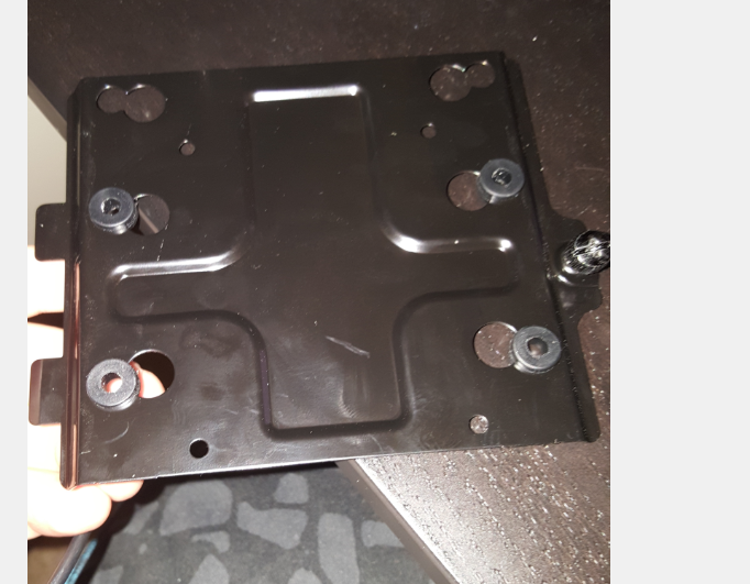

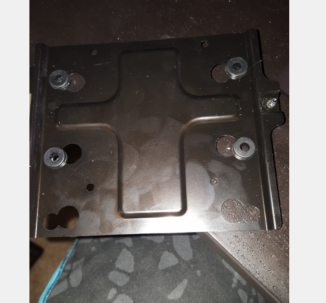

Both sides of the hdd mount has anti-vibration rubber.
-PICS-
Looks like pretty standard rubber washers that don't really do much but one thing to note it is slotted in place and only screwed down on side make sure the slotted side isn't vibrating or loose at all.
I personally like to mount HDD on really thick foam or rubber isolators or shock mount the drive so it doesn't have any way of transferring vibrations to the case
https://linustechtips.com/topic/405992-loud-hdd-with-video/#findComment-5471436
Certainly doesn't look like rubber to me. Maybe use some foam or something and attach onto there.
