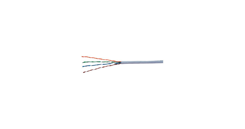

I'm no expert but my dad does a lot of work for schools, businesses, etc and the company he works for uses this type for networks unless they need higher speeds
looks like cat5e. cat6 has an insulator inside
