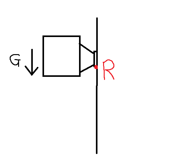

The Noctua cooler is tightened up to the stops on the treads. Those screws bear down on the cooler mount through springs, but there's no way to adjust the pressure from those springs?
I've attached a drawing. I'm wondering if when the PC is upright, weight of the tower cooler is causing it to rotate slightly putting extra pressure on the lower part of the CPU & pulling the CPU away from the pins at the top?
It's possible, about the cooler pulling on the board! Try to remove the cooler and see if it crashes or not (make sure not to do any intensive tasks as to overheat your CPU) and please tell me how it goes! 😀
