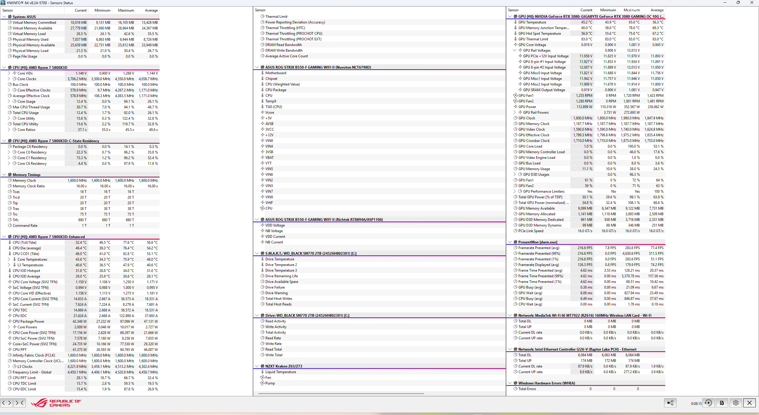

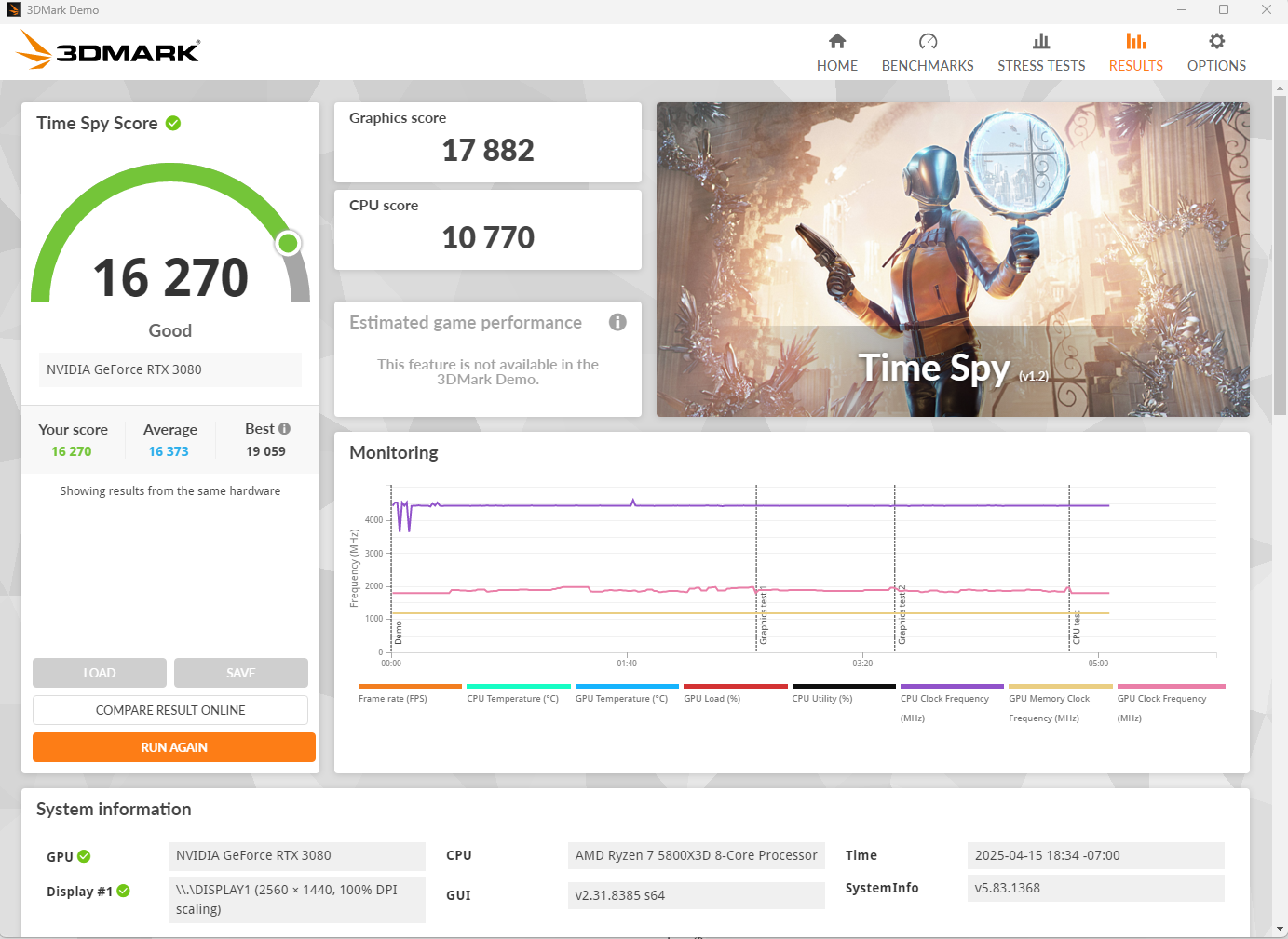

Tested 14851 on cinebench Time spy score in photo HWinfo is after the timespy
Heres another one https://www.3dmark.com/3dm/131181048?

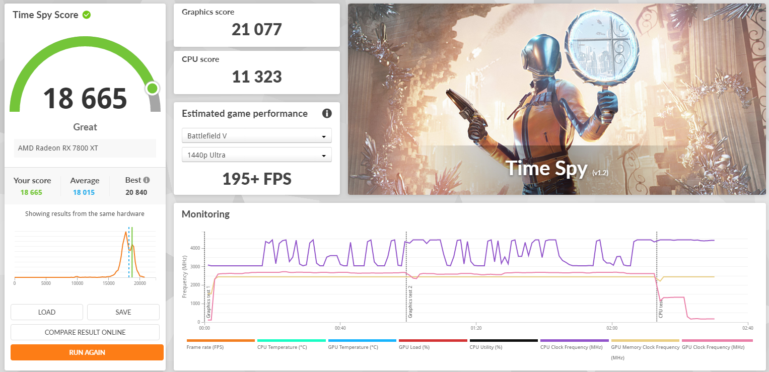

https://linustechtips.com/topic/1608979-fps-drops-in-games/#findComment-16706980
I just ran these benchmarks my self just now
the cinebench score is good and where it should be for the cpu
and in time spy the cpu score is within 500points of my cpu.
I notice your CPU is max freq for the duration of the Time Spy benchmark? is that because you have locked that freq? (for ref mine is like this)
https://linustechtips.com/topic/1608979-fps-drops-in-games/#findComment-16707077
What kind of drops? During loading... Or when/how often does that happen? How big are these drops?
5800x3d doesn't support overclocking, and frankly doesn't need it... Try default settings.
Your 3dmark score is fine.
So, what are we trying to fix?

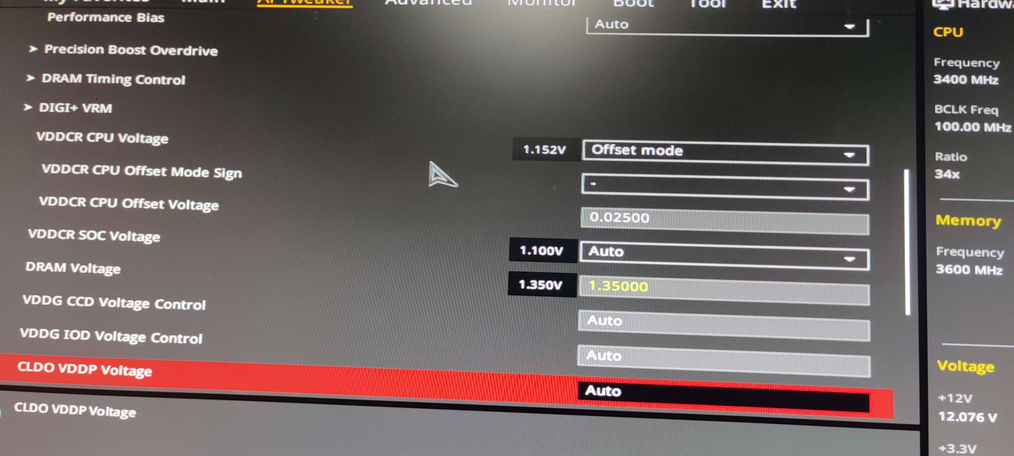

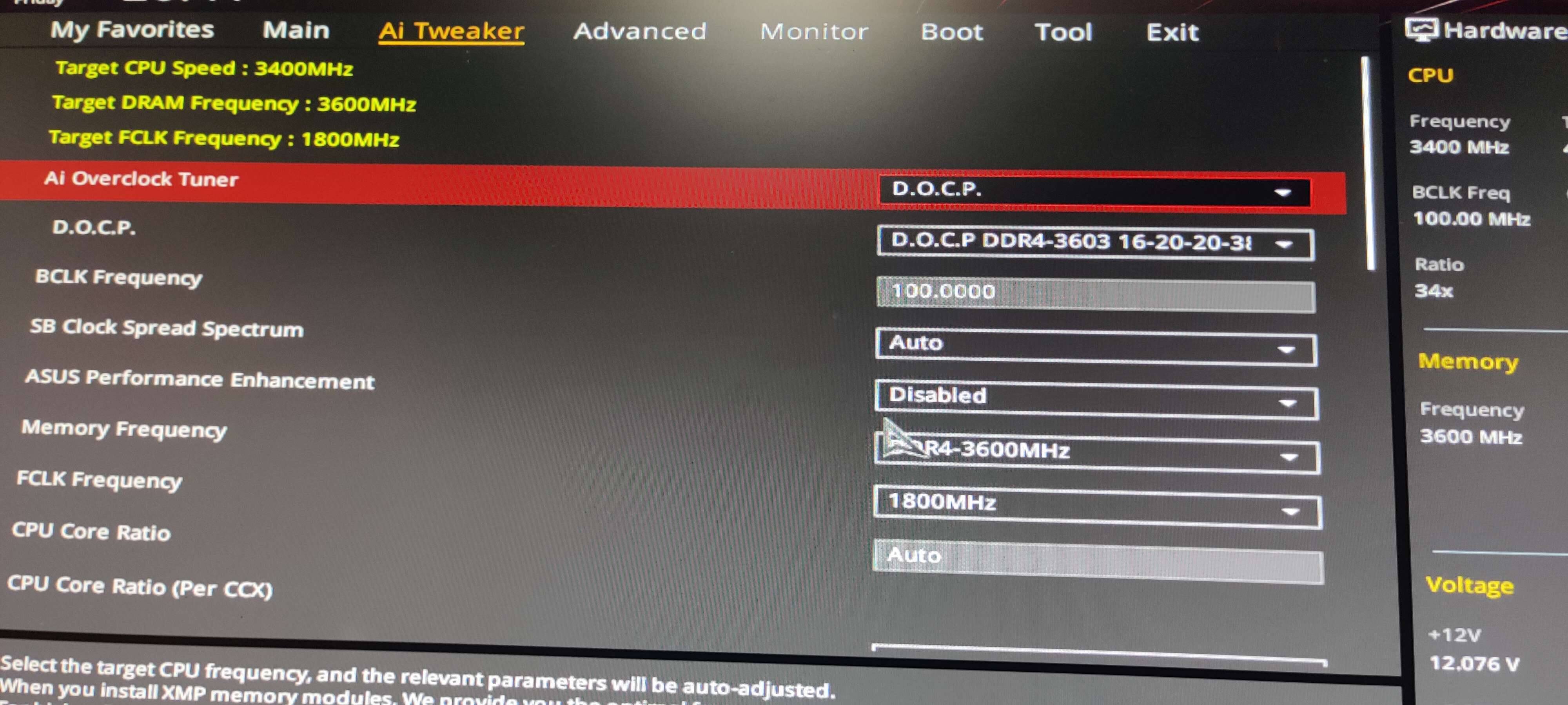

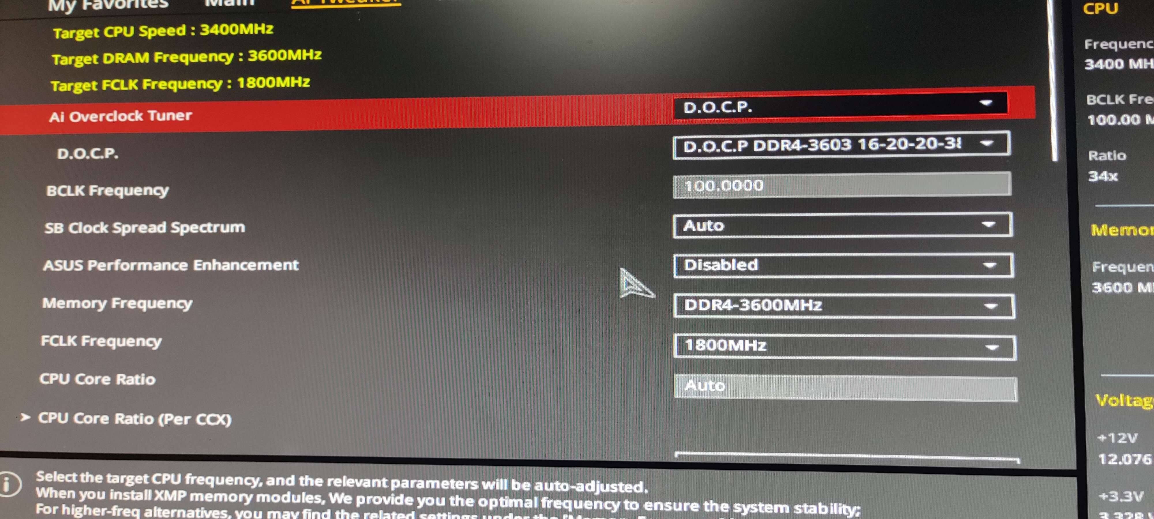

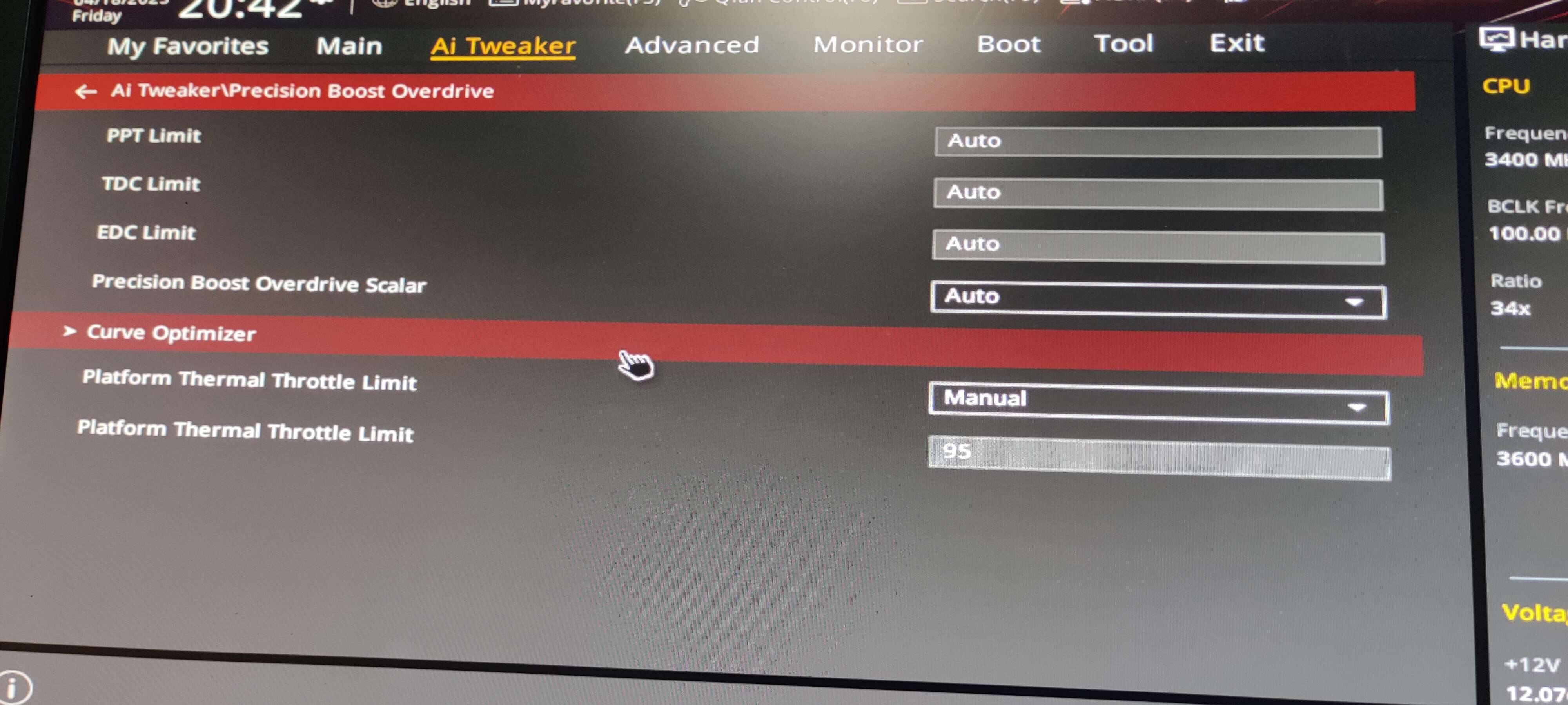

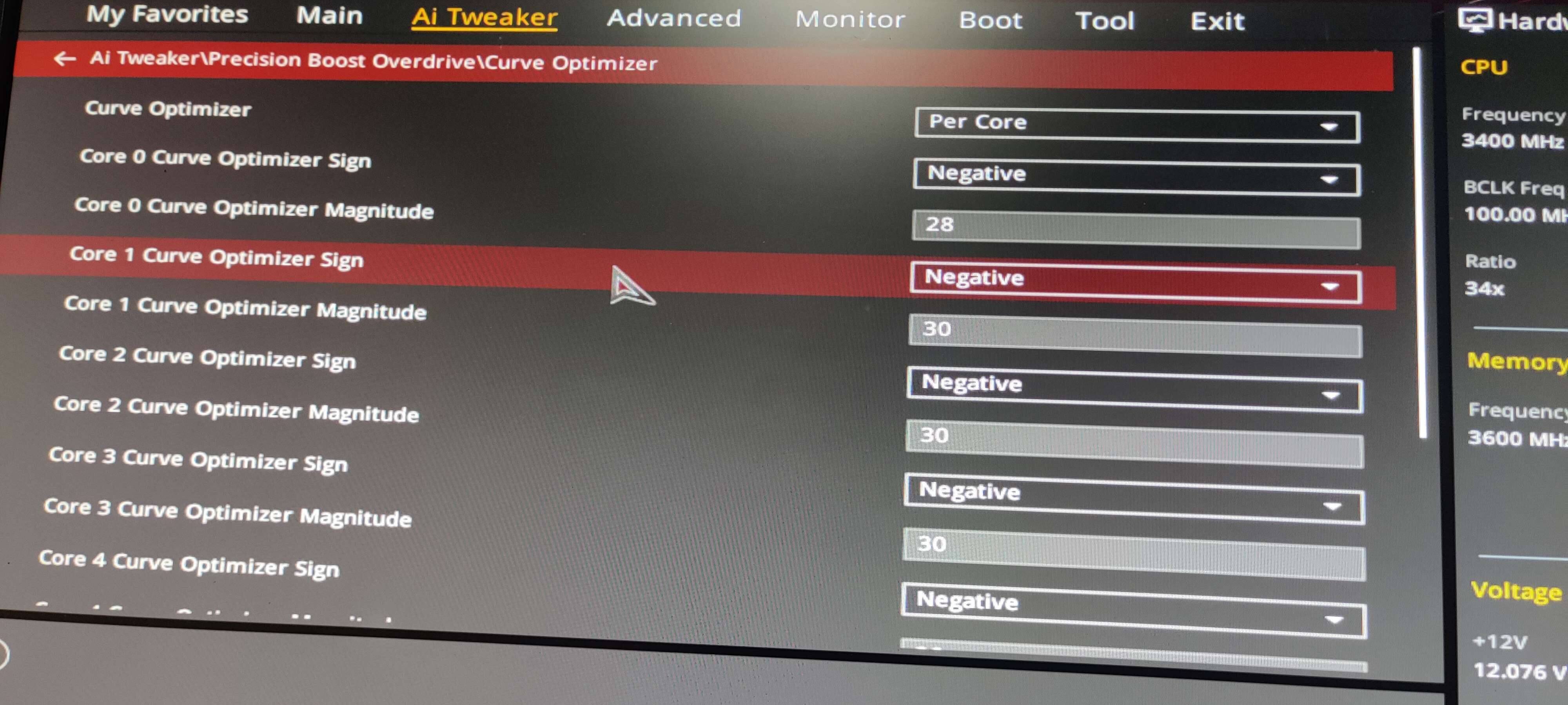

Right i have been meaning to take a pic of my bios screen to show you my settings seeing as we have the same(ish) motherboard.
As @Mark Kaine said and reminded me tbh i forgot how limited the bios is with 5800x3D
You cant really go wrong.
Anyway tinker around abit and you will find the sweet spot for the cpu but i doubt its causing the microstutters.
These are my settings with a slight voltage offset, make sure you disable that asus performance enhancement
Something i find is working for me is limiting the fps on a per game basis to the refresh rate of the monitor or as close to, no point pushing 500fps on a 144hz monitor to me but i do it for noise and power consumption.
IMG_20250418_204147.thumb.jpg.14fa0989f380d9b2daaa5d1c32dbb0d8.jpgIMG_20250418_204154.thumb.jpg.d18ab8df727fc20e4c43650acfebd4a5.jpgIMG_20250418_204212.thumb.jpg.2d5f4be6d4821a7aa72bb1129a97fdf2.jpg
  Hide contents
