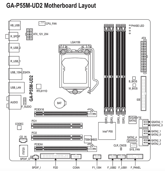

Hello everyone, i have a question but not sure if it's worth doing or even smart. I own a Gigabyte GA-P55M-UD2 MOBO that only has USB 2 headers and my GF bought me a case on christmas which is the Cooler Master CMP 520 ARGB which has USB 3.0 and 2.0 in front. However the front panel 2.0 port has compatibility issues with the MOBO meaning some USB sticks do not get recognised and some half work (only with the 2.0 as i don't have a header for the 3.0 port).
The question is the following (and not sure if what i'll say exists) but is it worth buying a USB controller with a USB 2.0 and 3.0 header on that controller that connects to PCIe and at the back of the card there are USB 3.0 ports? Does that even exist? Meaning the front case panel USBs (2.0 and 3.0) connect to that controller and having extra 3.0 ports at the back of my computer, would that work and does exist?

I assume you checked how much space you have, by the way? Reason I mention that is because if you have plenty of space under the graphics card you could try looking for a PCI one which might open your options up.
A local store has one which is PCI & USB 2.0 and it is like $2 brand new in a box.

8 hours ago, AleksiDj73 said:
Could you please elaborate? I didn't understand sorry
They are asking if the remaining PCIe slots are still accessible, or if they're obstructed by whatever graphics card and capture cards you have installed.
I didn't know why you're specifically looking @ PCI-Express cards, but I assumed the reason was because your other expansion slots are being blocked by a graphics card, since they're immediately underneath that slot.
Your other expansion slots are both PCI and while this is now obsolete and rarely present on modern boards, there are still quite a few USB 2 cards available for PCI slots and they're often dirt cheap. Like I said, there's a store here that has USB 2 PCI cards for just $2, BNIB.
If your PCI slots are blocked by a graphics card then this is obviously irrelevant.
Oh shoot lol i forgot to mention either pcie or pci is fine, not ONLY pcie
On 5/22/2024 at 6:30 PM, saintlouisbagels said:
Ah I was confused by what you were saying too - I forgot there was a difference between PCI and PCIe.
It looks like OP should be fine with getting either PCI and PCIe. I doubt he is somehow using a fat graphics card that overlaps both of the PCI slots... he is using a USB 2.0 motherboard after all lol.
i got a 1050 ti so defo that pci1 is covered by the gpu. and as i said above i forgot to mention either pci or pcie is fine
