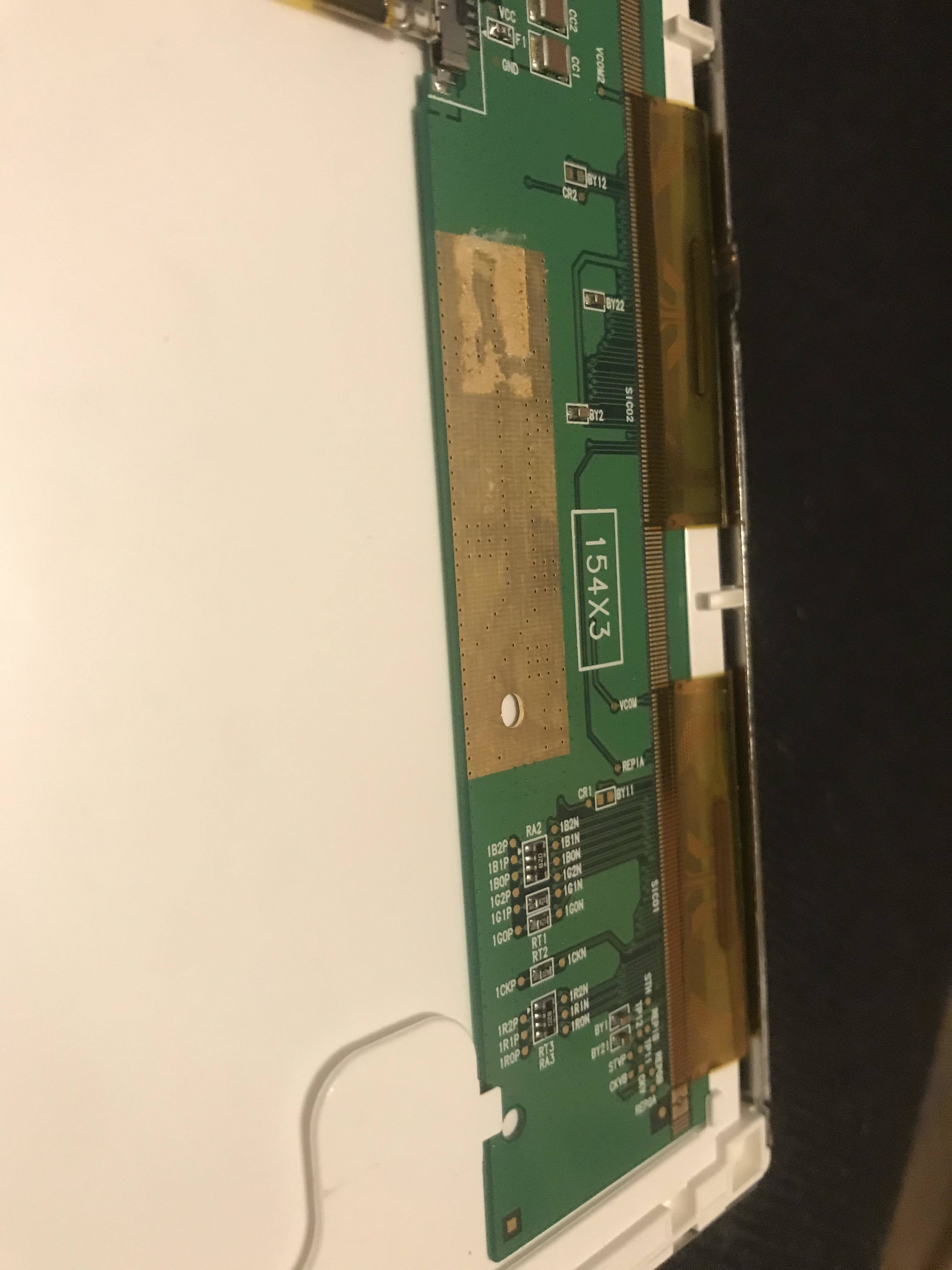

Finding the right screen driver

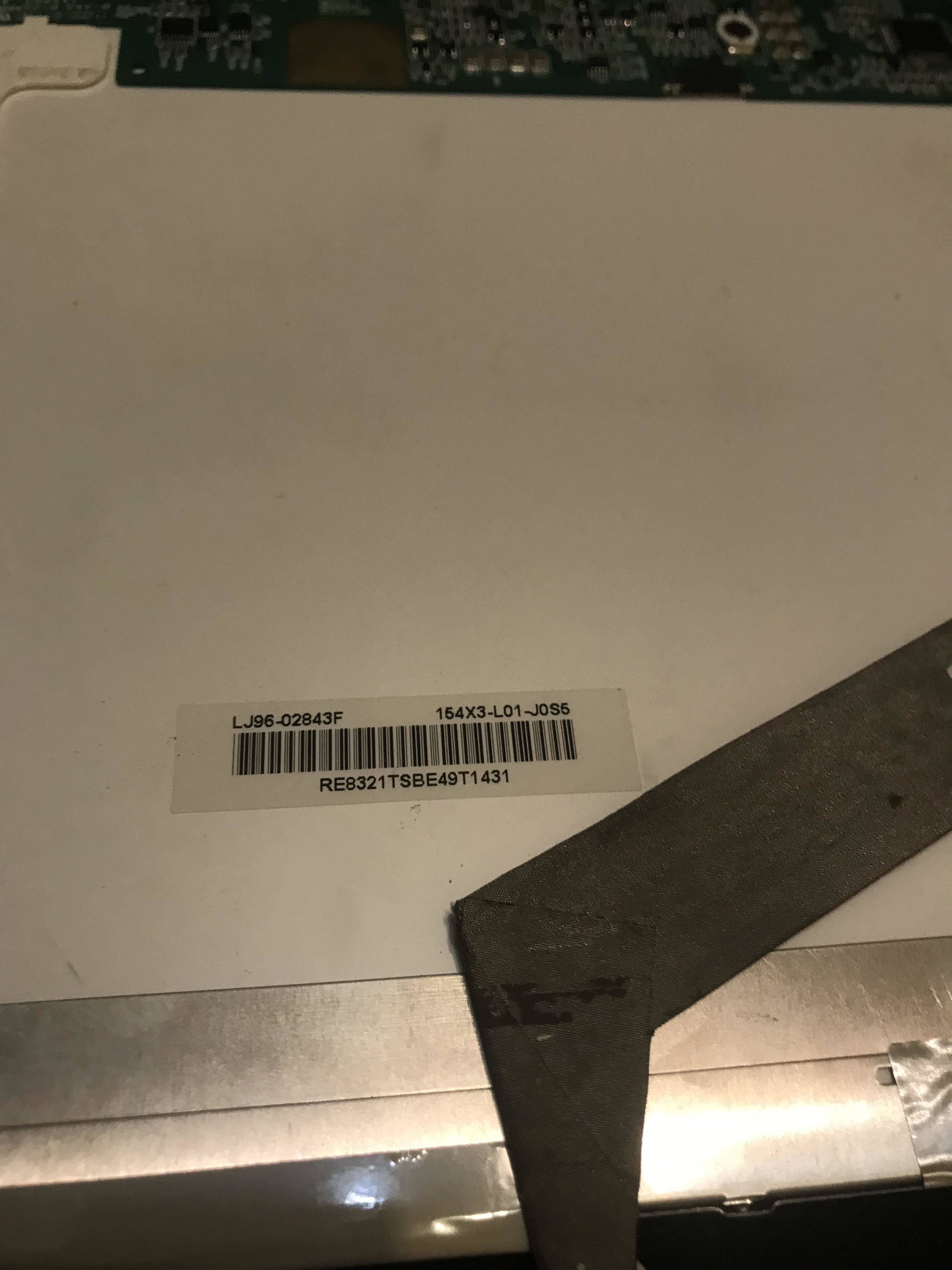

My guess : Samsung LTN-154X3-L01
Datasheet: https://www.beyondinfinite.com/lcd/Library/Samsung/LTN154X3-L01.pdf
Page 14 :
5.1. Input Signal & Power LVDS, Connector : (JAE, FI-XB30SL-HF10or Compatible)
Mating Connector :(JAE FI-X30M or Compatible)
You have 19 pins there in a 30 pin connector. 4 LVDS pairs, voltages... easy to rearrange wires if needed.
Hit eBay and search for "lcd controller board LTN154" , use LTN-154 as well.
You may find LTN154X3-L03 instead of L01, I'm 95% sure it's compatible..
example links:
20$ (vga input only) Lvds Controller Board LCD Driver (2270) Inverter Kit for 1280X800 LTN154X3-L01
18$ (vga input only) Lvds Controller Board LCD Driver (2270) Inverter Kit for 1280X800 LTN154X3-L01
22$ L01 or L03 (you can choose) : For LTN154X3 1280X800 Panel Screen 15.4" HDMI VGA 2AV LCD Controller Board kit
The L02 or L03 would probably work, the pinout of the connectors is the same (looked in datasheet)
24$ LCD Controller Board Driver (HDMI+DVI+VGA) Kit for 15.4" LTN154X3-L03 1280X800
They'll probably all ship to Russia.
