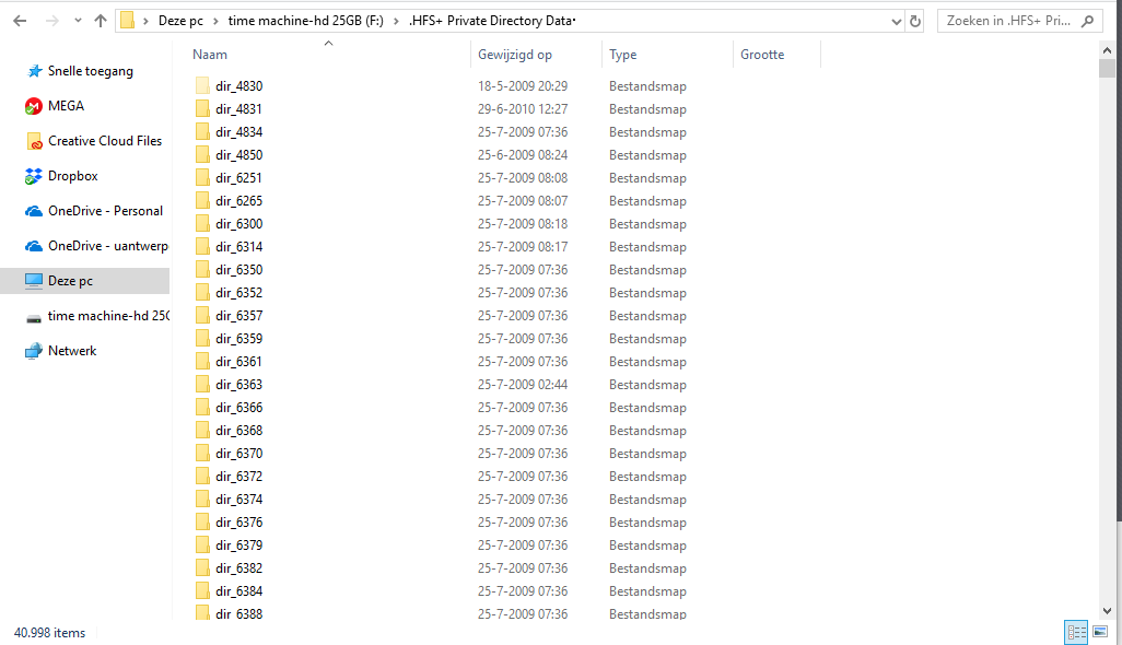

Got into the drive by using paragon hfs+ but all of the files are spread out over 41000 directories. Do you maybe know a program like ccleaner that can analyse the disk but more advanced because ccleaner can find all of the photos etc but I can't select them all and move them all at once to a different folder. Tried deleting them (was hoping that the deleted file would end up in trashbin so I could simply recover it from there and place it into a folder) but it permanently deletes it.

Give Linux a shot. In my experiences these HFS+ translator programs don’t work right half the time...above being an example. And it might not even be HFS+, it could be something else. Also, since it isn’t a Windows compatible file system by default, it won’t have the same recycle bin support, unless you can enable it in the recycle bin’s settings and the translation software supports it.
Linux should see the data properly, as it really is and treat it like how an apple PC would. Just use a live CD/USB to see...it takes like 20 minutes at most.

Tried it, didn't work it still gave me all the different folders.
