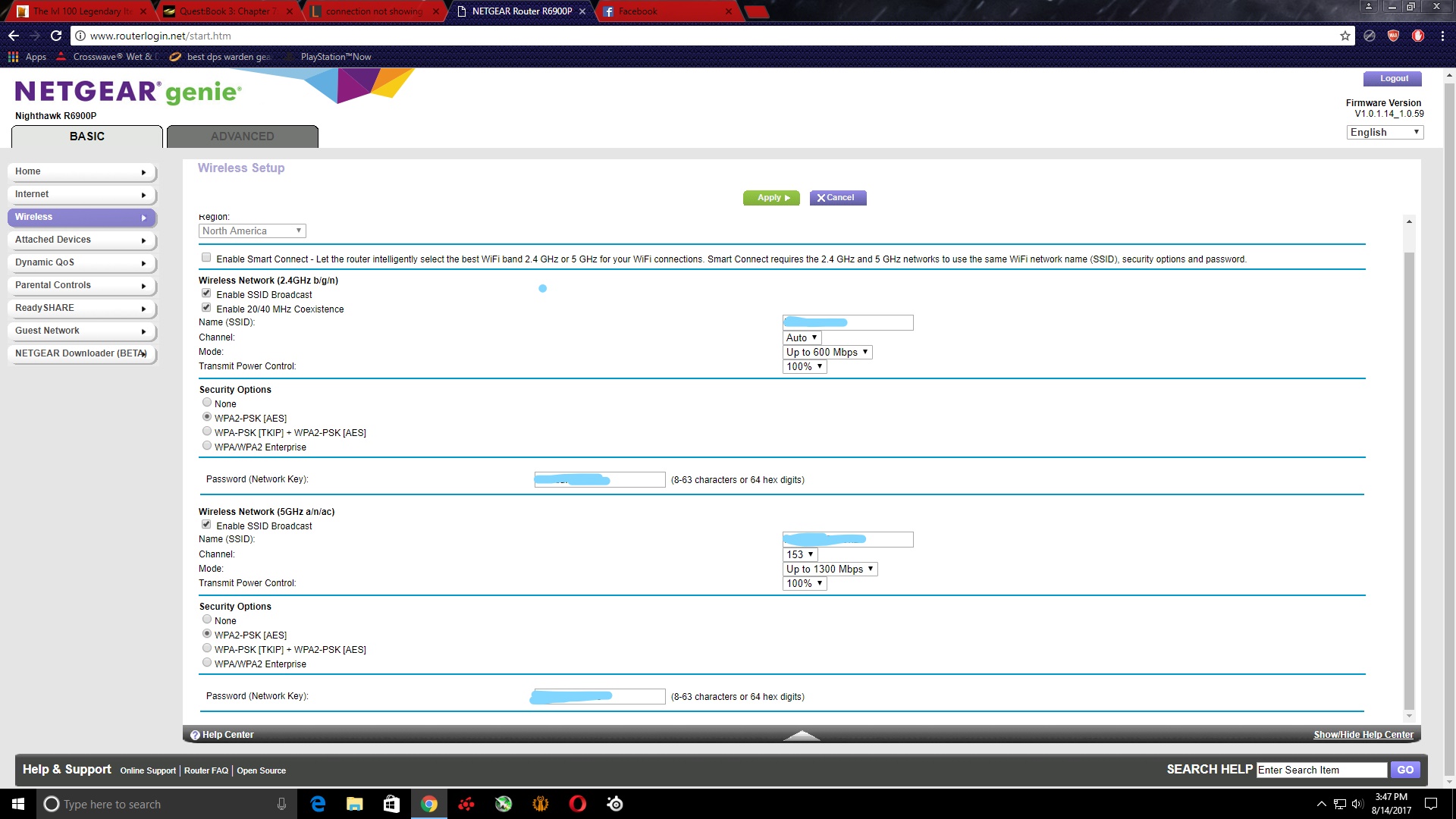

it is enabled i have checked 10 times over, and my PS4 is in my living room and the router is in my kitchen, maybe about 5-6 feet apart from eachother
what are your wireless settings for 5 ghz? (if you're taking a screenshot crossout your SSID)

1 minute ago, Dogsparky said:
-snip-
try updating the firmware and test it out

1 minute ago, Gungpae said:
where on the router login page does it show 20/40? has it for the 2.4 Ghz but not for the 5, won't let me set it like that it is a little check box either allowing 20/40 or it doesn't
https://linustechtips.com/topic/822063-connection-not-showing/#findComment-10300834
i believe changing the Mode: to 289mbps makes it 20

34 minutes ago, Dogsparky said:
so change the mode to 289mbps and connect to the 5Ghz wifi or see if it pops up?
yes
