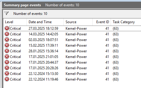

Consistent crashing every 2 weeks

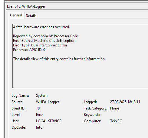

8 hours ago, TekkyEntity said:and this time i was also given a BIOS CPU overheating warning after the system had rebooted itself
If it reboots while ingame or some other CPU load, that's "normal". It doesn't know that it was a restart, it thinks that the CPU hit that temp in the 1-2 seconds it takes to POST. This temp threshold is much lower than an actual problem temperature, like 60-70°C.
8 hours ago, TekkyEntity said:after the system turned on i confirmed through HWMonitor that the temps were slightly below 90C (only CCD #0 actually reaching 90.0C though), but temps slowly dropped to 60C afterwards due to the system not doing anything.
It shouldn't shut down at that temp. So my main suspect would be a faulty CPU. You can of course try changing something with the cooling situation, but I don't think it's the cause.
