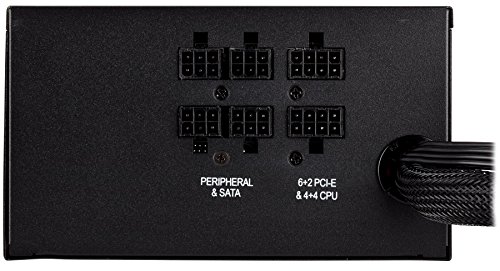

One annoying thing is that my PSU doesn't by default have a cable for the 4 pin power, so I would have to buy one (I had a brief look and was a bit overwhelmed with what I actually needed). My PSU back looks like below - would the cable connect into one of the 8 pins and then the other end would be 2 separate 4 pin (that can connect together) which I would only use half of?

Yes that's correct, you can use an 8 pin (as long as it is 2 x 4) and just use half of it.

I have bought https://www.ebay.co.uk/itm/CPU-8pin-to-4-4Pin-EPS-power-supply-cable-ATX-for-corsair-RM1000x-RM850x-RM75/223665968176?ssPageName=STRK%3AMEBIDX%3AIT&_trksid=p2057872.m2749.l2649 which should come before the 30th. If using it doesn't fix the issue then I guess I would look at RMA'ing the motherboard, would my issues be a worthy reason to get a replacement?
