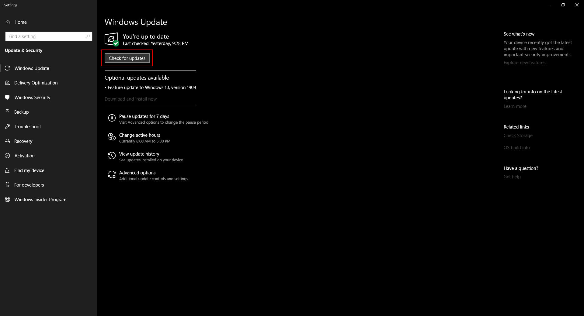

Try updating Windows too:
Might be a long process, but sit back and let it do its thing. Then go back after everything is done and do the whole DDU process. Then install new drivers.
hit that download and install now for the Feature update to go to Version 1909. But truthfully, you would be better off creating a new USB install and doing a fresh install of windows at this point to ensure you have literally everything covered.

Update Windows (as mentioned by others):
https://support.microsoft.com/en-us/help/4027667/windows-10-update
Well i fucked up my windows update and it is not working (it is my brothers pc and he does not want to get windows update shits so i disabled it after installing windows and when i try using windows update assistant it wants to delete my files soooooooo yeahhh
