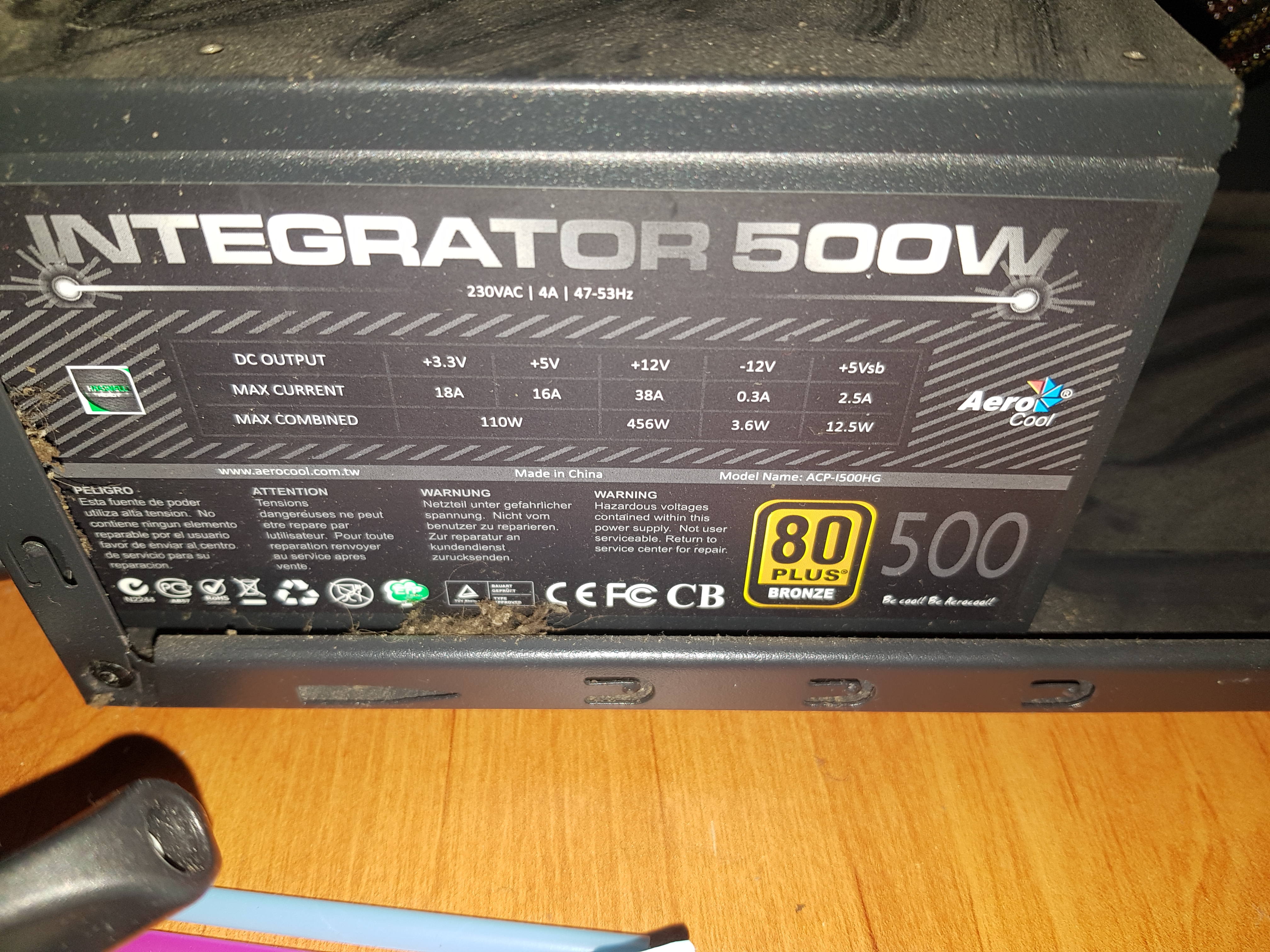

8 minutes ago, d00m1ord said:
500v psu
can we get a model?

5 minutes ago, d00m1ord said:
it's nothing special but it's viable at least, although an upgrade would not hurt down the line.
