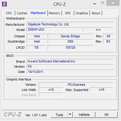

So I looked for other ways to change/control the fanspeeds, which can appereantly also be done in the bios. sadly though ever since that installation of speedfan, i can not access the bios anymore. 2b5aecc02c423847c4344575e06c7d78.png

thats exactly where they are plugged in, but as I mentioned I can not acces my bios. It just doesn't load it up.
and what I believe I didn't mention earlier. The sofware that comes with my Gigabyte Motherboard called Easy Tune 6, doesnt do anything either either. no matter if I set up a dynamic fan curve like the 2 on the left, it doesnt affect the fans at all. or if i set up the rpm for the fans in it manualy. they always turn at the same speed and are incredibly loud.
