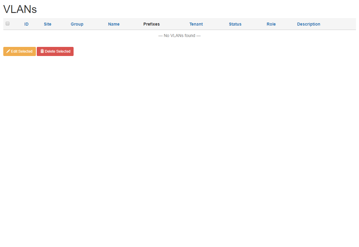

and now from the Netbox point of view:
after running the netbox function I've created to pull the vlans from a cisco switch, and then use the API to create these vlans in the VLAN group called 'Python-test-netbox':

(obviously filtering out VLAN1 and 1002-1005 would be best but this is a just a quick dirty function to show some basics with python automation and networking/inventory purposes)
