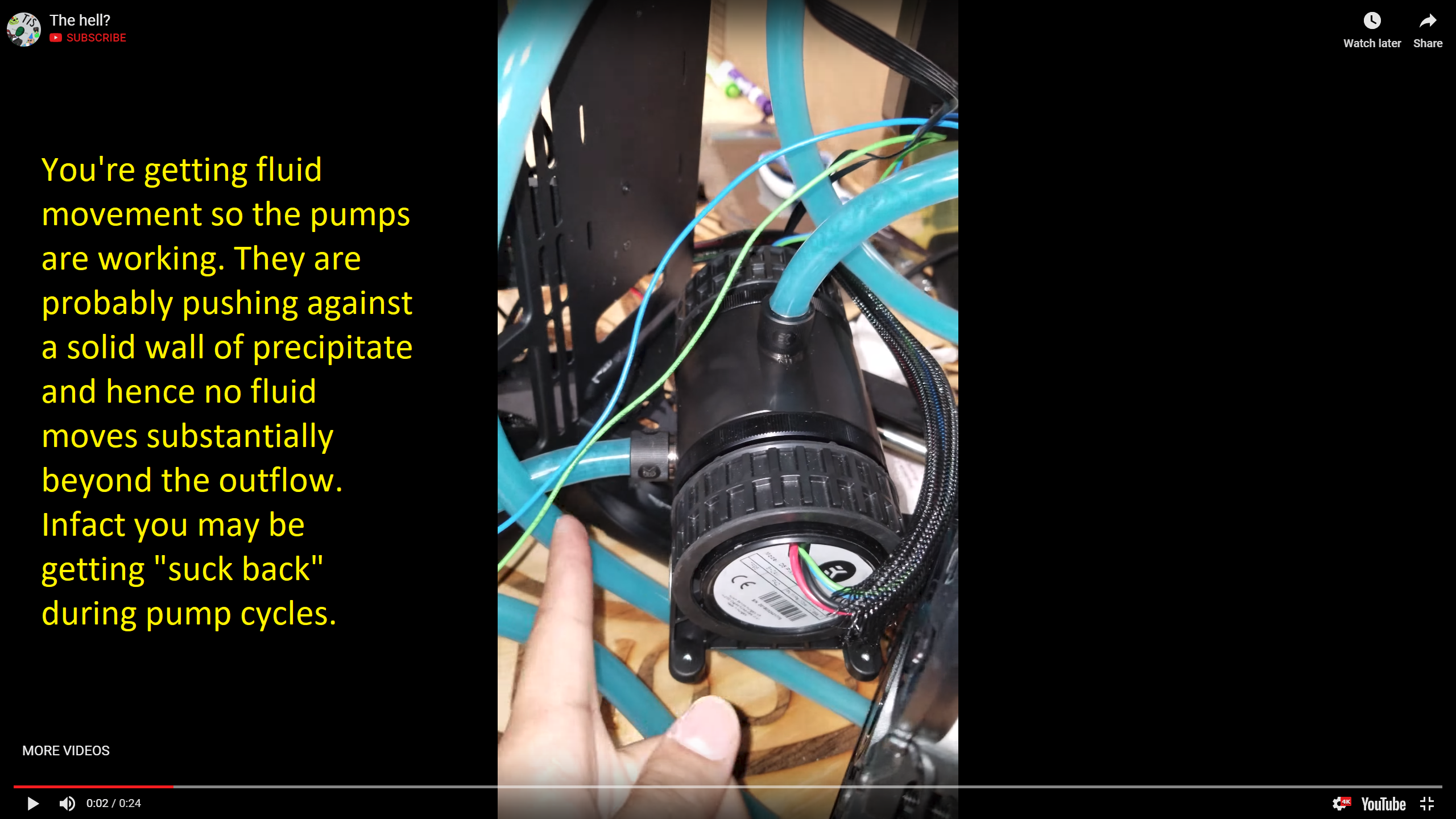

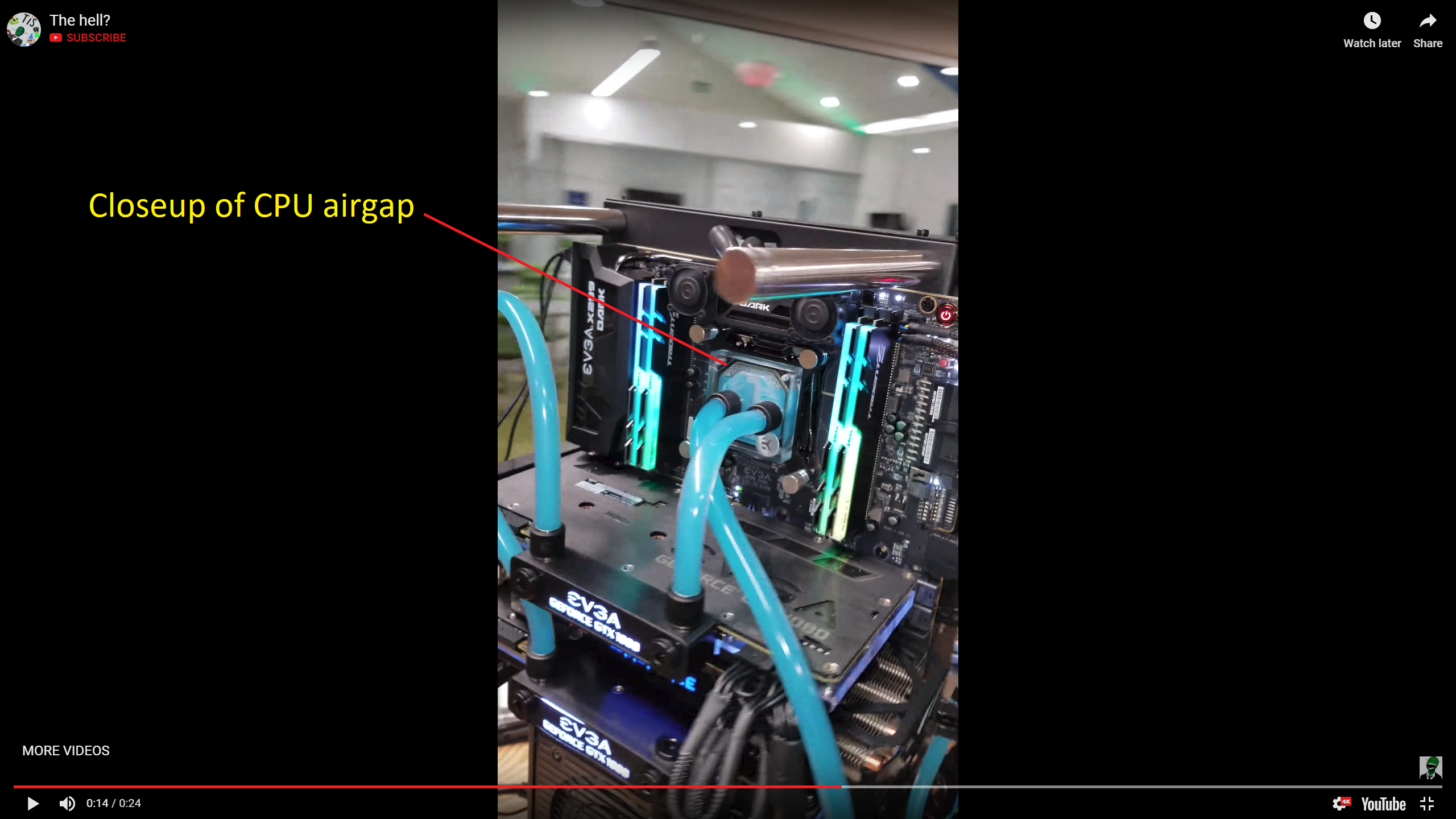

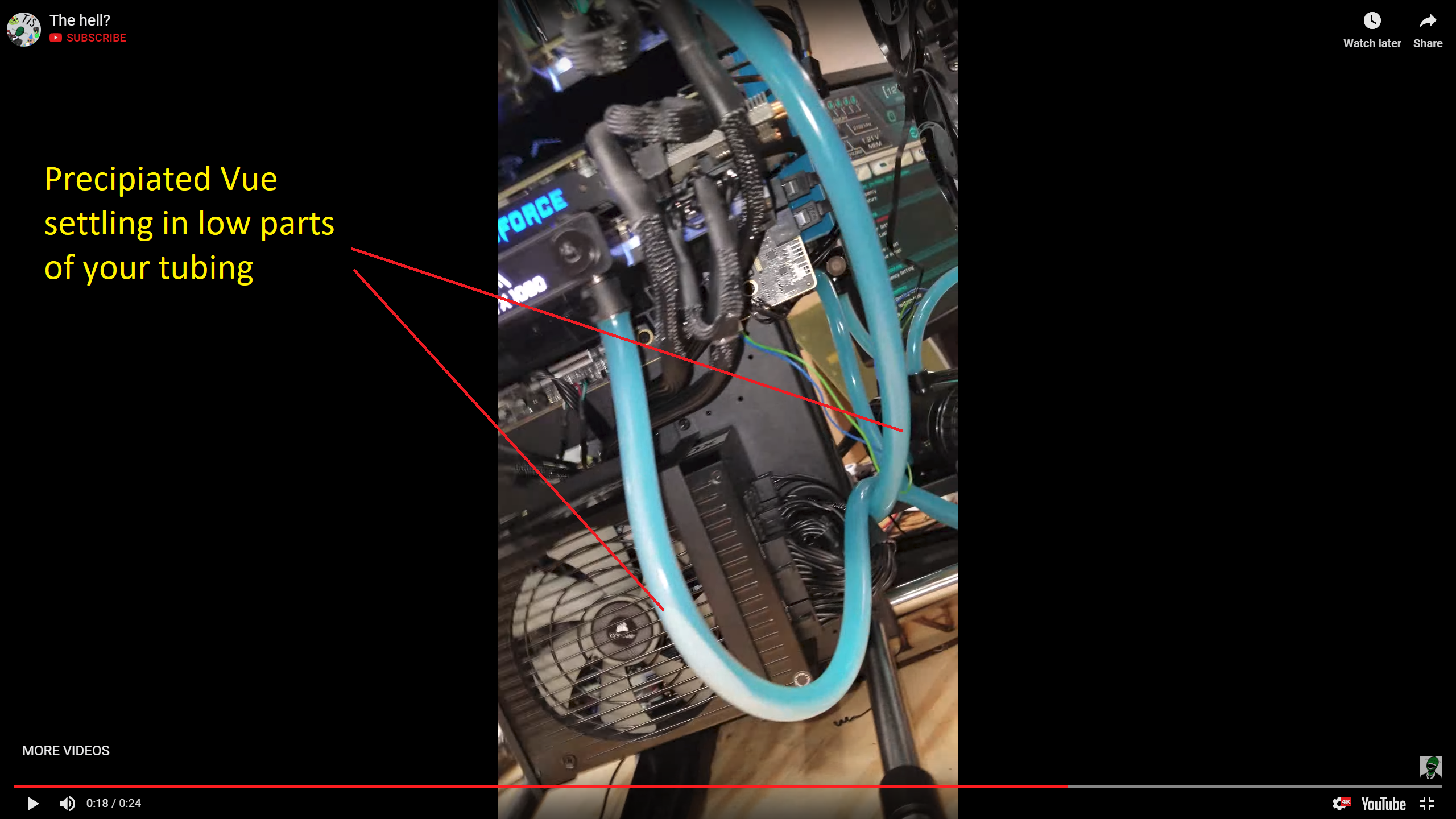

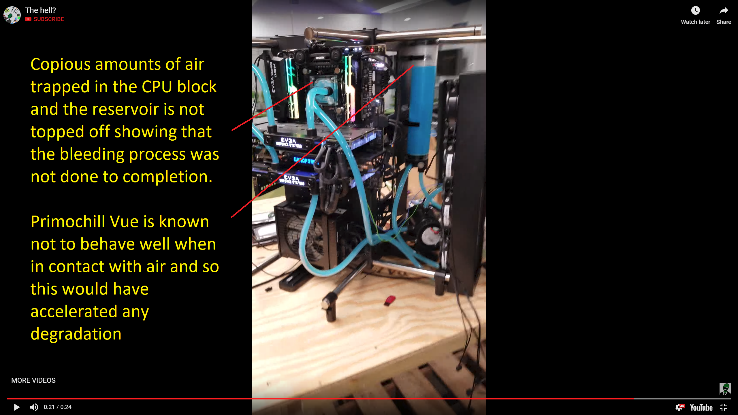

As mentioned, it is unlikely your pumps are working against each other. I reckon you just have a slight reduction in flowrate and visuals by the Primochill Vue starting to misbehave. I wouldn't try to determine the direction of flow by visual inspection of a rheoscopic fluid, it can be confusing particularly close to the pump where its "sucked in".
Going to 100% Duty cycle and making sure you don't have really bad clogs in your blocks would be my recommendation.

No, teardown the system, open the blocks, clean the blocks, use a fluid that is not just a show fluid, and then re-test.
I would say your system is in quite a dangerous state if a block is clogged to the extend that it is cause fluid to go backwards during pump cycles. This means if any O-rings give up, you're in for a massive fountain. There is plenty of good reason to believe your Vue is in super bad shape, I would recommend you clean your system immediately and choose a more sensible fluid for the application.

What he is saying is this.
Tear it ALL down. Open up the blocks and clean them out. Take out the rads and flush them with boiling hot water and then do the rad dance. Consider tossing the tubing and using all new. After you have cleaned out all the components to the best of your ability then run a cleaning solution that is safe for your setup for 24/48 hrs. Then give it a good flush with distilled . After you have done all of that, fill it with a NORMAL coolant. No show fluids like vue, they are only going to cause issues. If you want someone with nano-particles  then consider something like pastel, but that is about as fancy as I would recommend going.
