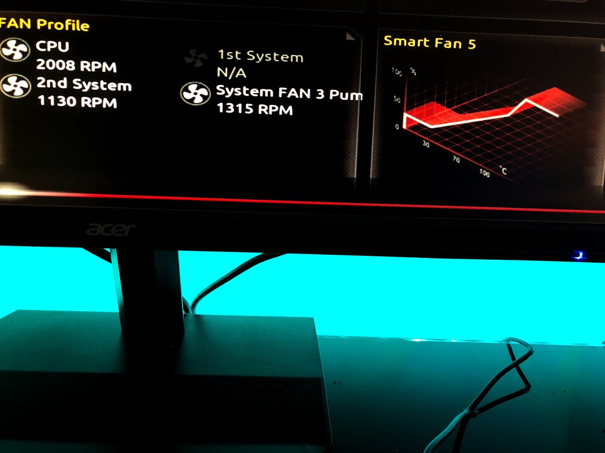

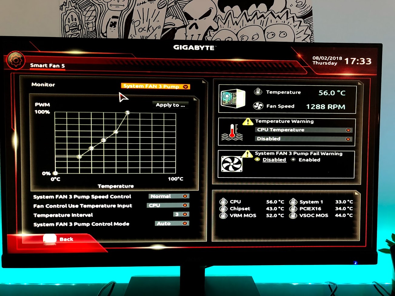

This is what I'm getting in the bios, what to change i still don't understand
Smart Fan 5 is what's used to control fan settings. Go to Classic mode and it should be under the M.I.T. section.

thank you, there was a silent option for the fans in smart fan 5 that I turned on for my system fans and I'm gonna see how that does for the noise. just one more question if I put my CPU fan to silent will it affect performance?
