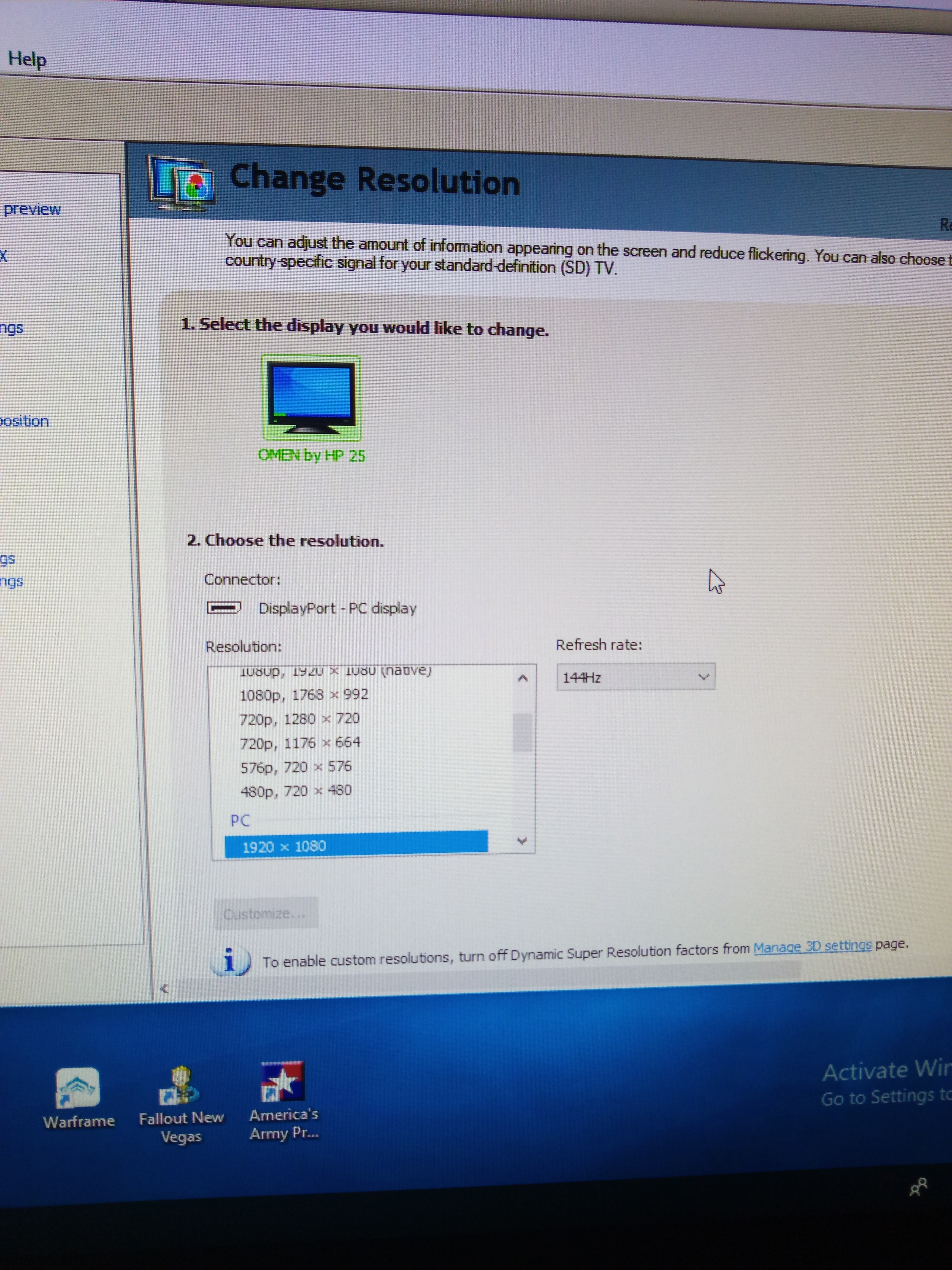

I posted a pic of that please go back and take a check for me lemme know if it's right

No, of the resolution section in the Nvidia Control Panel I meant. But if Windows reports 144 there's a good chance it is running at it. Definitely try @Glenwing's suggestion.

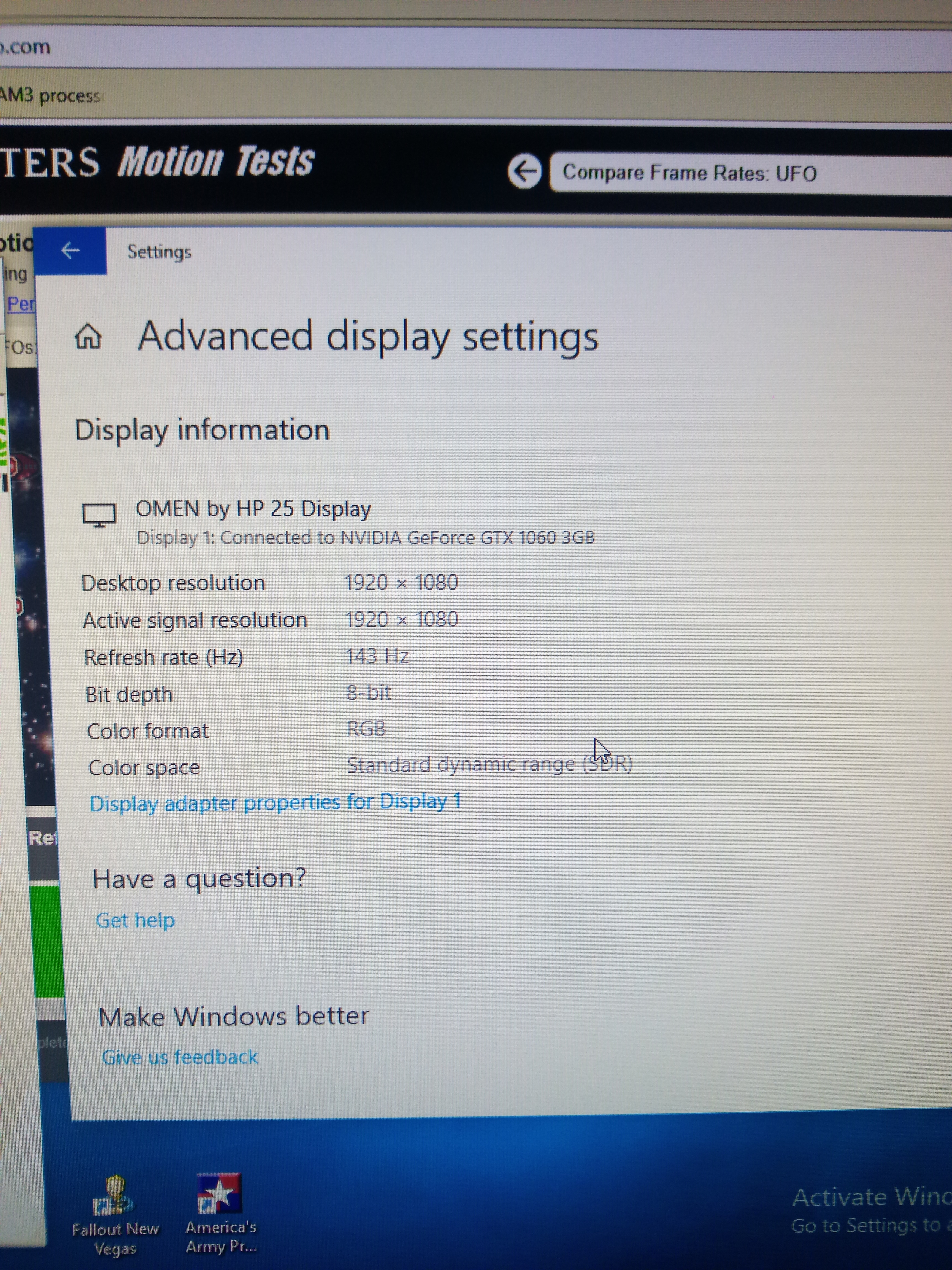

Yeah I think it is running at 144 or 143hz cause both windows and nvidia report it

Well you are running at 144 Hz. Another crude test can be to just put the monitor to 60 Hz, open an explorer window and drag it around. Do the same at 144 Hz, you'll probably see a difference.
