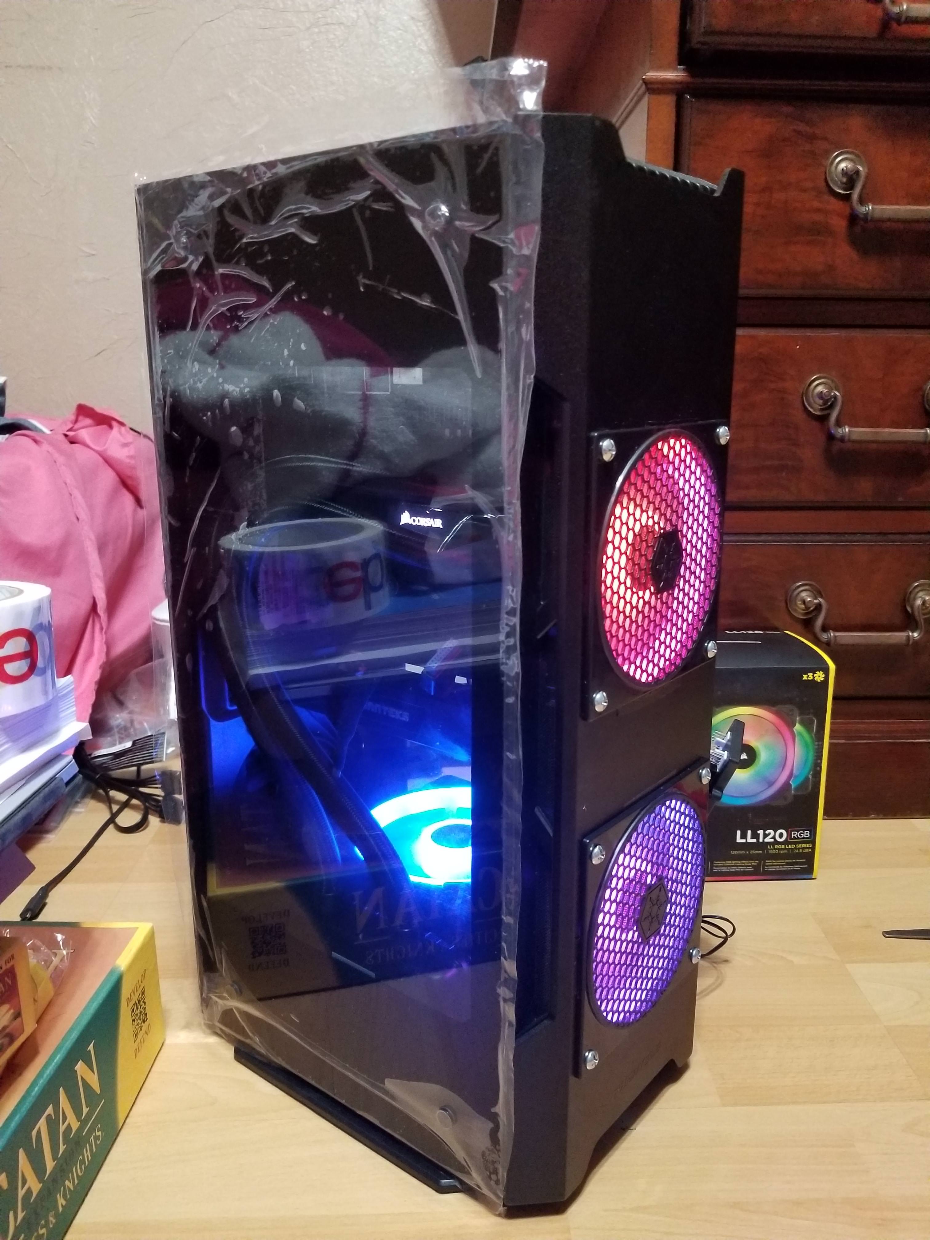

Just so you know, every single comment you received is not valid due to the airflow restrictiveness and size of this case. Except for @Damascus, except you're going to have a hard time fitting a 140mm AIO inside of this case. Which is why I went for a 120mm.
The case will get hotter faster and with little to remedy the problem. This is why this case is a high 80s case. You can add a custom loop in there and it still would not break into the high 70s. This is because you constantly have negative airflow no matter what and no way to exhaust the heat (not that you had much to exhaust in the first place). Even if you use the top fan as an exhaust. The mesh layer on the top of the case you're going to want to take off so heat can be exhausted better due to no top fan mount. But you're trading that for more possible dust in your case. However, since this case is negative airflow no matter what, you're already sucking in dust.
Sure you can have a thicker radiator which will cause your temperatures not to rise as fast. Then what are you going to do once the radiator reaches equilibrium? By golly, your radiator will reach equilibrium fast in this case. You're going to get a higher temperature because you're constantly deprived of air to cool the radiator which is why temperatures for this case are in the high 80s. Sure you can add a stronger fan to the radiator but it's not going to do much since it is so restrictive and if you use it as an exhaust you're just pulling out more air in the case that you don't have.
I would suggest you to remove the side mesh from the front panel that captures dust. This will greatly increase airflow. Remember this though, high 80s is still fine. Of course you're going to want your temperatures much lower than that. This case is completely safe. But do as I recommended and you'll get much better airflow in and out of your case or don't do it. It's up to you not other people.
TL:DR; remove the top mesh and the front side meshes for better airflow. I have already dealt with this case and tried out all possible logical approaches. Adding in bigger radiators and stronger fans won't help you since you have very little air to push/cool. Which is why I opt'd to mod the front panel for airflow.

Just to be clear -- is the poor airflow case the EVOLV or the Core 500? I'm in the market for a mini-ITX build and airflow is a concern due to where the case may be placed (on a shelf or behind a monitor)
I was specifically talking about the airflow for the Phanteks Evolv Shift. The Core 500 looks like it would have much better airflow because it has 3 fan spots that are unimpeded for airflow.
