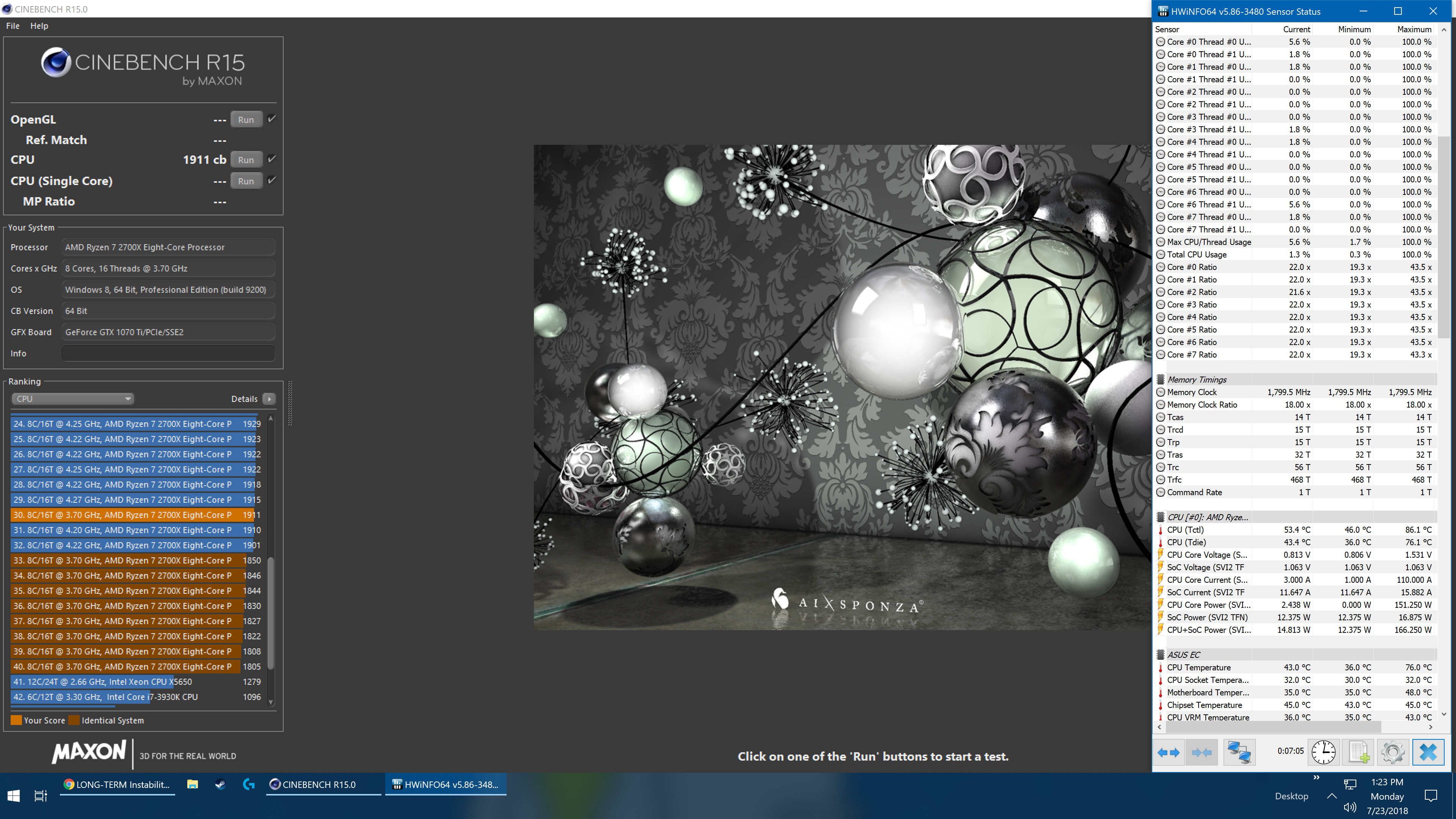

Here is an example of what to expect using Cinebench.

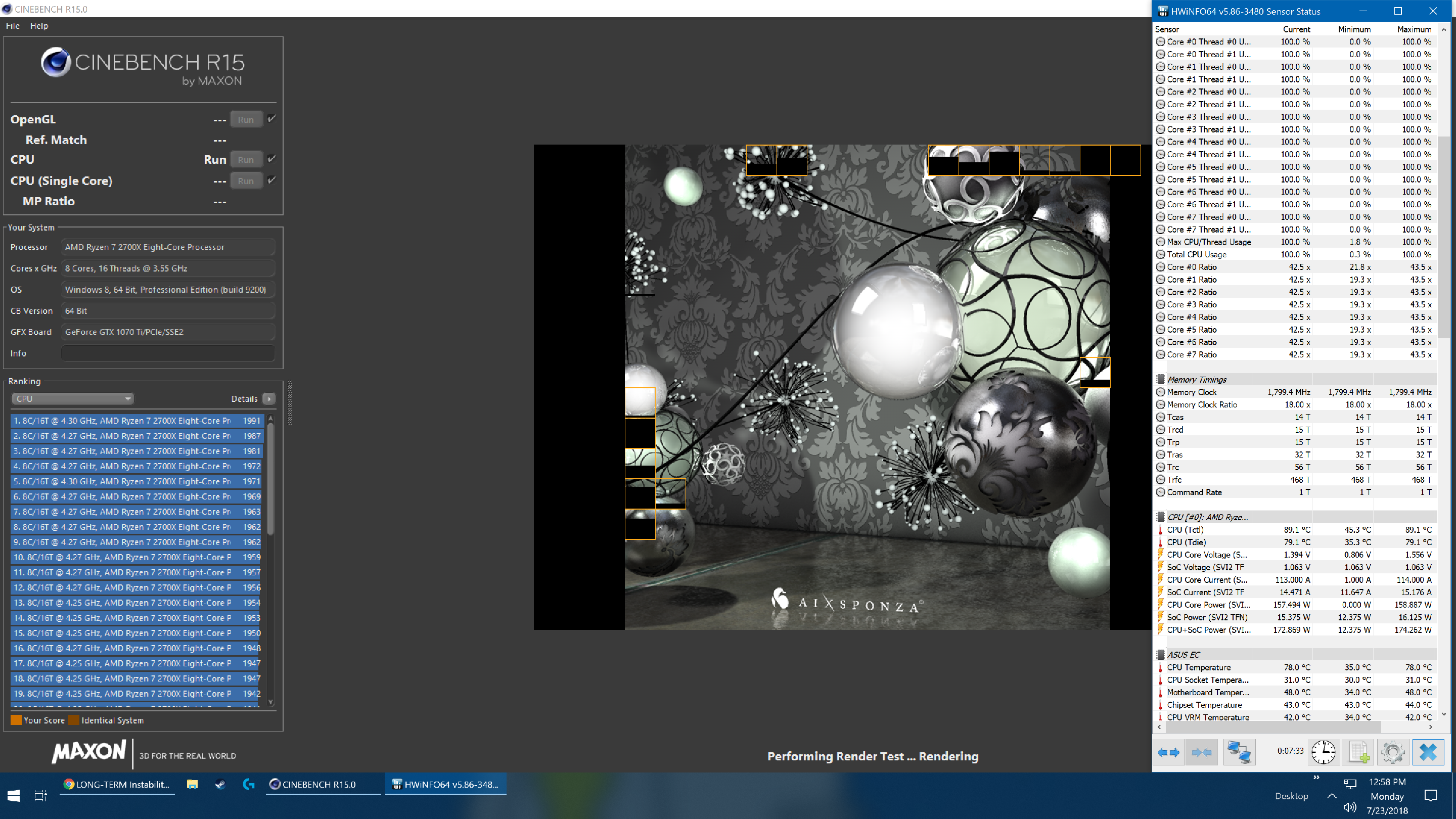

Another Cinebench example:
With this run I used the Performance Enhancer Level 4 (This is a pre-set setting specific to the Asus Crosshair VII) and combined it with a voltage offset of around -.017v (I can't remember precisely). I am using the offset to try to bring down temperatures.
In that Cinebench screenshot the score in 40th place is completely stock CPU speeds with overclocked RAM. The score in 30th position is the run with the above described settings. You can see the score in 30th is listed at the stock 3.7GHz. Keep in mind that the score would be higher without HWiNFO64 and Chrome open. You'll also see the max temp in HWiNFO is lower than the previous screenshot I posted because of the undervoltage I applied (or at least I think so).

Ahhh I thought you would ask about that. If you scroll up there is a screenshot I took during the run where the CPU was running at 42.5 and the core temps were 79.5*. I am running a 360 AIO and I believe the minimum you should use is a 240. I say that, but I have never seen anyone use a 120 on a 2700X so it may work for short periods, but I would recommend going 240 at the minimum.

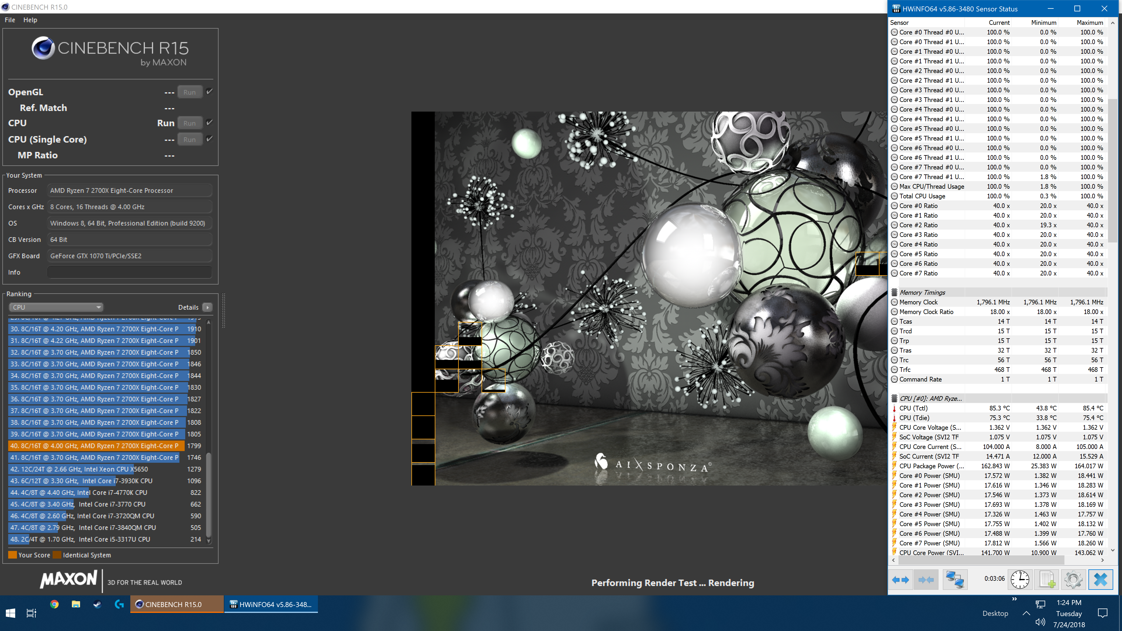

Lemme check a 40x at 1.36v for you. I will be back with that answer.

This is a screenshot after about 8 back to back runs. It maxed out around 75.4* temp.
