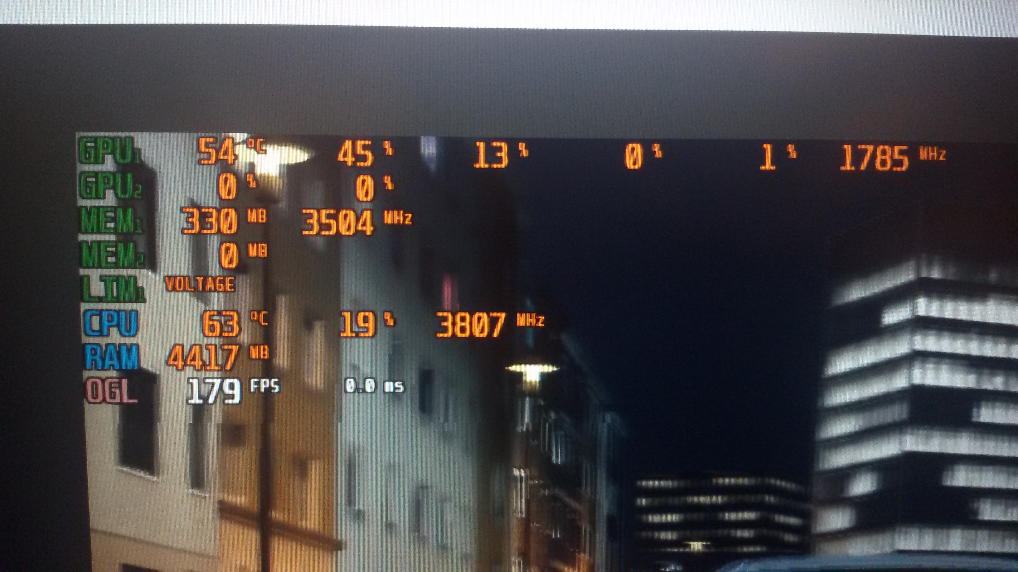

I bought a new laptop 3 days ago. It was without OS so I installed windows 10 pro 64bit. After some time i downloaded a few games and went to try them out. First game were CS:GO and it didn't launch at all. Games like Guild Wars 2, League of Legends, Counter Strike source would run extremely poorly with 5-15fps. My laptop specs are:
GTX 1050 4GB,
i5 8300h,
8GB of ram 2666mhz,
1tb firecuda SSHD.

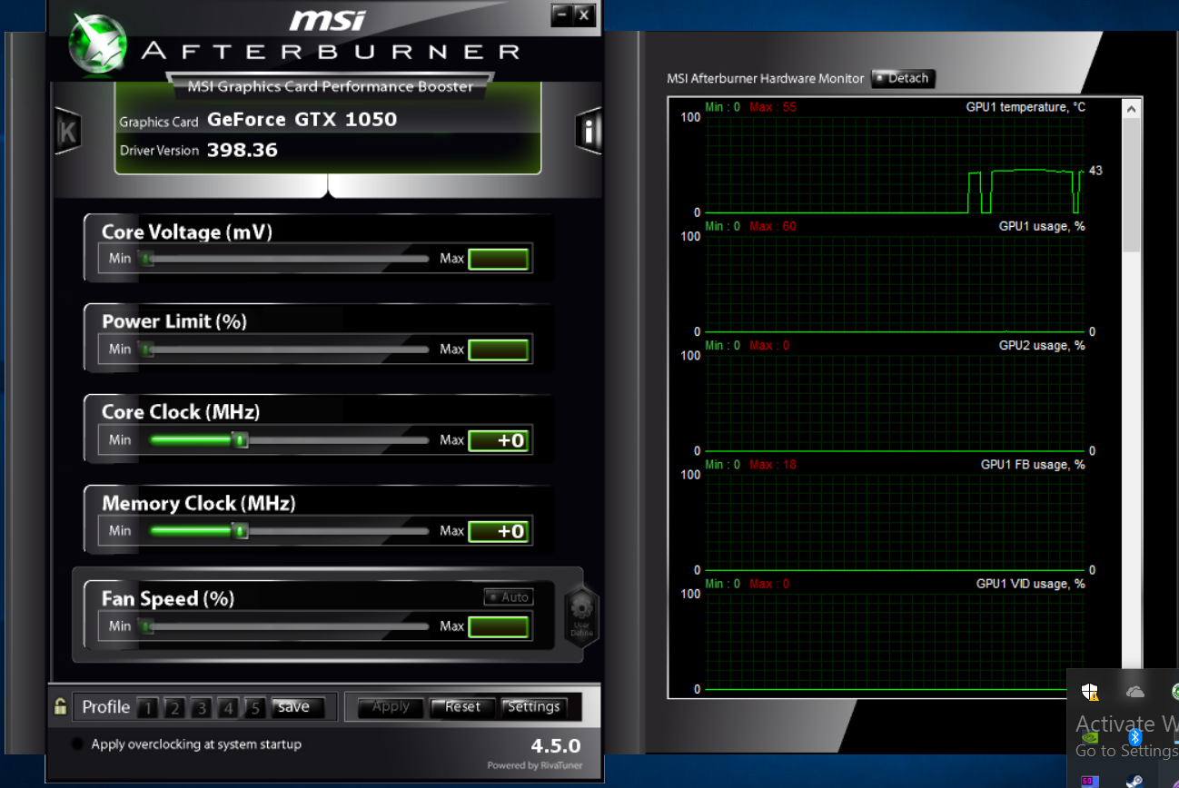

I noticed that in games my gpu usage stays at 0 (yes i made sure that default graphics processor is nvidia card). However in Cinebench while doing gpu test, gpu seems to work perfectly fine. I tried many things to solve this issue but nothing seems to help. Maybe you know how to fix this issue? Any type of help would be appreciated. Here are some pictures:
The games are using the CPU integrated graphics processor.

Nvidia control center isn't even giving me an option so I can't screenshot and provide an example.
