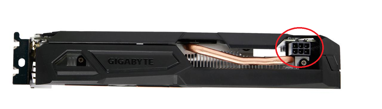

@LookAss Some models of the 1050ti require additional power from the power supply which requires plugging in a cable to the graphics card. Does your card require additional power? You can tell by checking whether or not the card has a plug on either the front or side of it like pictured below.
Its a 1050 Ti Low profile. It doesn't require any aditional power. My pc works perfeclty without the gpu and with the 650. I made sure that every cable is connected properly.
