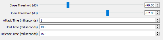

I have been trying to adjust my noise gate and compression settings to filter out keyboard noise while streaming in OBS Streamlabs but no matter what I try it isn't working...

You will need to adjust the "Open Threshold" in the noise gate in OBS. Keep increasing it (moving the slider left) until you find a point where the keyboard noise is not triggering the microphone but your voice still is. You will need to keep an eye on the mic bars in OBS to see what is triggering it and what isn't.
