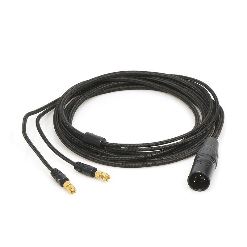

You can get a cable like this one
When you use 1/4in the left and right channels share a ground which causes a tiny bit of static that is so small most people would never notice it. When you run balanced it separates the grounds removing the static. It also allows both drivers to receive the exact same amount of signal, hence the name balanced. Some people don't think it makes a big difference, but true audiophiles swear that is sounds better and will spends tons of extra money on it .
