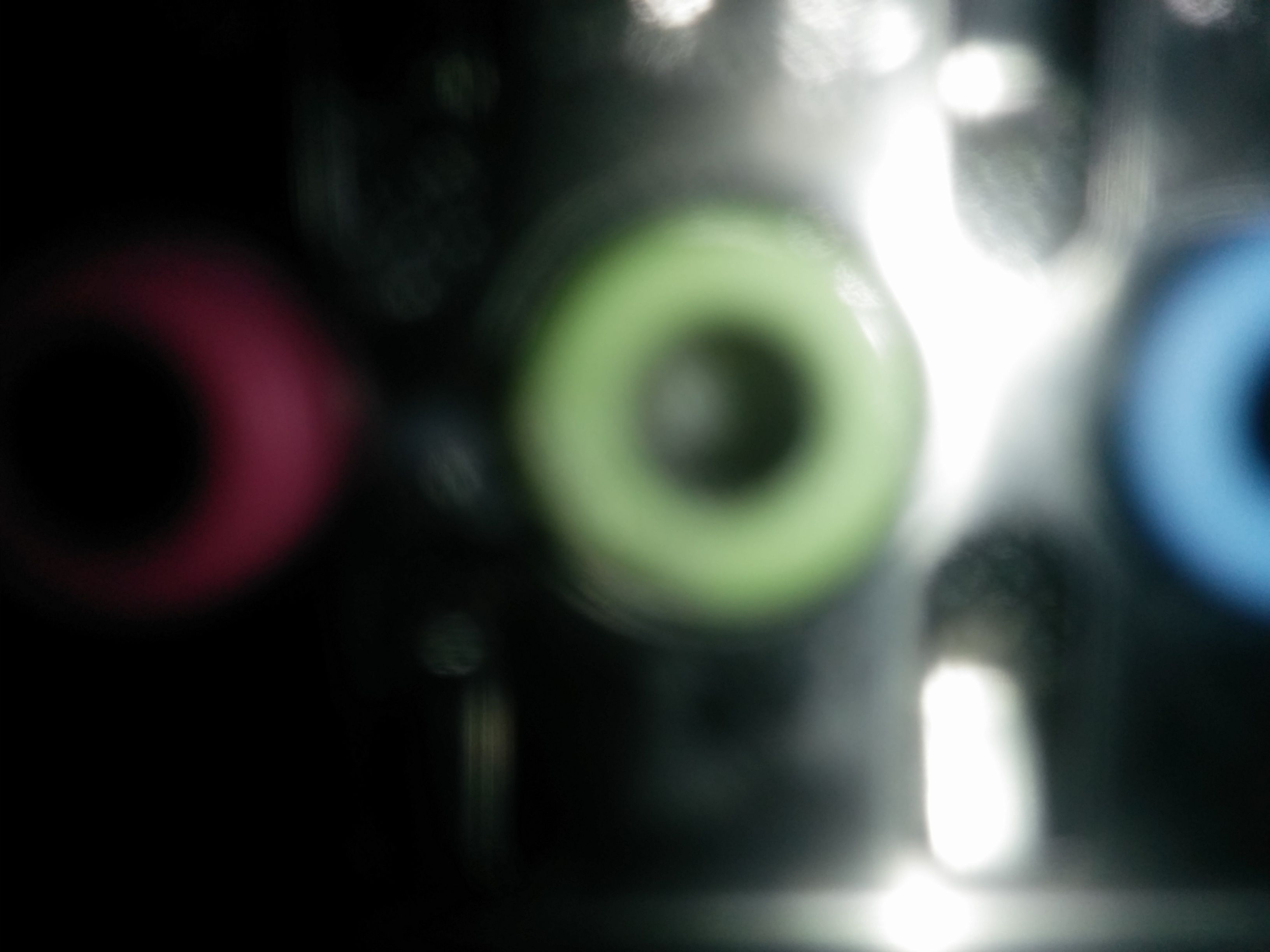

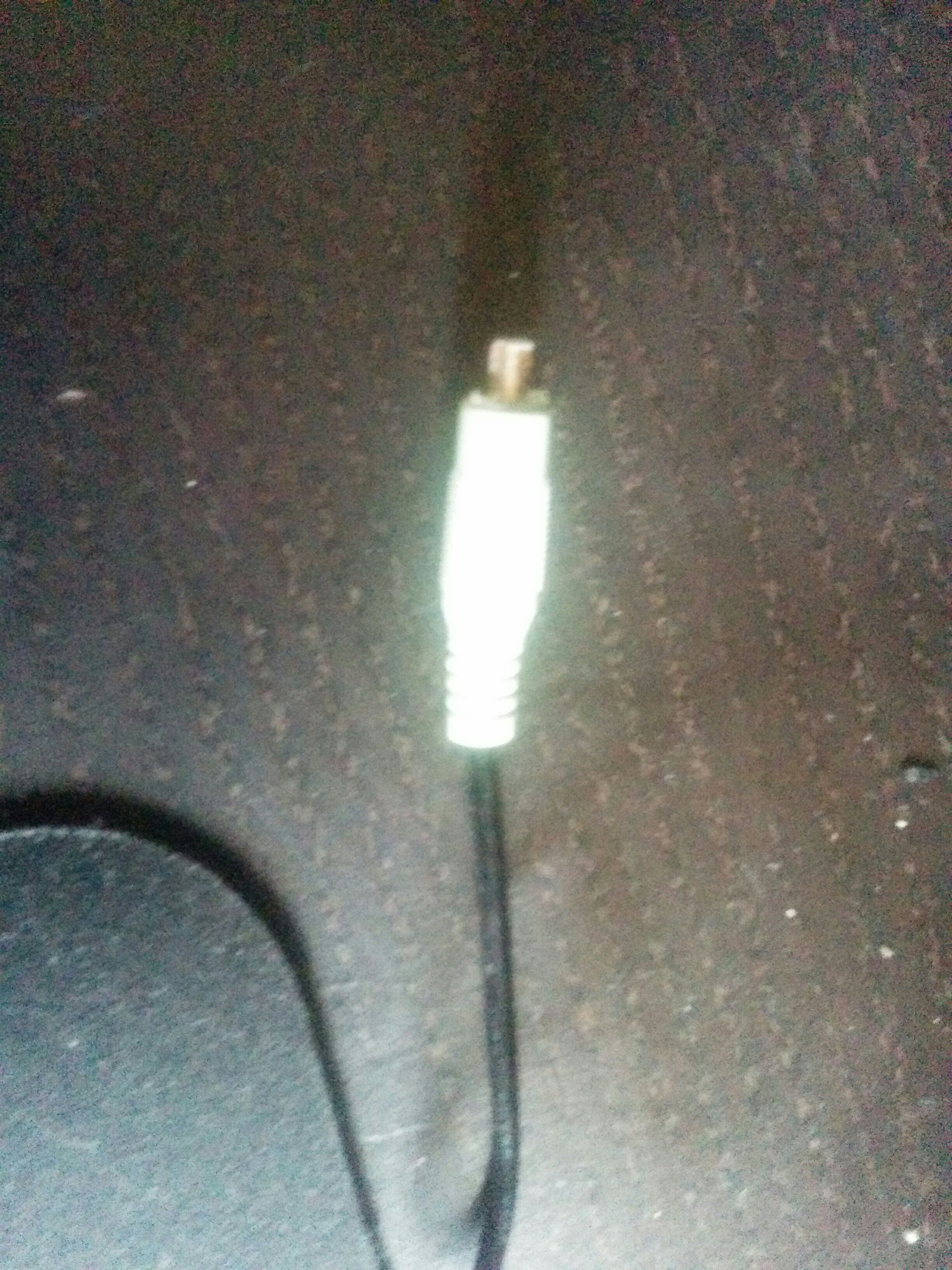

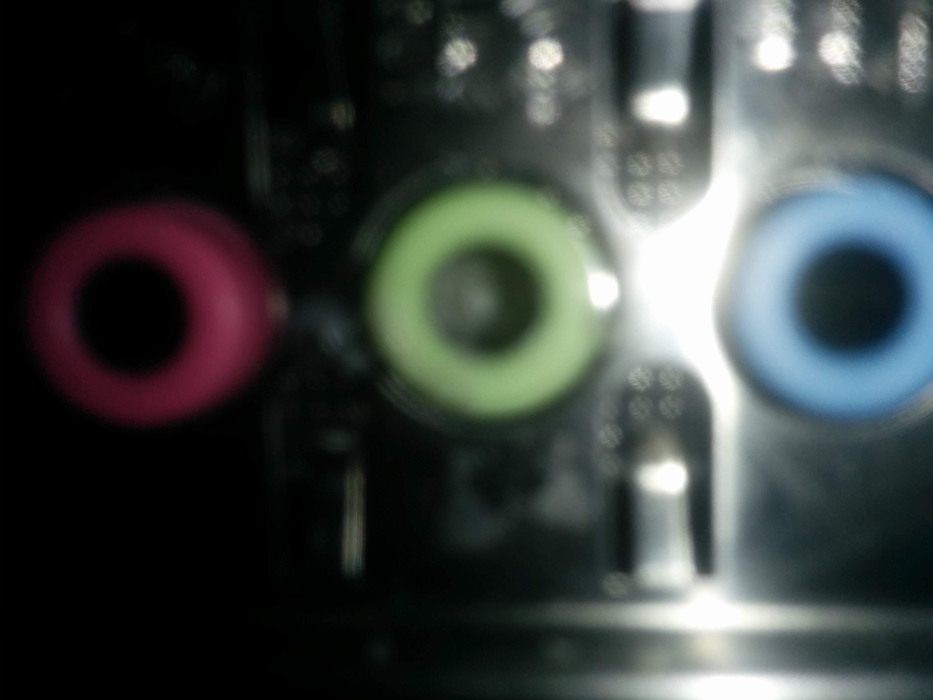

I've uploaded pictures
As I mentioned in the above post, there is a spring like bit of metal that holds the pin in place, deceptively it takes a lot of force to pull it out, using glue will only mess things up even more. Same thing happened to my macbook pro, had to get ti serviced and port replaced.
