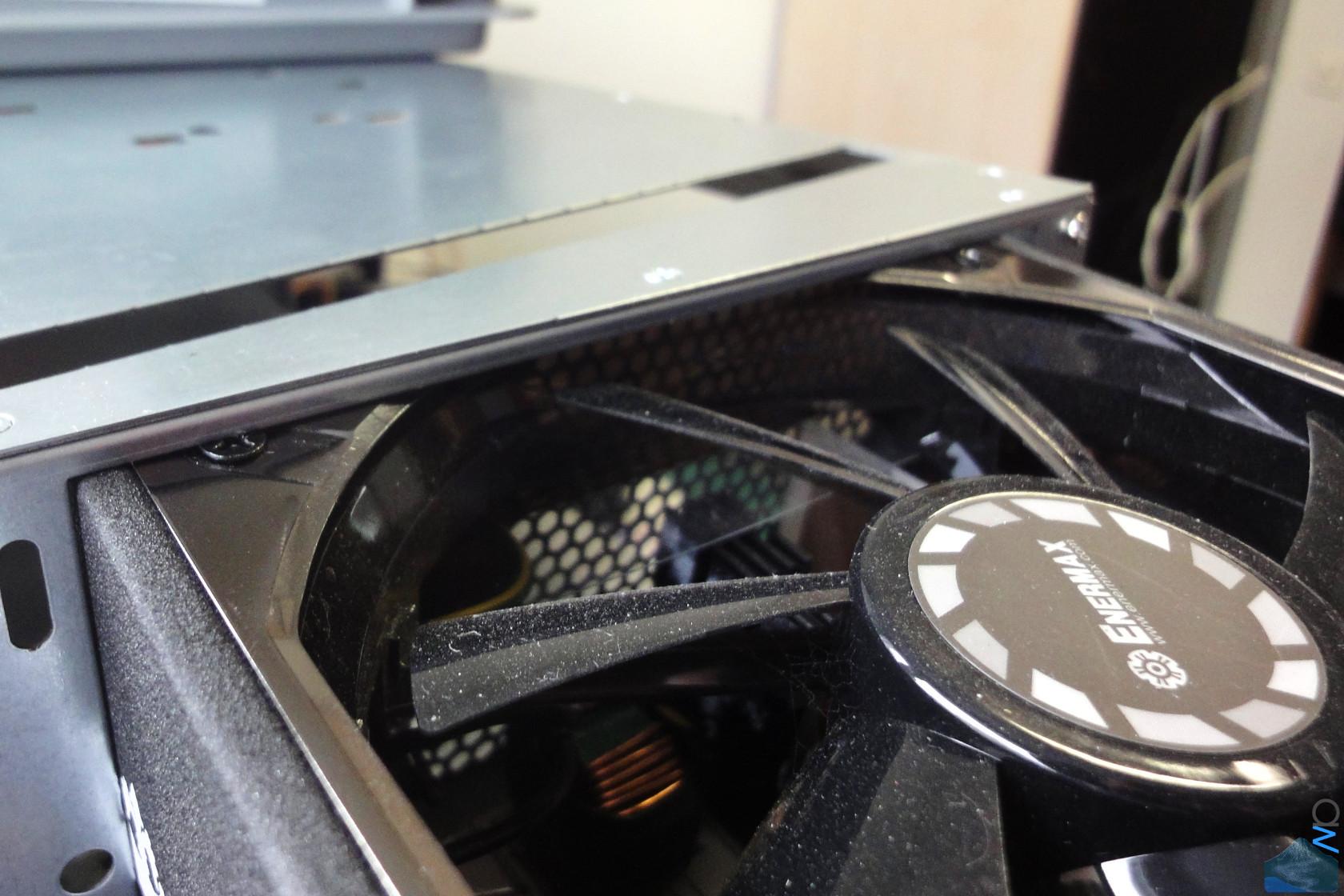

PSU Fitting Issue
The  PSU  slides into  this  case  through an  opening  from
behind,  and since  the case  isn't really  made for  normal
ATX-sized PSUs (but server PSUs instead, it's a rather tight
fit. To be more  specific: The PSU in its  stock config does
not fit,  the screws  for the  fan grill  and the  fan grill
itself bump  up against the  case. An easy fix  though, just
needed to remove the fan grill on the PSU.
(click image for full res)
aw--apollo--2014-04-01--01--psu-bad-fit.
And voilà:
aw--apollo--2014-04-01--02--psu-good-fit
