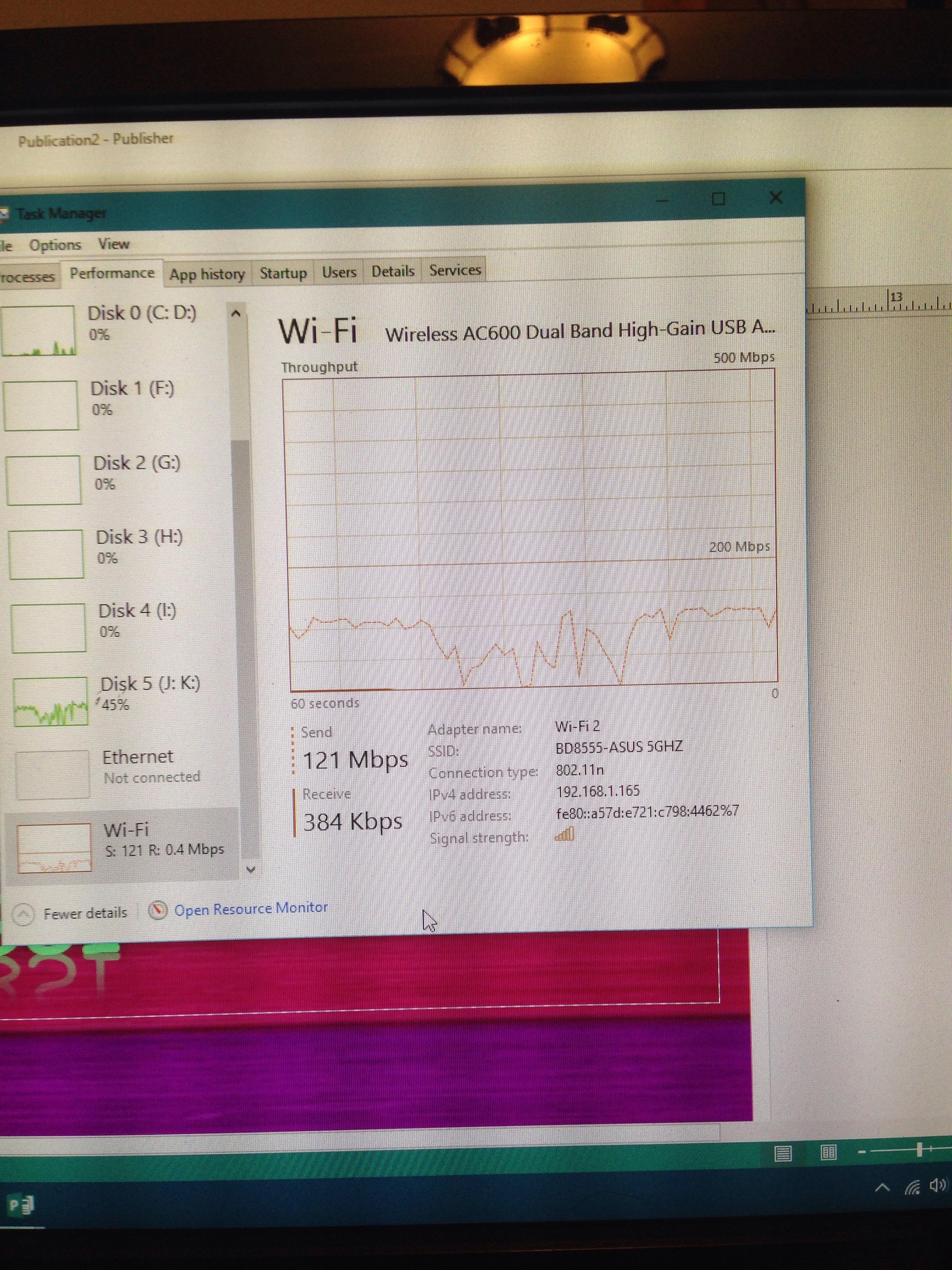

Hi, I was wondering why my network transfer speed is very slow. I'm using an Asus rt ac 68u (conected to 5ghz) but I'm getting around the speed shown in the video. It also does go down to 0 kbps too

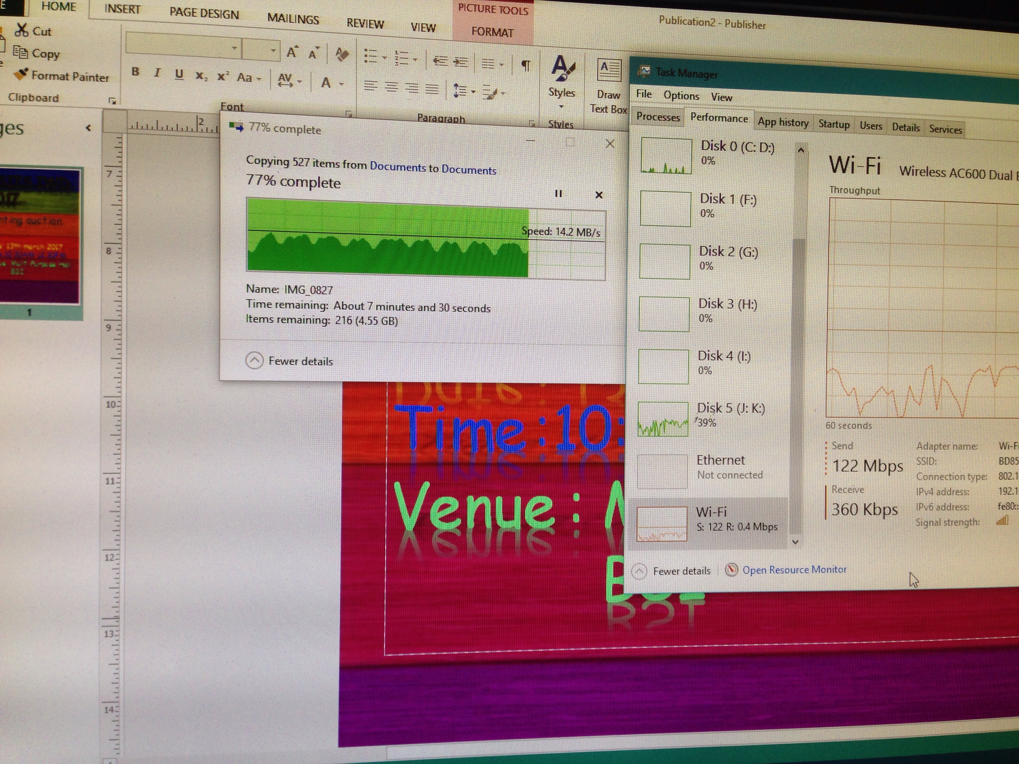

It's multiple files(files like multiple word files, music, pictures) the wifi adapter is dlink dwa 172(usb), have another client that is 2.4ghz only and have the same issue. The reason I'm using wifi is its wireless as I don't want to drill hole and I recently bought this adapter. I'm running the latest firmware for the asus rt ac 68u. No idea is the nas or the client was configured incorrectly. The dlink wifi adapter has 433mbps 5ghz speed.

It appears to work before but I didn't copy 300+gb. I probably copy less than 10gb at a time but than 300+gb file transfer is just 1 time and the test was conducted on a 2.4ghz wifi (with 5gb worth of music(this is also the same for 5ghz))enot 5ghz. 5ghz appears to bounce around but apparently doesn't go 10 mbps and below (better results than yesterday by just a reboot)

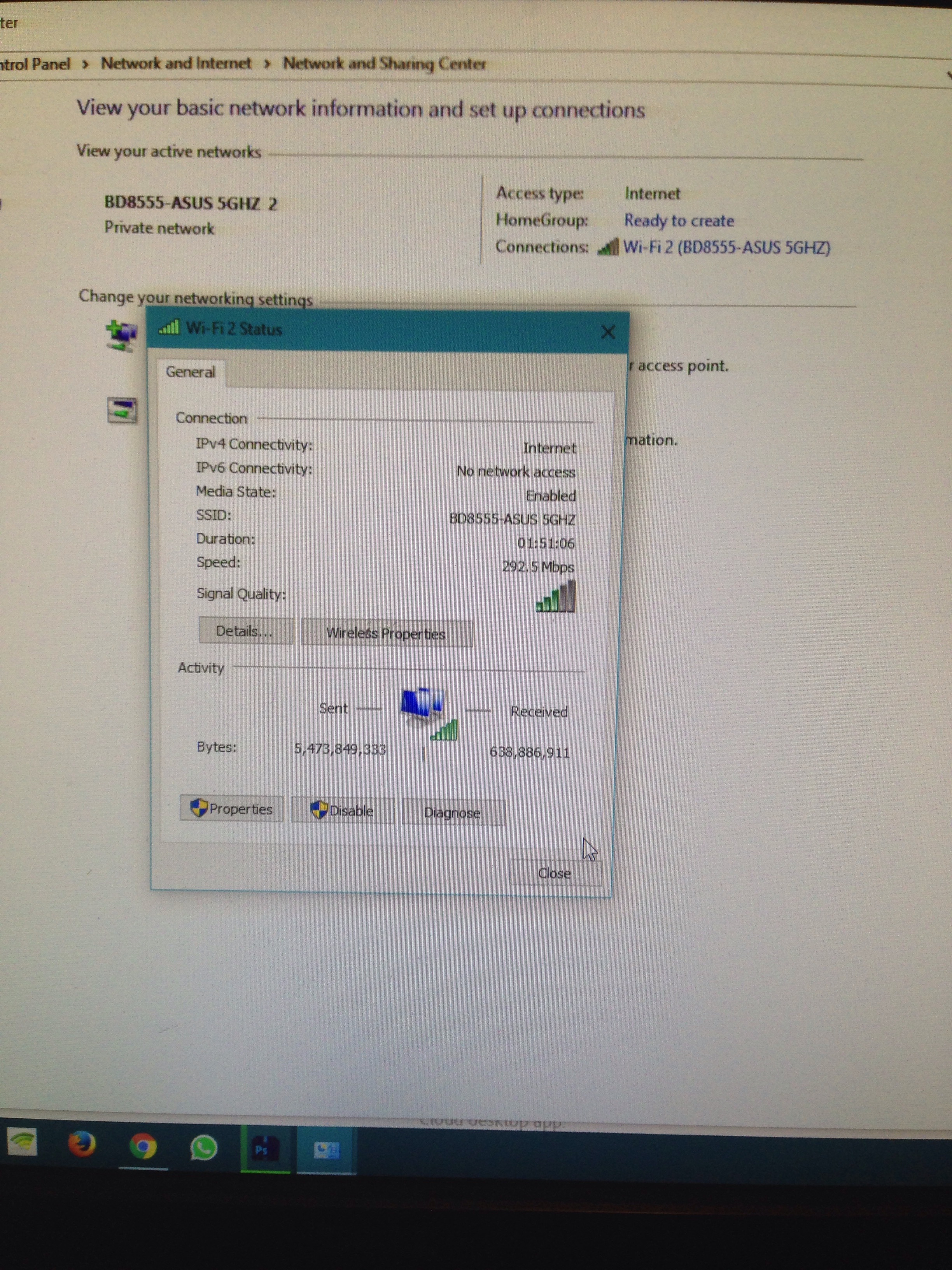

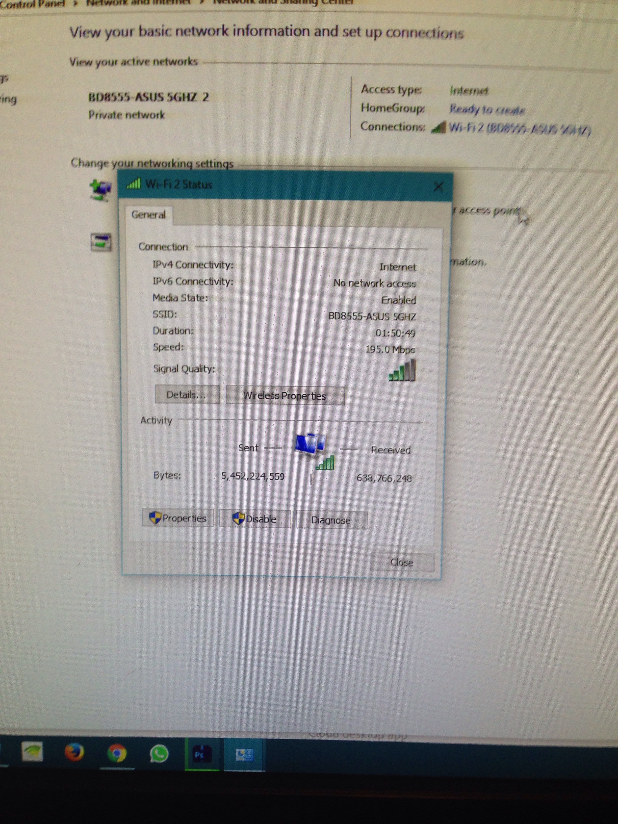

Alright it supports AC wireless. Did you check the computers Wi-Fi adapter settings? I think you can manually set which channel it uses. See if AC is an option.
Driver settings in device manager? Also I do notice on 2.4ghz on another pc with built-in wifi when the file transfer is lower than expected like below 10 mbps on 2.4ghz the ping appears to increase

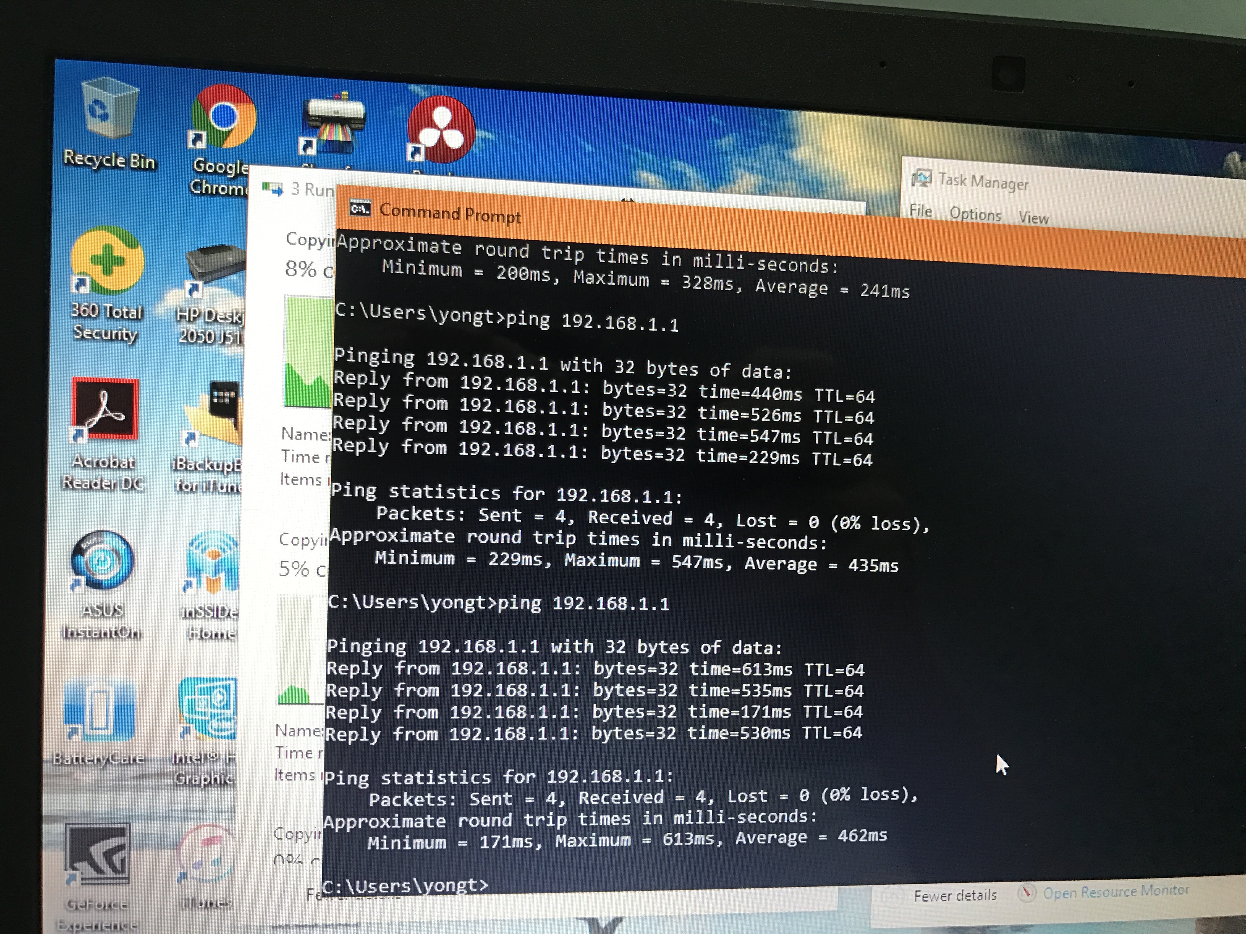

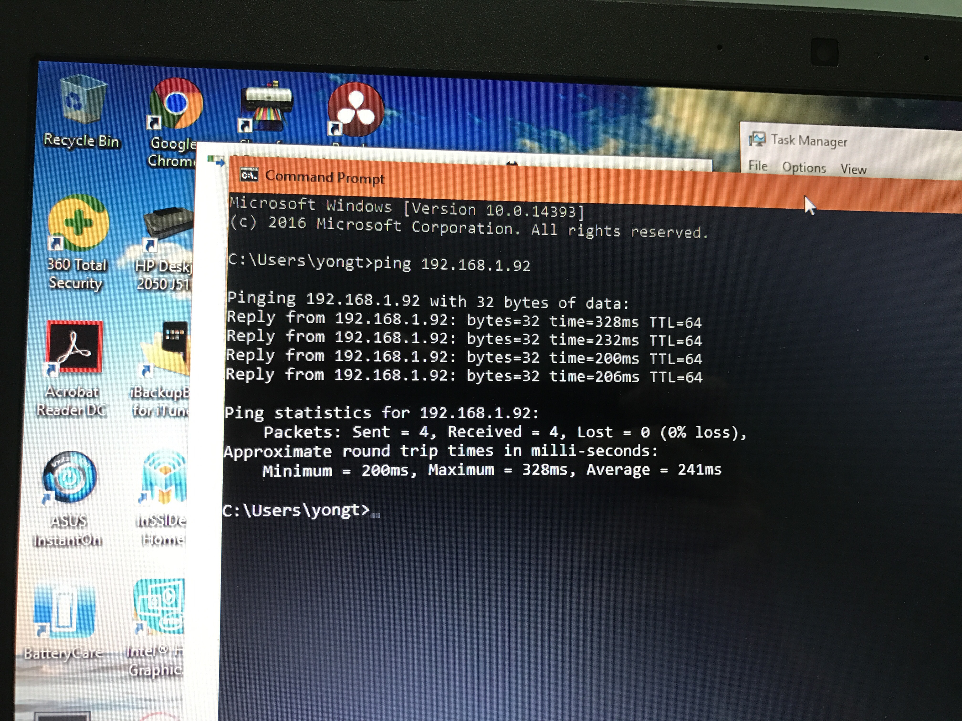

Here's the ping spike that I meant on 2.4ghz to the nas, a different pc with only 2.4ghz Qualcom adapter inside
Here's the ping to the router on 2.4ghz system
Apparently both of them have ping spike on 2.4ghz on the other end of the house and a different system for some reason.

I was mistaken there is no such setting inside the PC. What you need to do is navigate the network to your router which is most likely 192.168.1.1
After getting there login to the router and navigate to the wireless 5GHz menu. In there or under an advanced tab menu of some sort you should find a page saying what "Wireless Mode" is being advertised. On mine I have the options of A/N/A&N. I'm to assume A means AC so if you find that not enabled enable it. Or try and force the Wi-Fi to use only A/AC and see if that gets your computers Wi-Fi adapter to cooperate using AC @ 5GHz.

Wireless mode is on auto
Force it to use AC only on 5GHz and see if your computer connects to it. If it connects you'll know that your computers adapter is running 802.11ac. Then run your file transfer test again.
One other thing I can think of is see what channel it's running on. For 2.4GHz most commonly channels 1, 6, & 11 are used. The 5GHz band is diffrent numbers but follows a similar system. If you have many people around you using a channel on the 5GHz band it may cause issues for your communication. Switching channels can help correct it if this is the case. In other words it could be wireless interference.
