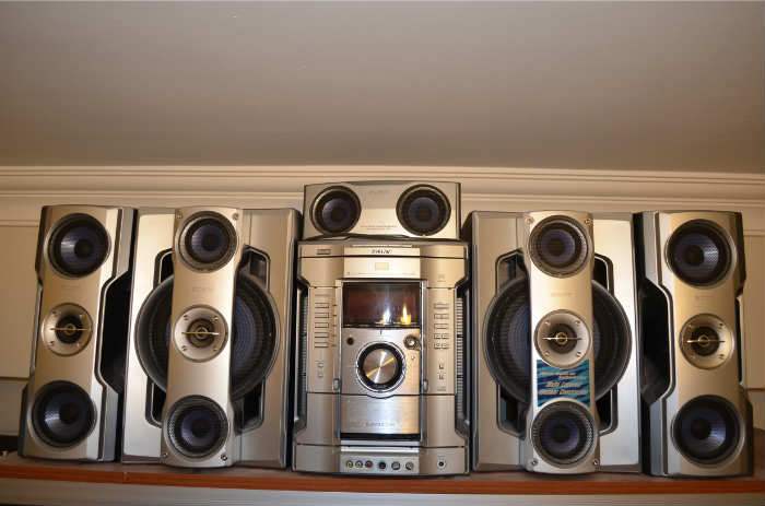

As for needing a dedicated sub, in the picture you embedded, the left-most speaker is meant as a sub. If it has a 3.5mm or RCA input you could quickly test to make sure it works properly. If it's amp is in the main unit, then make sure it's properly plugged into the sub output. If you didn't receive that speaker, then you bought a 5.0 system.

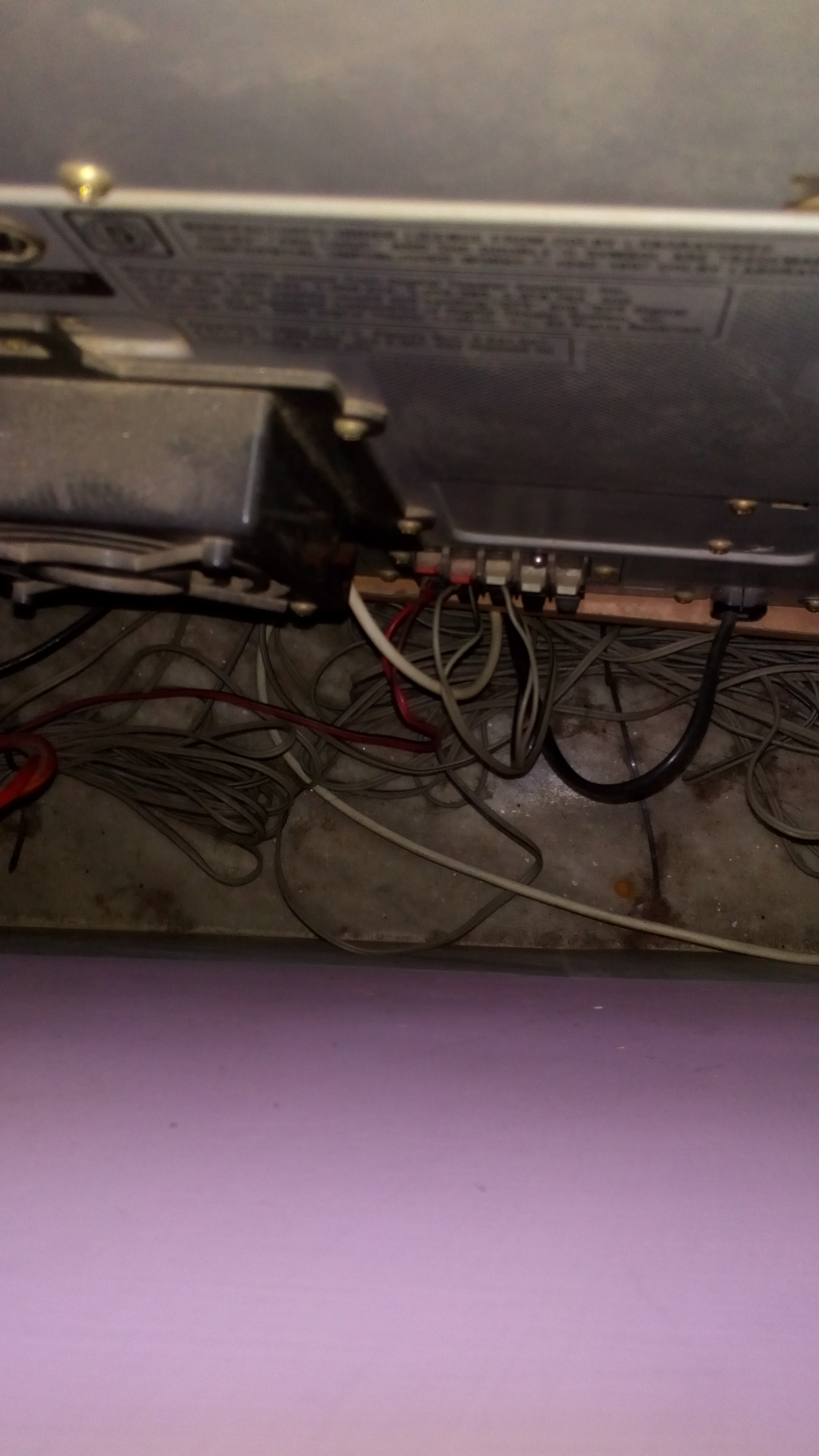

One thing more importantly to say, when I visited the techician 3 years ago to include an add-on: Chinese USB MP3 Playback system (check below images), he terminated the DVD and 3-Disc Changer system with my prior permission. Its still in but is out of service. And keeping that thing in mind, I doubt it might had caused a few problems that I'm presently facing such as getting different response other than those desired after any button (Illumination, Surround, EQ, etc.) press.

So the picture you embedded isn't what you have? you have this rather than this, can you see the difference? The second image (the one you linked) has a sub on the far left, do you not have this?
I agree the center speaker shouldn't be full range, but it may use a passive crossover in the speaker rather than using DSP in the control unit, so if you have the sub unit used as a center speaker it would compensate.

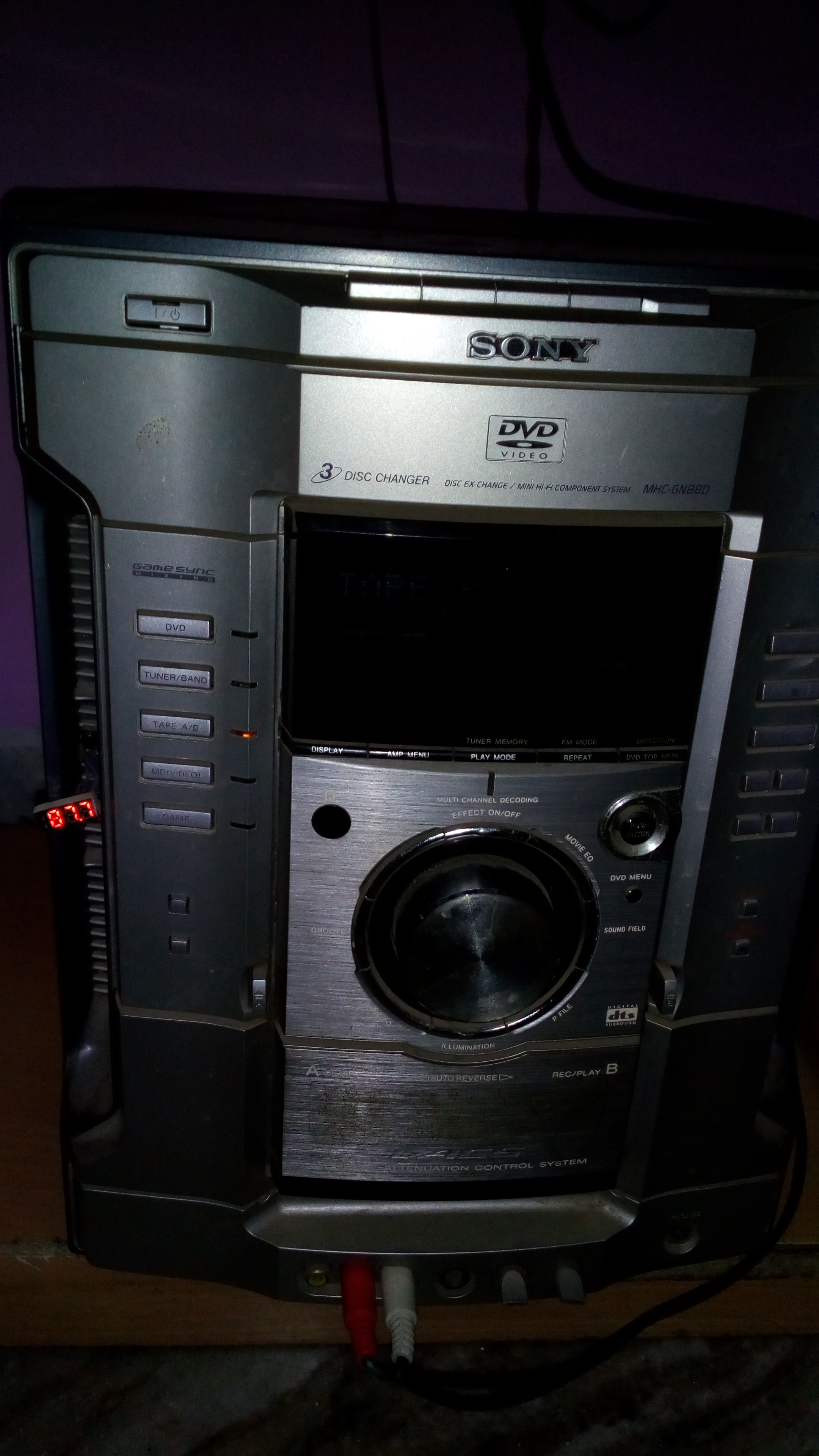

Yes, I've tried connecting both pairs of my in-ear headphones Sennheiser CX-180 Streeet II and JBL-T150, the response does get a bit better than the system speakers yet the bass suppresses the mids, highs and vocals of a song as if the it is representing a dominating behaviour (Regardless of any EQ changes, rather I always turn the EQ to Flat)! I connect via this "Phones" jack (check pic).
